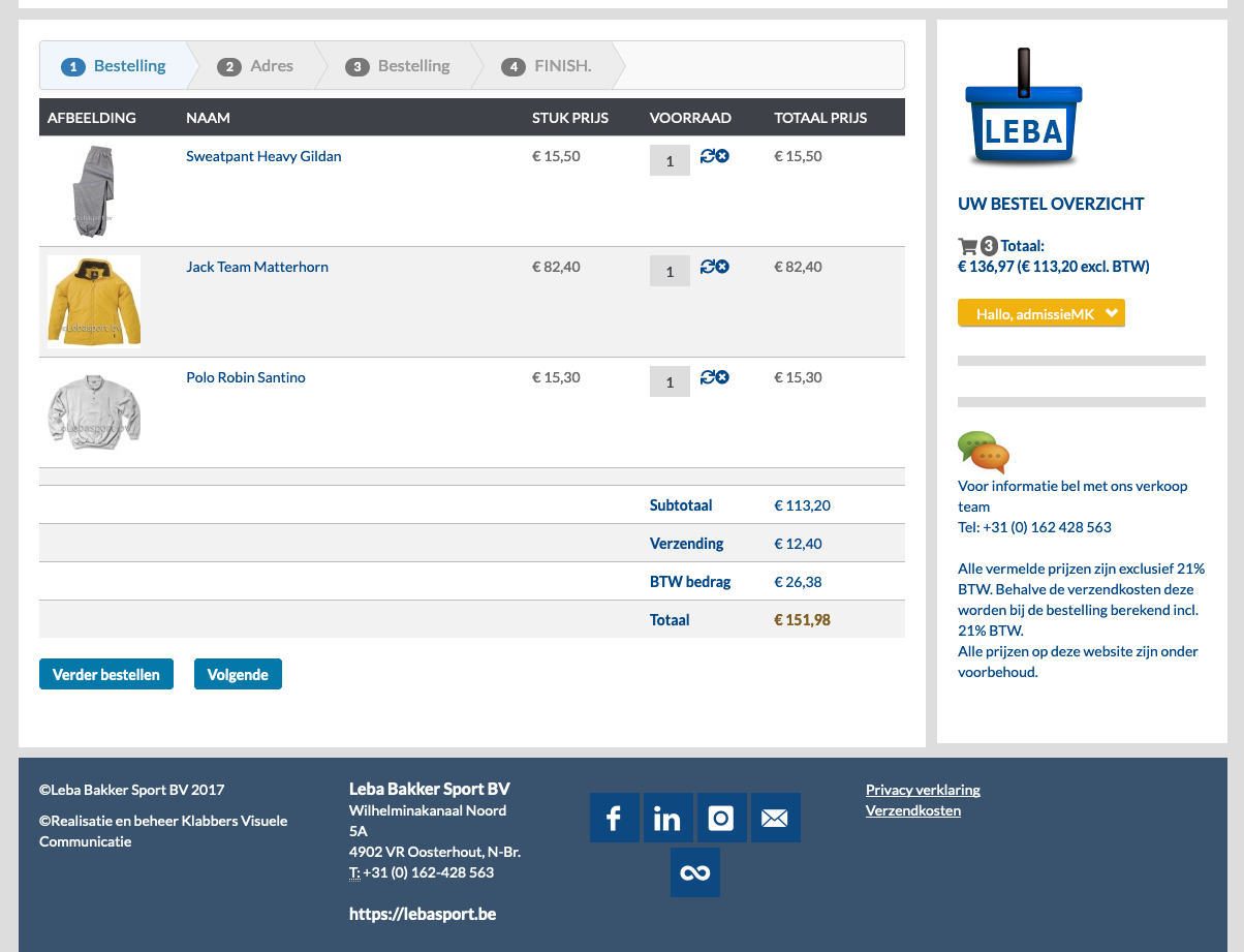

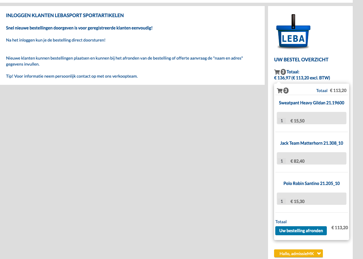

On 2 test sites the checkout doesn't move to the second step at all. Before the update Hikashop 4.1.0 ZIP from today 12 june 14:00 and 18:00 hour, both sites worked perfect in de checkout. We had never this problem. (1 local and 1 online) https://lebasport.be
The official site is not updated yet because we want receive orders.
see the attachments with the cart and shop cart step 1. We use the "cart design"
best regards,
Marius Klabers (Joomla comm. Breda NL)

  • Posts: 86112
  • Thank you received: 14210
7 years 2 months ago #307580
This looks like a different issue than what was reported on this thread.
So I'm not sure why you have that problem.
Could you provide a backend and a FTP access so that we can look into it ?
Please do so via our contact form and include a link to this thread for reference:

@mariussport :
Similarily, on lebasport.nl your "force menu on checkout" setting is set to the "Bestelling en Login" menu item which isn't either a hikashop type menu item but a Joomla article. Please try to use a HikaShop checkout menu item type for that "force a menu on checkout" setting. Now, I wasn't able to reproduce the issue on your website as you still have the 4.0.3, but I highly suspect that this is the problem.
In fact, with your feedbacks, I've noted on my end to add some warning in the HikaShop configuration for such situation.

  • Posts: 122
7 years 2 months ago #307641
Perfect now I set the "force menu to" None. The cart is working perfect till the end!
I was thinking already that way, but i was looking to "continue shopping URL" but that was nearly!
Thank you for the quick answer.
best regards, Marius
