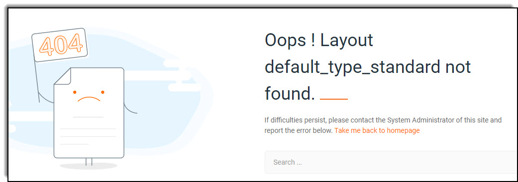

URGENT REQUEST- SITE IS DOWN: Very tight timeline on new web site for customer.
New site using Joomla 3.9.8 and Joomlashine JSN Mall 1.0 template. Everything was working fine until installing HikaShop Business 4.1.0 and now getting 404 Error Layout default_type_standard not found when trying to access the front-end of the site.
Template - Joomlashine JSN Mall
Plugins - Akeeba Backup Pro & Akeeba Admin Tools Pro
Is HikaShop compatible with the Sun Framework used by Joomlashine?
Thanks in advance for your assistance!

HikaShop is supposed to work with any template.
And that "default type standard" layout isn't from HikaShop.
So I'm not sure your issue is related to the install of HikaShop.
Try to disable HikaShop via the Extensions->Mange->Manage menu of Joomla. If you still have the error after that, then it's not linked to the install of HikaShop.
Also, before you access that page, activate debug mode and error reporting settings of the Joomla configuration. It should display more information on where the error is coming from which will help us/you understand which extension is involved in the issue and which file. That will help in fixing the problem.

While setting up a test environment with the template on our end to try to reproduce the issue is possible, it could take a while as we don't have a copy of that template. So we'll first have to request it from JSN. And that doesn't mean we'll be able to reproduce it as something else might be at play here, especially since we don't have the layout mentioned in the error message in the code of HikaShop and thus it can't come from the code in HikaShop.
That's why I suggested an access to your website in order to rapidely look into it. That's the fastest way to go about it, actually.
I've requested a copy of the template, so we'll see, but there is a high chance that I won't be able to reproduce the problem.
What you could try in the mean time is to rename the folder templates/YOUR_TEMPLATE/html/com_hikashop/ via FTP to something else. That will deactivate the overrides of HikaShop from your template and it should hopefully fix the problem.
