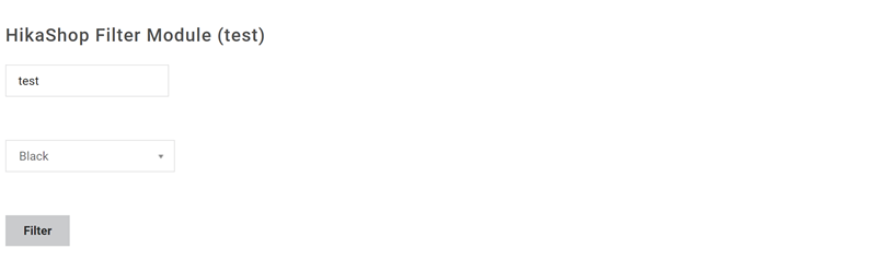

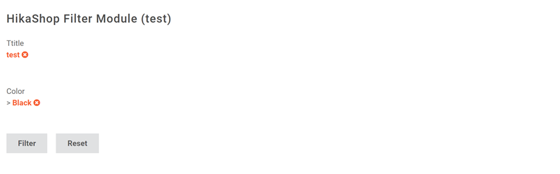

  • Posts: 141
6 years 10 months ago #308940
Hi, Yes, I know that Reset Button should appear after Filter is set. Please find enclosed screenshots from test page how it looks in Hikashop 4.1 (image 1) and how it looks in Hikashop 4.2 (image 2) after Filter is set (selection confirmed by using button Filter).
You can see test page here: test page
Greg

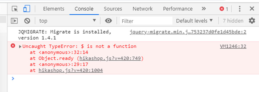

  • Posts: 141
6 years 10 months ago #309123
Hi, yes, this is this line
you can see test site here
before deletion of the line in filter.php I see following error in console:
after deletion of the line in filter.php there is no errors in console
Greg
  • Posts: 1119
  • Thank you received: 114
6 years 10 months ago #309133
Try changing this:
window.hikashop.ready(function($) {
// init Isotope
 var $grid = $('.masonry-grid').isotope({
to this:
window.hikashop.ready(function() {
// init Isotope
 var $grid = jQuery('.masonry-grid').isotope({
And that should fix your issue.

  • Posts: 141
6 years 10 months ago #309135
Hi, thanks ! masonry layout now is working without any changes in filter.php - with no errors in console !
