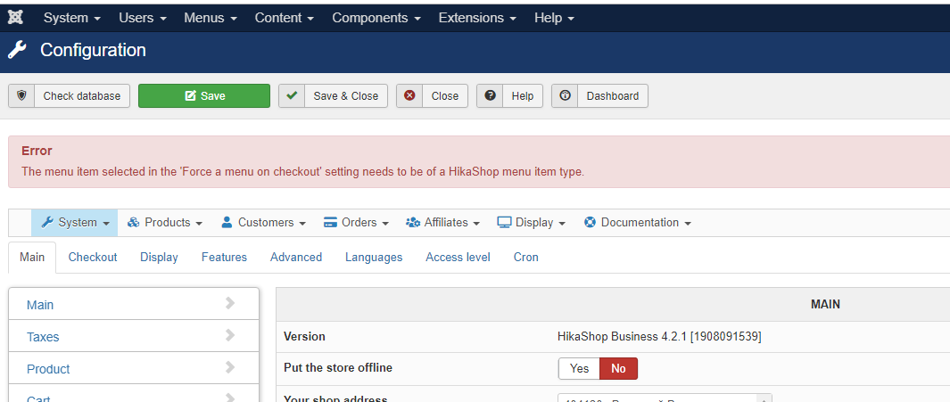

-- HikaShop version -- : 4.2.1
-- Joomla version -- : 3.9.11
-- PHP version -- : 7.1.21
-- Browser(s) name and version -- : Google Chrome 76.0.3809.100
-- Error-message(debug-mod must be tuned on) -- : The menu item selected in the 'Force a menu on checkout' setting needs to be of a HikaShop menu item type.
Hello!
After updating Hikashop to version 4.2.1, I get an error when I go to Hikashop / Config.
What to do?
Thank you in advance.
  • Posts: 85727
  • Thank you received: 14055
6 years 9 months ago #309932
This is an extra check we've added as normally you want to either leave that "force menu on checkout" setting empty or configure a menu item of the type hikashop checkout in it, or at least of a hikashop type. Otherwise, you risk getting a 404 error when accessing the HikaShop checkout.
So I would recommend to review that setting.
  • Posts: 133
  • Thank you received: 21
6 years 9 months ago #309946
I have this setting translated as "Joomla menu item when placing an order", so I did not immediately find this setting, now I’ve fixed everything.
Thank you very much, Nicholas.
