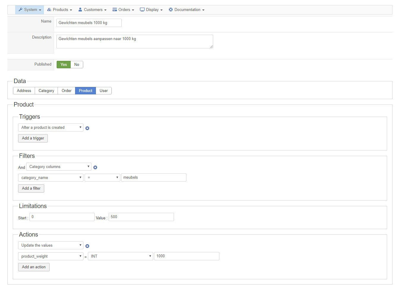

I have create a simple massaction to add weight to a product
and it's working when we process is manualy.
But when we use the triggers below none of them is working:
- before a product is create
- before a product is update
- after a product is create
- after a product is update
Is this an bug or do I something wrong?

  • Posts: 627
  • Thank you received: 25
6 years 9 months ago #310272
I found out that the category_name is Casesensitive.
When I use "meubels" it give 32 results, what's correct, but with the name "Meubels" it give also 32 results.
But because the Category name is with a Capital it's only working with this version.
So it's strange that it give 32 results on the name without capital and also worked when we processed the action manualy.
These two reasons let me thing that the mass action was correct. But thanks for the tip to use the exact same name.

6 years 9 months ago #310273
Ah yes. When you click on the "process" button (or with the preview of the number of results of the filter), the filters are run with a MySQL query on all the products in the shop. However, when the mass action is run through triggers, the filters are run in PHP directly on the data sent by the trigger.
And with the MySQL query, the comparisons are done case insensitive (it's usually the case in MySQL databases to configure the tables to be searchable that way).
However, with the PHP check, it's done with a case sensitive check.
Changing the way the MySQL check is done won't be practical / easy and I don't think we want to change the PHP check to make it case insensitive. So I don't think we'll change the way it's done for now, but I agree that it's a bit misleading in cases such as yours.
