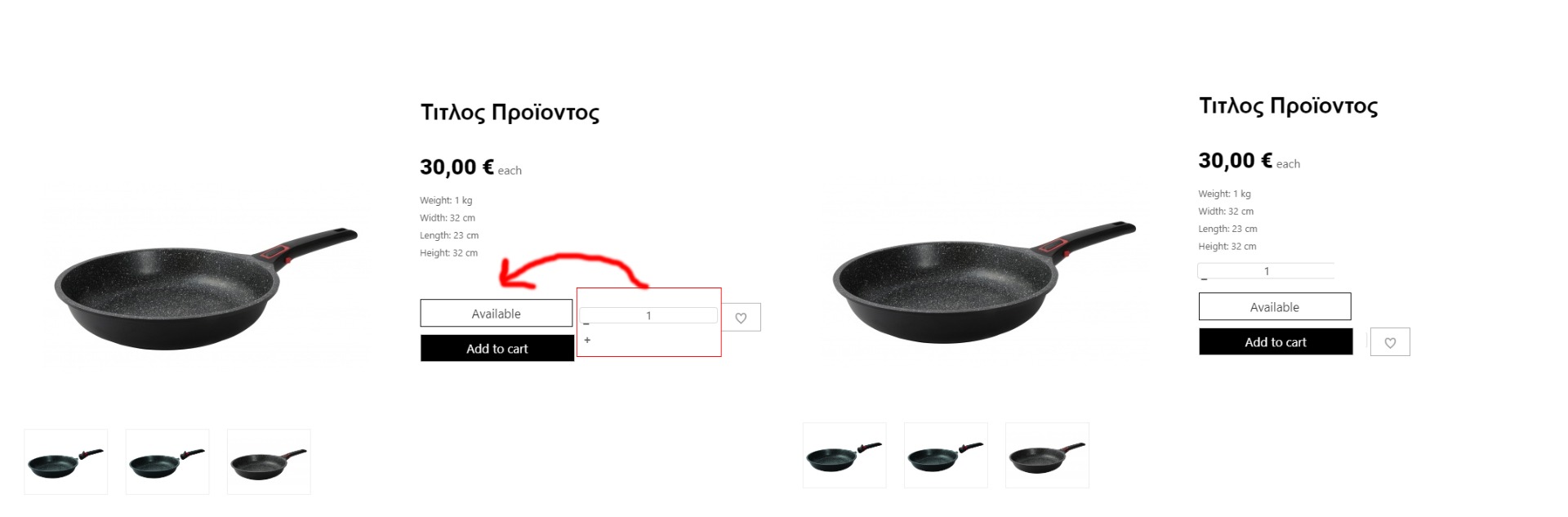

I'd like to move the quantity button in above from avalibility button!
Really i cant found the code!! Can you please tell me which is the code file and what is the code line that i have have to move??
Thank you in advance!!
I have attached a picture what i need to do!!
  • Posts: 86112
  • Thank you received: 14210
6 years 11 months ago #310793
If you turn on temporarily the "Display view files" setting of the HikaShop configuration, you'll see exactly which view file is used to display which area. Then, you can just edit the view file via the menu Display>Views.
For the quantity input field, that's likely the file "quantity.php" of the view "layouts" that you want to edit.
Note that the quantity input field can be displayed in different ways thanks to the "Quantity input method" setting of the HikaShop configuration.
I would first recommend to choose the display method you want for it in that setting, before customizing its HTML in the view file. That should save you some time.
