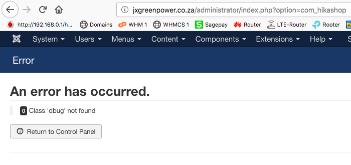

I upgraded to the latest Hikashop and when I click on Hikashop this is the error I am getting:
An error has occurred.
0 Class 'dbug' not found
Return to Control Panel
I am able to access everything else except the Front Page of Hikashop.
6 years 11 months ago #311866
I would recommend to activate first the "error reporting" and "debug mode" settings of the Joomla configuration.
That will then display an error message on that blank page which will help us (and you better) understand what's going on and provide a solution.
Kind regards,
Mohamed Thelji.

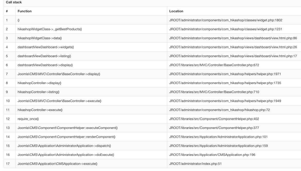

I did as you suggested and this is what I get :
/home/synncomw/public_html/administrator/components/com_hikashop/classes/widget.php:1802
Call stack
# Function Location
1 () JROOT/administrator/components/com_hikashop/classes/widget.php:1802
2 hikashopWidgetClass->_getBestProducts() JROOT/administrator/components/com_hikashop/classes/widget.php:1231
3 hikashopWidgetClass->data() JROOT/administrator/components/com_hikashop/views/dashboard/view.html.php:86
4 dashboardViewDashboard->widgets() JROOT/administrator/components/com_hikashop/views/dashboard/view.html.php:26
5 dashboardViewDashboard->listing() JROOT/administrator/components/com_hikashop/views/dashboard/view.html.php:17
6 dashboardViewDashboard->display() JROOT/libraries/src/MVC/Controller/BaseController.php:672
7 Joomla\CMS\MVC\Controller\BaseController->display() JROOT/administrator/components/com_hikashop/helpers/helper.php:1971
8 hikashopController->display() JROOT/administrator/components/com_hikashop/helpers/helper.php:1735
9 hikashopController->listing() JROOT/libraries/src/MVC/Controller/BaseController.php:710
10 Joomla\CMS\MVC\Controller\BaseController->execute() JROOT/administrator/components/com_hikashop/helpers/helper.php:1949
11 hikashopController->execute() JROOT/administrator/components/com_hikashop/hikashop.php:72
12 require_once() JROOT/libraries/src/Component/ComponentHelper.php:402
13 Joomla\CMS\Component\ComponentHelper::executeComponent() JROOT/libraries/src/Component/ComponentHelper.php:377
14 Joomla\CMS\Component\ComponentHelper::renderComponent() JROOT/libraries/src/Application/AdministratorApplication.php:101
15 Joomla\CMS\Application\AdministratorApplication->dispatch() JROOT/libraries/src/Application/AdministratorApplication.php:159
16 Joomla\CMS\Application\AdministratorApplication->doExecute() JROOT/libraries/src/Application/CMSApplication.php:196
17 Joomla\CMS\Application\CMSApplication->execute() JROOT/administrator/index.php:51
6 years 11 months ago #311885
We just fixed that issue, so you'll just have to download the last Hikashop version through our website, install it and test it again.
Thank you for your feedback.
Kind regards,
Mohamed Thelji
