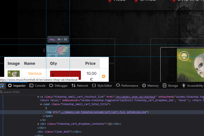

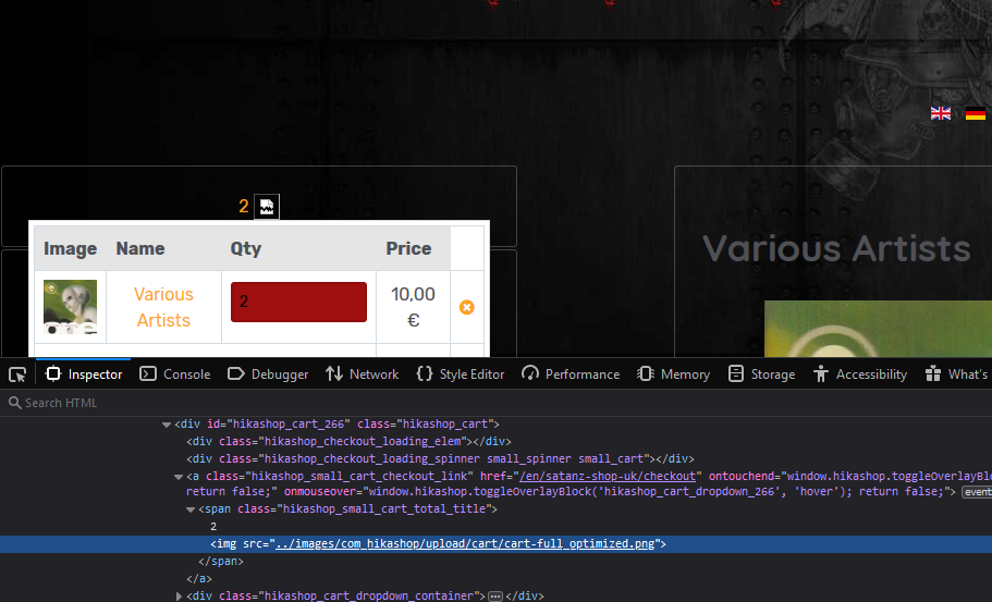

But I now notice that if i go to the product view the image is lost? If I check its path with the developer tools its path stays the same.

Added some screenshots so you can see the path stays the same.

If you right click on the image link in your browser inspector and then open it on a new tab, you'll see that the URL becomes
https://www.musicfromhell.nl/en/satanz-shop-uk/images/com_hikashop/upload/cart/cart-full_optimized.png
As you can see, the problem is that en/satanz-shop-uk is added between the website main URL and the relative URL of your image.
The fact that the URL is changed in the img tag is probably because of the system SEF plugin where there is an option to modify the URLs on the fly.
Also, you might want to try to do your translation override like this:
X_ITEM_FOR_X="%s <img src='/images/com_hikashop/upload/cart/cart-full-test.png'/>"

I have removed the .. in front of my image link as you suggested and until now (need some more testing) all works as supposed to.
So thanks for that suggestion, I only put .. in front because on my testserver it wont work without the .. so my live server its some what different, good to know.
