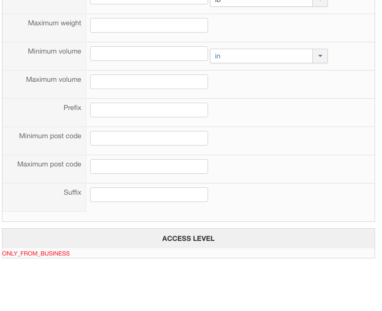

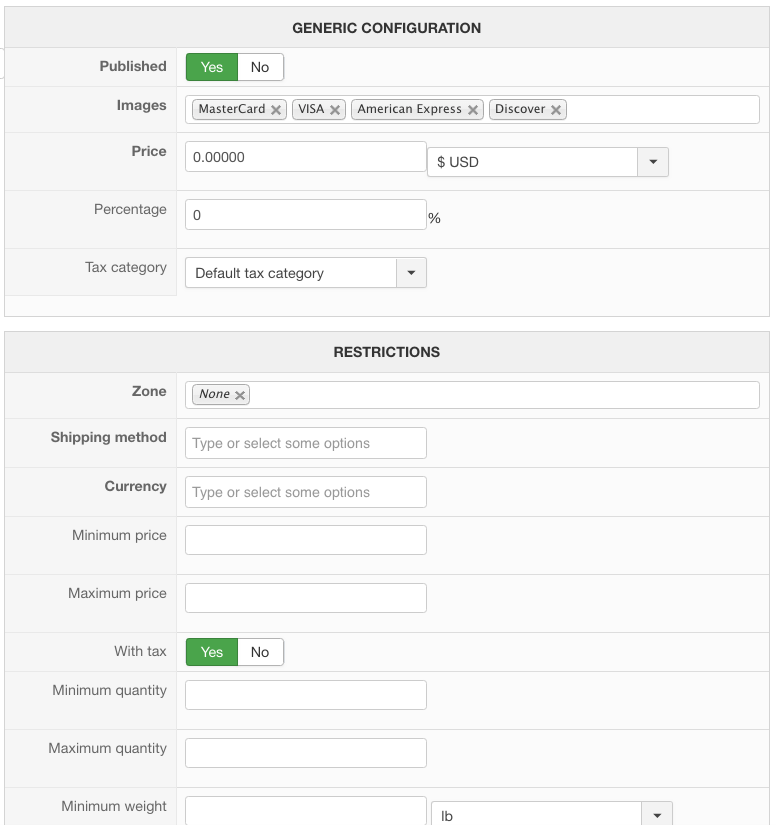

  • Posts: 109
6 years 5 months ago #317321
We have had a custom payment plugin made to work with Payroc — see attached.
  • Posts: 86112
  • Thank you received: 14210
6 years 5 months ago #317330
Well, you need to modify the code of that plugin to handle the return like you want.
I can't say how though as I don't know how that plugin was written.
