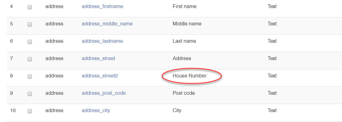

For your information we use the address_street2 for the house number. So clients can't forget to fill in the house number.
Therefore you gave us a custom code (myparcel.php) to add the number after the address_street like this:

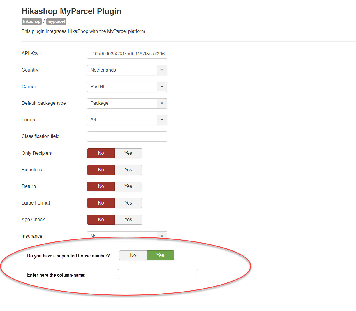

I think more people could have this issue so it would be nice if you can have an option in the
backend from the plug-in where you can set Column name for the house number if you have this separated from the column address_street.
Like this:

About the separated house number.
I understand your side of the story. But I still think that it can be interesting for many shop owners to have a separate house number field as option because it is sometimes forgotten by customers and it takes time and money to correct it.
Anyway:
You are right that address_street2 should not be used because you already use it for the street additional info.
So I made a new custom field address_house_number to solve this problem and change all my custom codes.
Hopefully this will cause less problems and less code changes in the future. But I'm afraid I have to give it up completely if I ever want to use the google geocoding shipping plugin. But that's a concern for later when the small problems with that plugin are solved.

This has been added a few months back.
If you already have the MyParcel plugin installed, you can download its latest version install package via the same link you first got it from.
Then, install it via the Joomla extensions installer.
Finally, go in the settings of the plugin in the joomla plugins manager and you'll find a new setting "House number field" where you can enter the column name of the custom field you're using to collect the house number.
