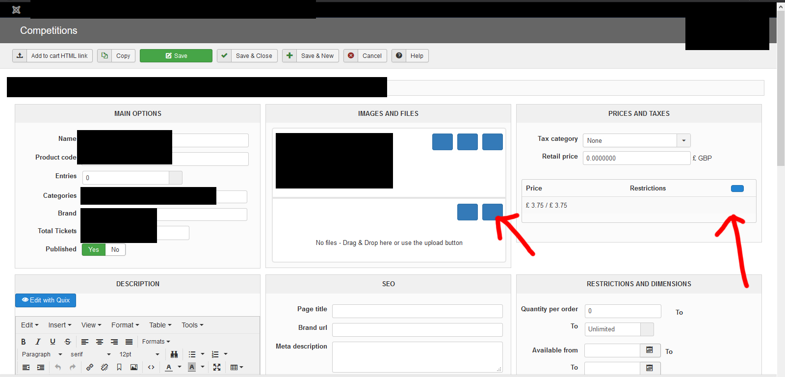

Hi guys I have a MAJOR issue, for some reason there is some kind of incompatibility issue with something on my clients site that has caused all admin button icons to vanish and some editable buttons to completely disappear. I think there is some kind of JQuery/Bootstrap issue or something of that nature but my client cannot use the site!
Please see screenshot attached!

Saw a similar post yesterday i think, can't find it. Something is blocking HikaShop's "FontAwesome" library from loading which is reponsible for the icons.

That's an issue with the library font-awesome which is used by HikaShop for its icons.
We would need a backend access in order to check the situation, to be able to say what to do.

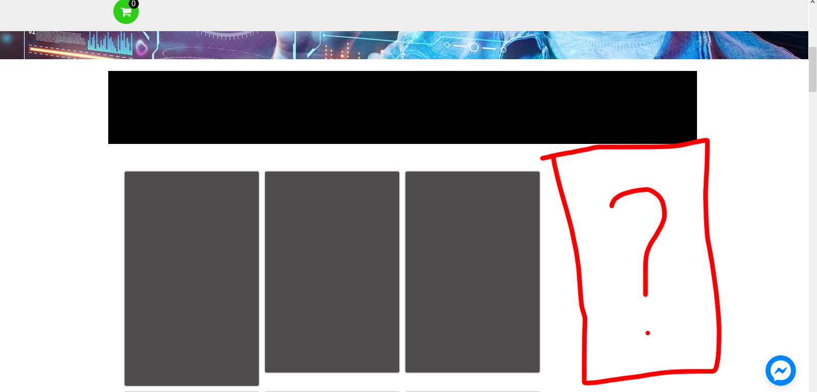

While we are at it does anyone know why the HIkashop content display module doesn't align content centre on a page, it has some random large margin to the right?

The backend access you provided didn't work. Please double check it.
Regarding your issue with the column width, I checked your frontend, and you apparently have view overrides in your template based on old versions of HikaShop. That's what's causing the issue.
If you rename the folder templates/YOUR_TEMPLATE/html/com_hikashop/product/ via FTP it should fix the problem. Now you'll loose the customizations you had for your products, so you want to keep that folder, and then rename the files in it one by one to identify the one causing the issue.

6 years 4 months ago #318620
The access is now working.
From what I can see, HikaShop is not loading font-awesome at all on your backend.
This indicates that either you (or someone else with access to your backend) modified the PHP code of HikaShop to not load font-awesome (in that case, reinstalling the Hikashop install package on your website will solve the issue), or you've added an entry with the namekey "font-awesome" or "font-awesome-type" in the hikashop_config table via your phpmyadmin with a value which removes the font-awesome library from your backend.

6 years 4 months ago #318629
Ok the issue is my template is loading FA4.7 but Hikashop is using latest FA5.2, the conflict is causing the loading issue of the library and this is in turn effecting everything on my site using the FA library including the backend, THAT is the issue here. I need to somehow work our how to override the template loading FA4.7 and just use Hikashops FA5.0 library.
FA 5.0:
/media/com_hikashop/css/font-awesome.css?v=5.2.0
FA 4.7.0:
/templates/jd_shop/css/font-awesome.min.css
Last edit: 6 years 4 months ago by ImageVillage.
  • Posts: 86112
  • Thank you received: 14210
6 years 4 months ago #318640
Well, this doesn't explain why the font-awesome library is not loaded in the backend.
Even with a conflict with the template, it should only mess the icons on the frontend.
So I can only suppose that something has been modified to remove font-awesome from HikaShop.
I would recommend to revert that, and instead, to add an entry with the namekey font-awesome-type and the value admin in the hikashop_config table. That way, font-awesome will only be loaded by HikaShop in the backend and not in the frontend, avoiding the conflict with your template.
