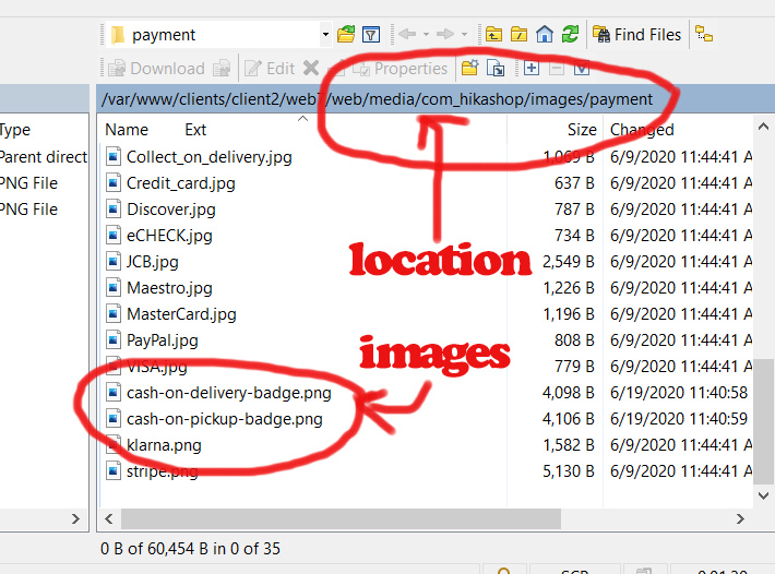

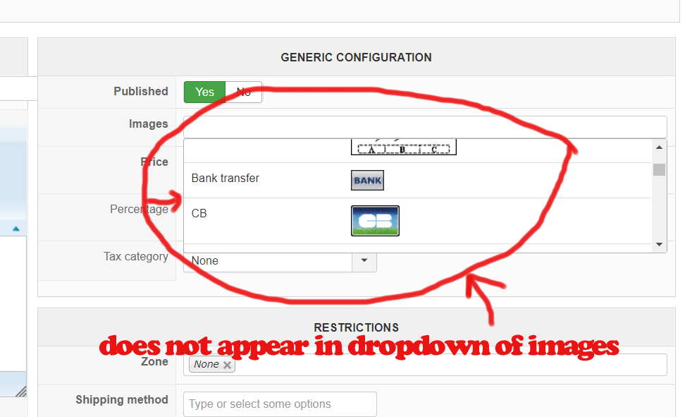

#5 (added) I added some new badges (right size n x 13pixels) for payment/shipping in /media/com_hikashop/images/shipping and /media/com_hikashop/images/payment but they don't appear in the dropdown list of badges. How can I make it appear as part of badges.

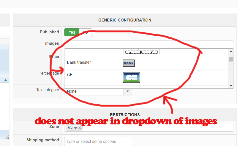

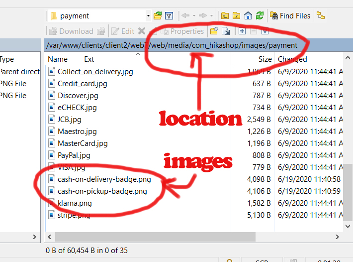

5 years 11 months ago #321043
Here are the images. One is showing the dropdown and the other images uploaded.

5 years 11 months ago #321134
If I have a look on your screenshot, I don't understand your Url where you should have your pictures, from our mind your image have to be here in this folder :
YourWebsite\media\com_hikashop\images\payment
Hope this will help you to achieved what you needs.
