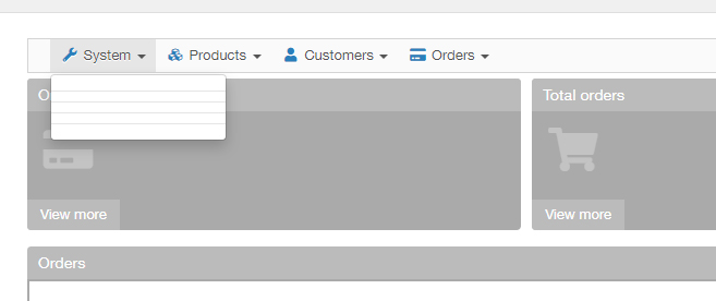

Hello, I need to hide the System menu from a group of users, but even when is empty, is still visible in the menu.
How can I hide it?
thank you

  • Posts: 23
5 years 11 months ago #321060
The dropdown is unavailable but the item "System" is still visible.

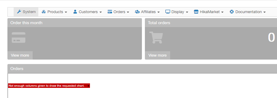

  • Posts: 85727
  • Thank you received: 14054
5 years 11 months ago #321087
I did a test with my own website on local with that patch and it works fine:
monosnap.com/file/aW0yG3jvGCDSGjrri0sqemhaPp5syb
So I can only think that the current user you're using still have access to the HikaShop configuration.
Please check your ACLs.

  • Posts: 23
5 years 11 months ago #321147
Yes, it works, I only have the view disabled but is necessary disable the manage, after that its works fine.
Thank you
