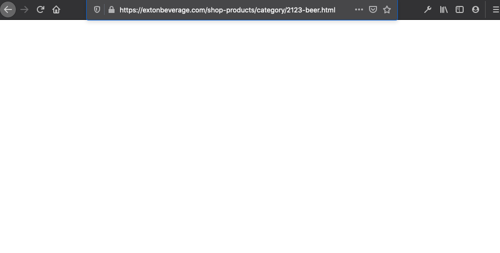

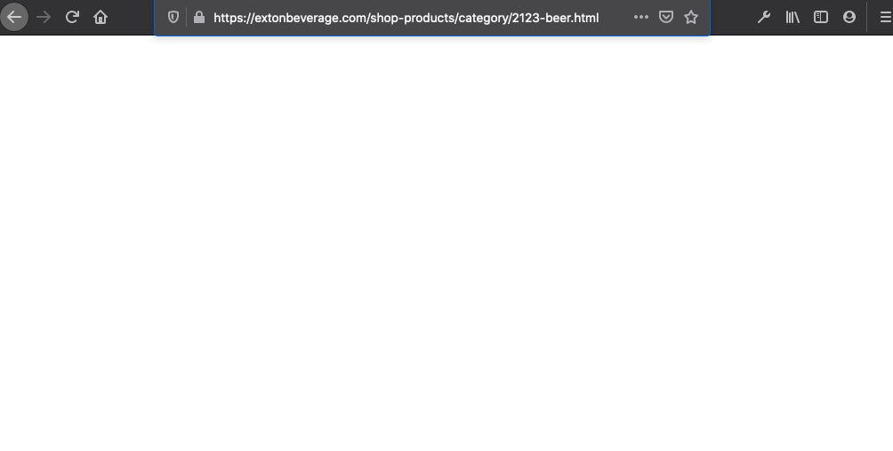

I noticed that a product category on the front of the site was not displaying correctly, all 404 and 500 errors for page resources, but other product category pages were fine. See below.
Problem - Beer
No Problem - Soda
I temporarily fixed it by clearing the products and re importing them from scratch.
Today I look again and the problem is back.
I've searched throughout this forum and can not find a solution. This is fairly time sensitive since it is our primary product line. Thanks for your help!

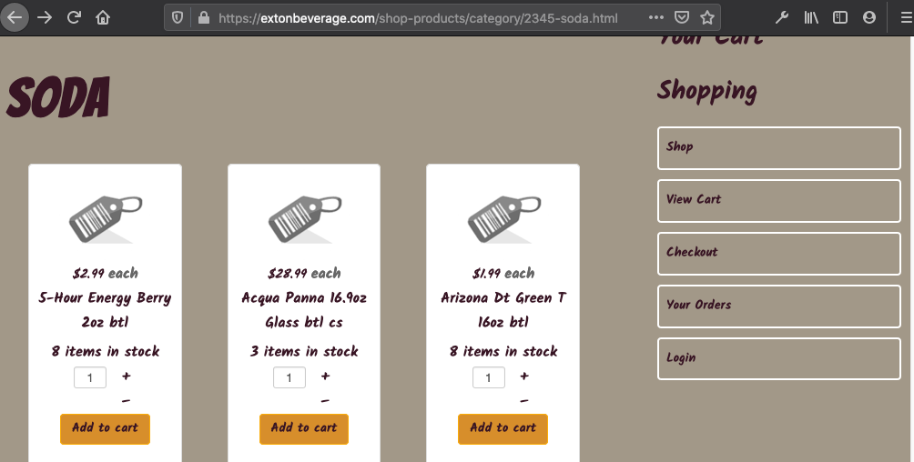

Here is a category that is functioning properly: extonbeverage.com/shop-products/category/2345-soda.html
Here is the problem category: extonbeverage.com/shop-products/category/2123-beer.html
The first displays correctly, the second white screens. The error reads as provided above, 500 and 404s.
I've attempted to remove and add canonical urls, but there is no effect.

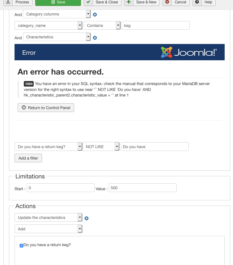

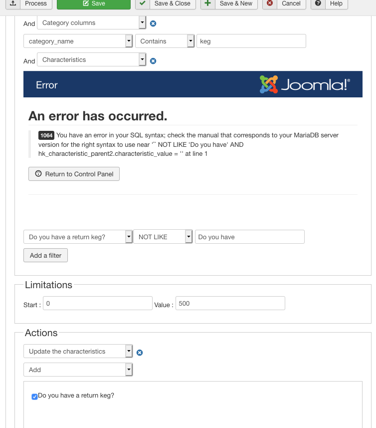

The problem appears to be that the Mass Actions I have set to update certain products characteristics and add in the variants, is the challenge. Every time it runs it adds in the new variants, the count is up to 16 per product needing the options, at 100+ products needing the options, that adds up quickly.
Is there a way to keep that mass action from running on products that already have the characteristic variants? Joomla errors when I attempt to add a filter for the characteristic, see screenshot.
  • Posts: 85727
  • Thank you received: 14054
5 years 11 months ago #321859
This error is just for the refreshing of the number of elements matching the filter. I think you can ignore it.
But we've added a patch on our end for that.
Download again the install package of the latest version of HikaShop on our website and install it on yours and it will add the patch for that issue.
