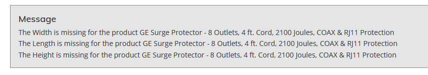

Sorry! I set it to NOT use dimensions, because I want it to only be weight based, and I am still getting an error about missing weights.
Is this another setting I need to change somewhere?

5 years 10 months ago #322230
Where do you have that message ?
The CanadaPost plugin do not add such kind of message, so we need to understand where/how you have it to understand the source.

Well, when I test the shipping plugin on the front end, with it set to weight base and dimensions set to no, it tells me no shipping method is found.
Since I don't know the inner workings of your plugin, I was kind of hoping you'd be able to tell ME why that was happening?

I'm actually having the following error message when I try to use the credentials you sent us :
Username and password do not match or you do not have an account yet.
Also, regarding the error message you are having, did you actually tried to set temporary dimensions like 1x1x1 to that product to prevent that issue from happening ? If the "Use dimension" option is set to NO, that shouldn't be a problem.

Use dimensions is set to no. I will check credentials and send to you.
I don't really want to have to set dimensions for hundreds of products just to get this to work, so please take a look and advise.
