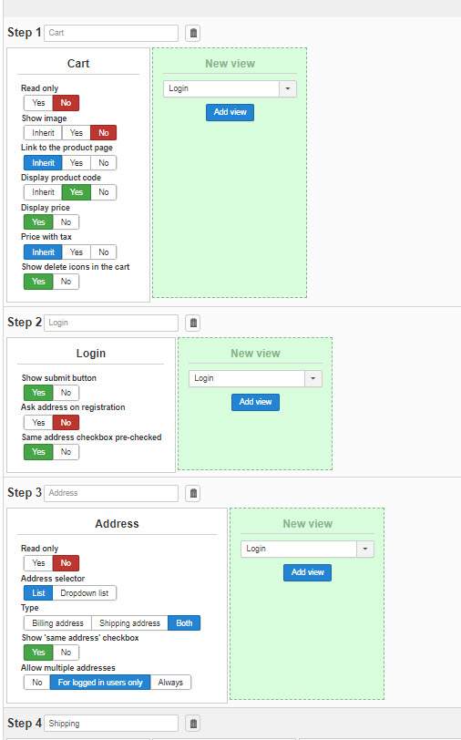

5 years 11 months ago #324664
Attached a screenshot of the configuration.
We looked at the problem extensively with a customer, but nothing remarkable came out.
The only similarity we see now is that customers all seem to be from Germany. But if I test myself with a German address, it just works fine.
Hopefully you can help us further.

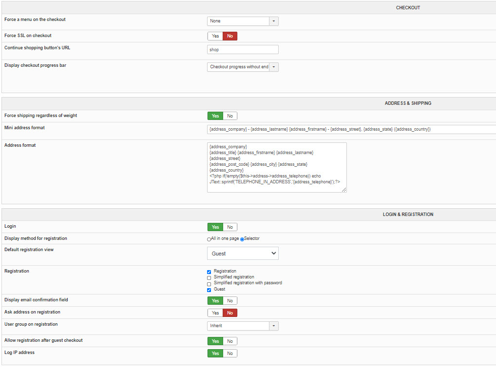

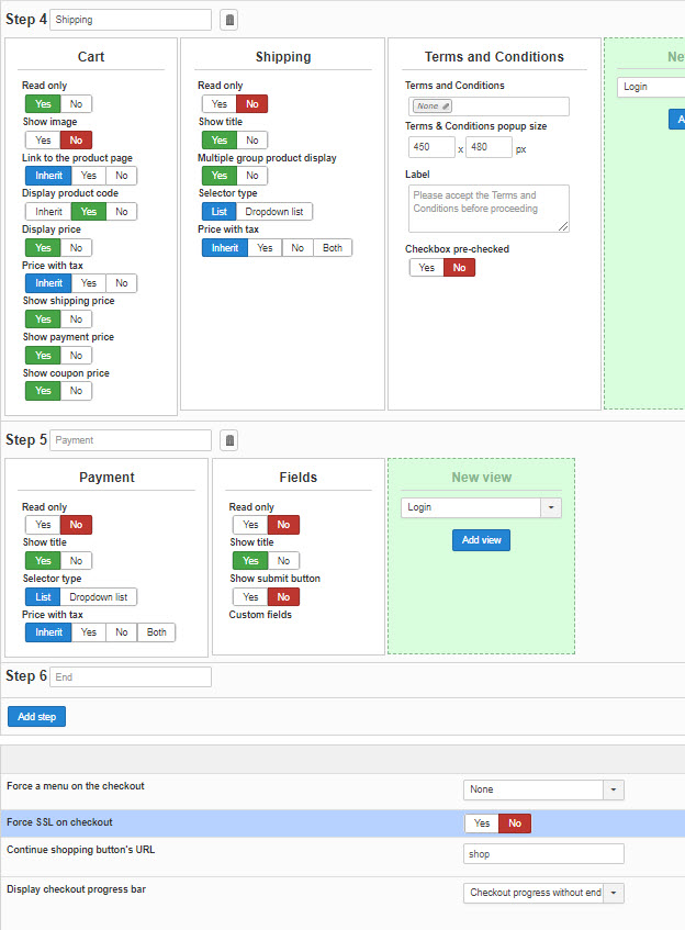

  • Posts: 72
  • Thank you received: 5
5 years 10 months ago #324766
The screenshots.
