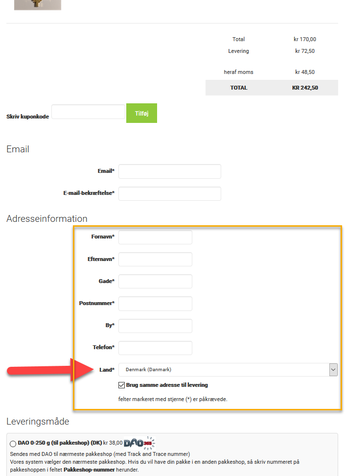

When I change the country for the buyer, the shipping options do not change accordigly.
I have most shipping options set for Denmark only and some for the rest of the world.
When selecting another country than the default (Denmark) alle the Denmark shipping options are still available

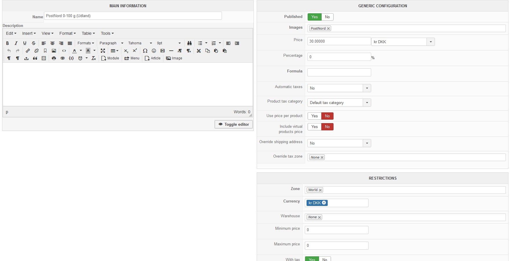

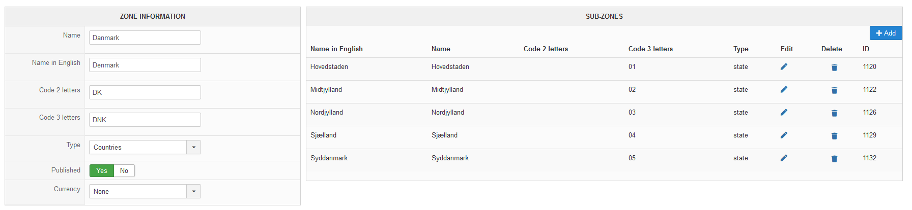

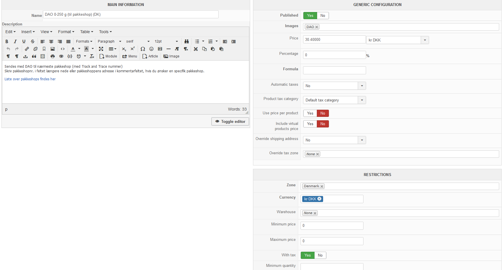

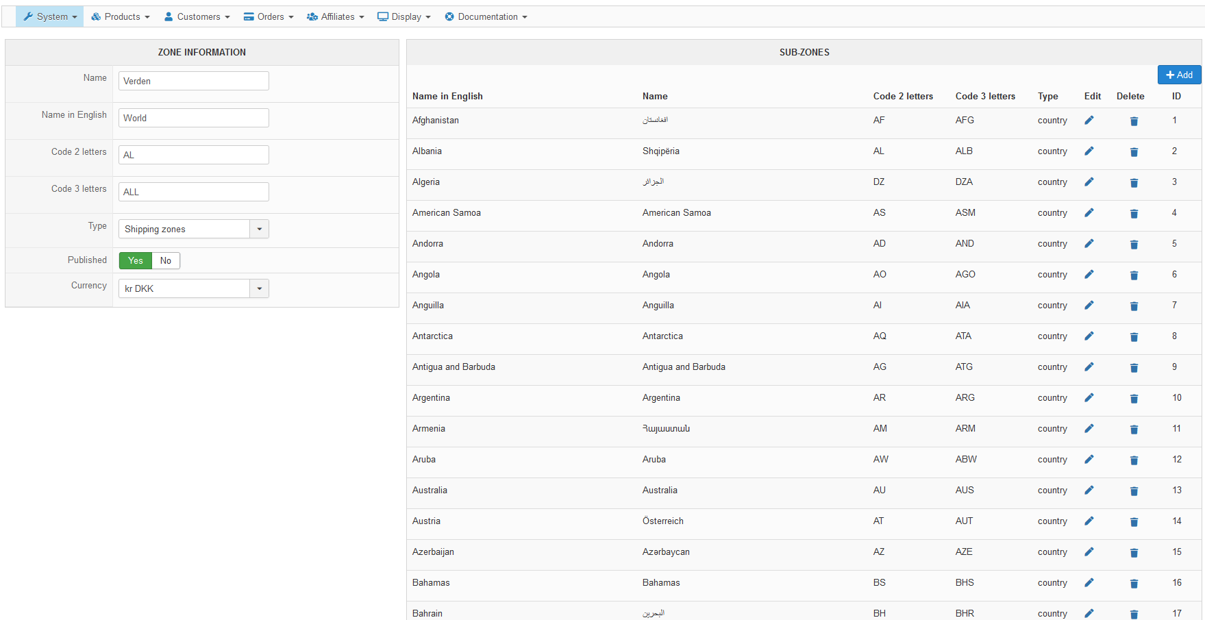

5 years 9 months ago #326897
Can you show us some screenshots of :
- how you configured your Denmark shipping methods via "Hikashop->System->Shipping methods"
- the "Denmark" zone via "Hikashop->System->Zones"
Thank you.
Kind regards,
Mohamed.
  • Posts: 86
5 years 9 months ago #326956
Here are the screenshots
5 years 9 months ago #326974
The issue can eventually be coming from the presence of the "Denmark" zone in the "Verden/World" zone.
Can you send us a temporary access to your back-end and give us step by step instructions to reproduce it through our contact form (please specify a link to that thread in your message) :
Kind regards,
Mohamed.
  • Posts: 86
5 years 9 months ago #327013
Mohamed Thelji wrote: The issue can eventually be coming from the presence of the "Denmark" zone in the "Verden/World" zone.
The Denmark zone is NOT part of the Verden/Wold zone.

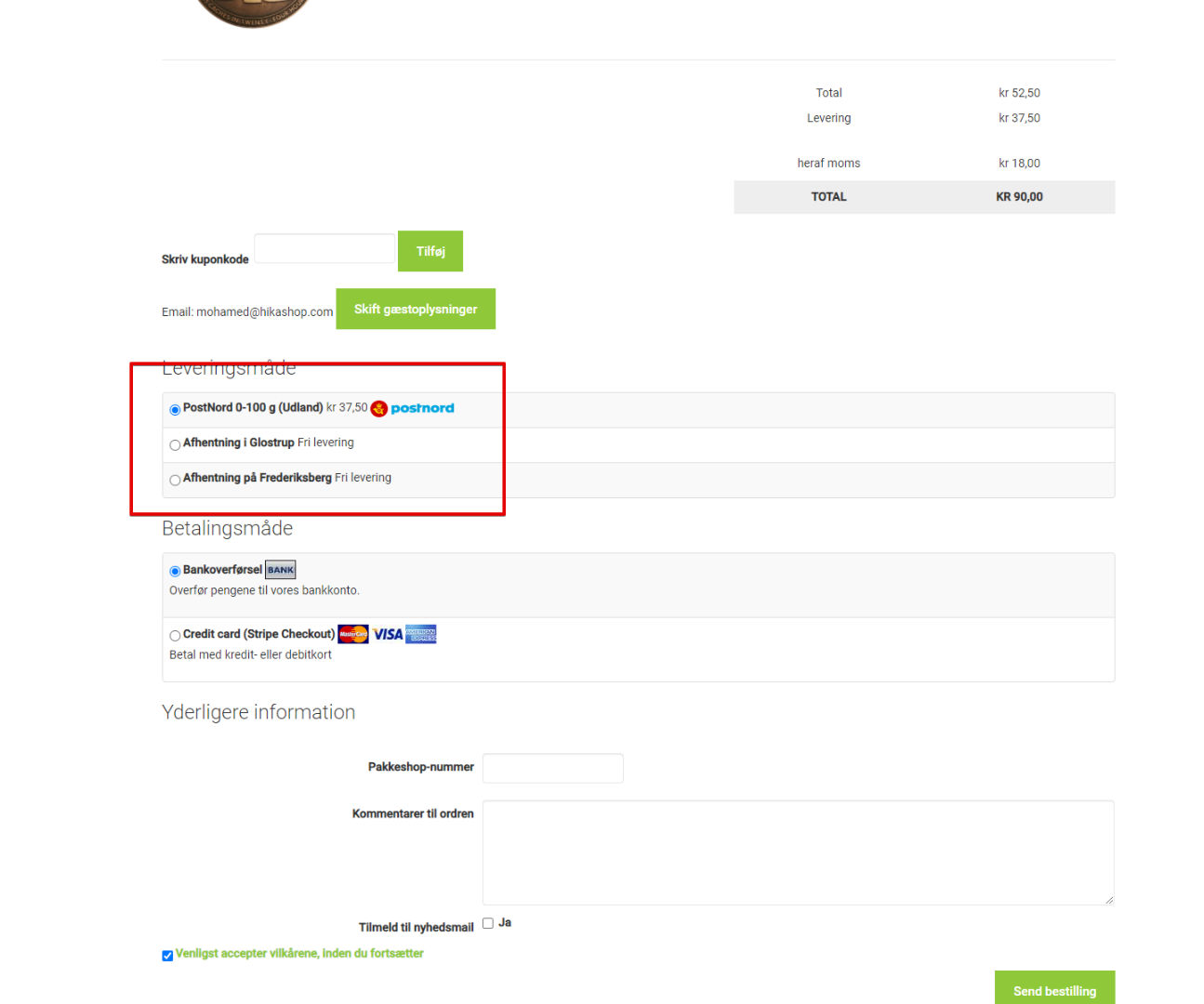

5 years 9 months ago #327070
I actually tested it by changing my shipping address but I had to add an "Address" step in your checkout workflow to do it, and it worked fine.
Your issue is probably coming from the fact that you can't properly select your shipping country without any shipping step on your checkout workflow.
Also, I wasn't able to reproduce a case where both World and Denmark shipping methods would show up.

Mohamed Thelji wrote: Ok, then when you say "I change the country for the buyer" what do you mean and how do you change it without an address step on your checkout workflow ?

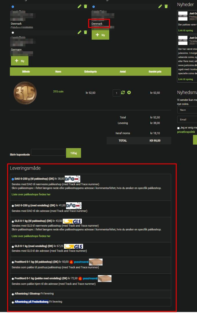

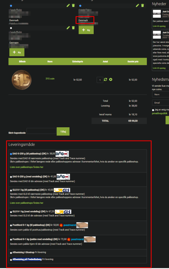

I'm not sure what you mean that I don't have anaddress step.
ere is how my checkout page looks like:
The orange square shown th address information that the buyer fill out.
Mohamed Thelji wrote: Do you mean that if I set the shipping zone to "USA", then Denmark shipping methods will be still available in your case ? Because when I tested it, it wasn't the case.
If I select another country in the country list (shown above with a red arow), then the shipping options do not change according to the selected country.
Jacob

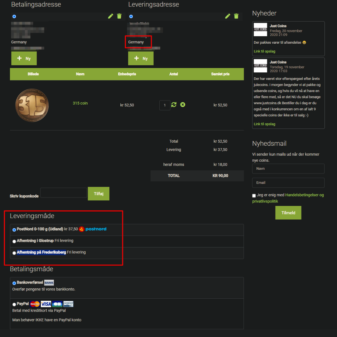

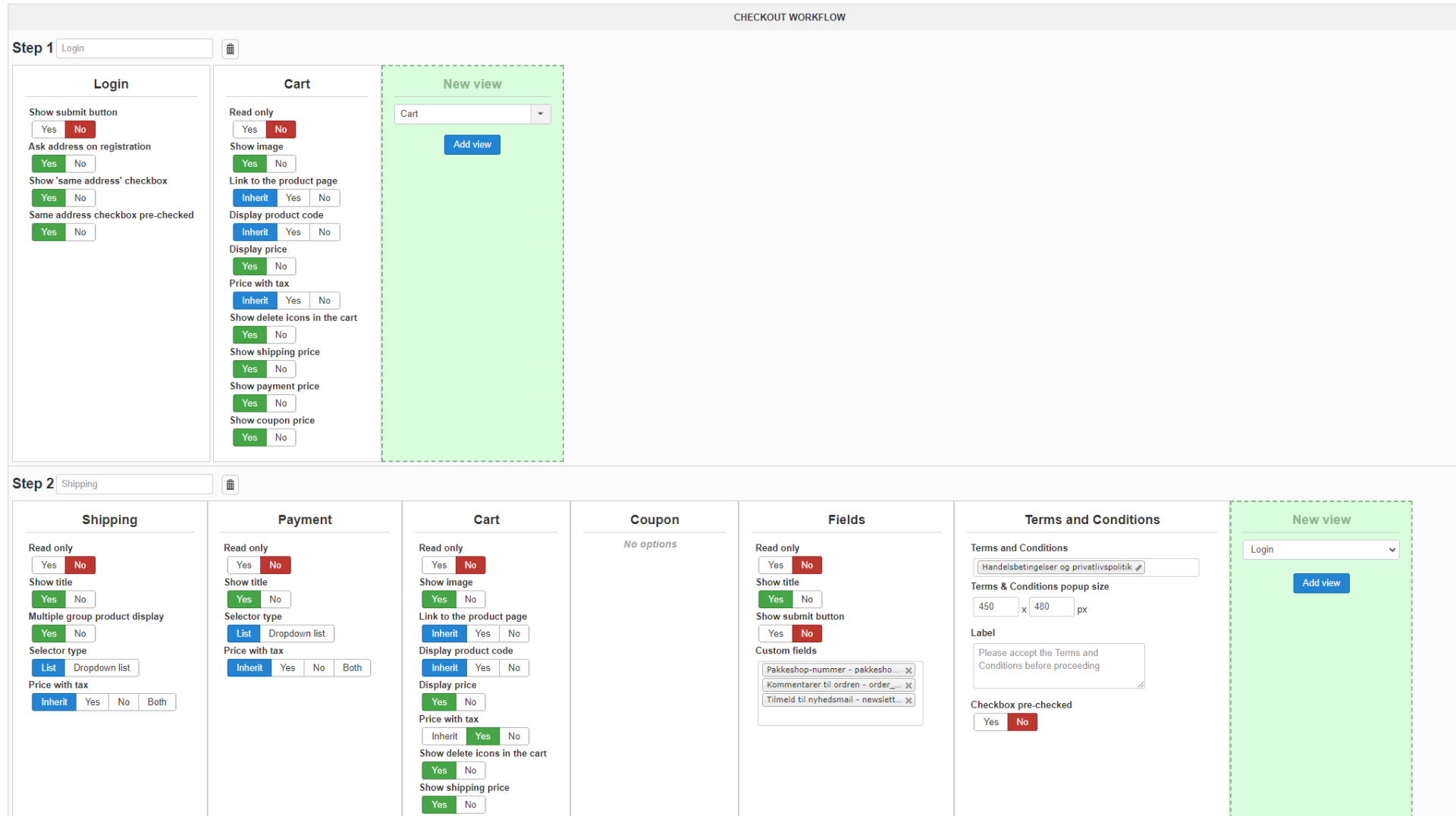

5 years 9 months ago #327297
Hello Jacob,
That's because the registration form wasn't validated, so no country was "selected".
In your case the solution will probably be to edit your checkout workflow via "Hikashop->System->Configuration->Checkout" and have the login and the shipping actions in different steps.
I have attached an exemple of checkout workflow which should do the job.
Kind regards,
Mohamed.

5 years 8 months ago #327383
Hello Jacob,
I just tested it with a guest account with a country set to "Germany" and it worked fine, the checkout page correctly refreshed after I pressed "next" and the correct shipping method were displayed.
How is it possible that we have had multiple orders to countried outside of Denmark that have been procesed properly?
You actually have "Rest of the world" shipping methods, so that's why.
What I said through my previous message was that if you want shipping methods to dynamically change based on the country selected without having to press "next", then you'll have add an address step.
Kind regards,
Mohamed.
Last edit: 5 years 8 months ago by Mohamed Thelji.
