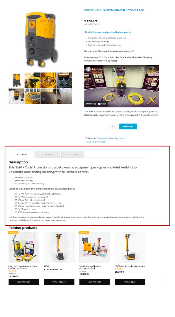

For a project with loads of information I would like to put most of the description text into a 'box' underneath the Add to cart button. Because of the length of the text, the Add to cart button is very low on the webpage.
Some kind of position with additional info would be preferable between the Add to cart button and the Related products feature, full width would be fine. I've enclosed an image I've created with the setup as preferred, the content inside the box with the red border is what I'm looking for. :)
Is this doable, can you please help me with this?
Thanks in advance for your reply!
Kind regards,
Ans
  • Posts: 86112
  • Thank you received: 14210
5 years 7 months ago #328205
Change the "layout on product page" setting of the HikaShop configuration to "tabular" and you'll have the description in a tab like on your screenshot.
Then, if you still want some pieces of it on the right side, you could create a custom field of the table "product" and of the type "WYSIWYG" or "textarea" to enter the text for the right side.
The text of the custom field will display below the add to cart button on the side and not above it. If you want to move it, it would then be possible to swap the block of code for each element in the show_tabular view file via the menu Display>Views, similarly to how you move the description from the bottom area to the right side area in show_default.php

I'm sorry to bother you again, but somehow or the other I can't get it right. I've created an new custom field of the table "Product" > "WYSIWYG". Now there is a new tab in the box below [next to Description there is a new tab Specifications].

I've got quite a nice conversation with myself, but I wanted to let you know I've solved the view issue I had with the custom field. It now shows exactly as I need under the add to cart button.
