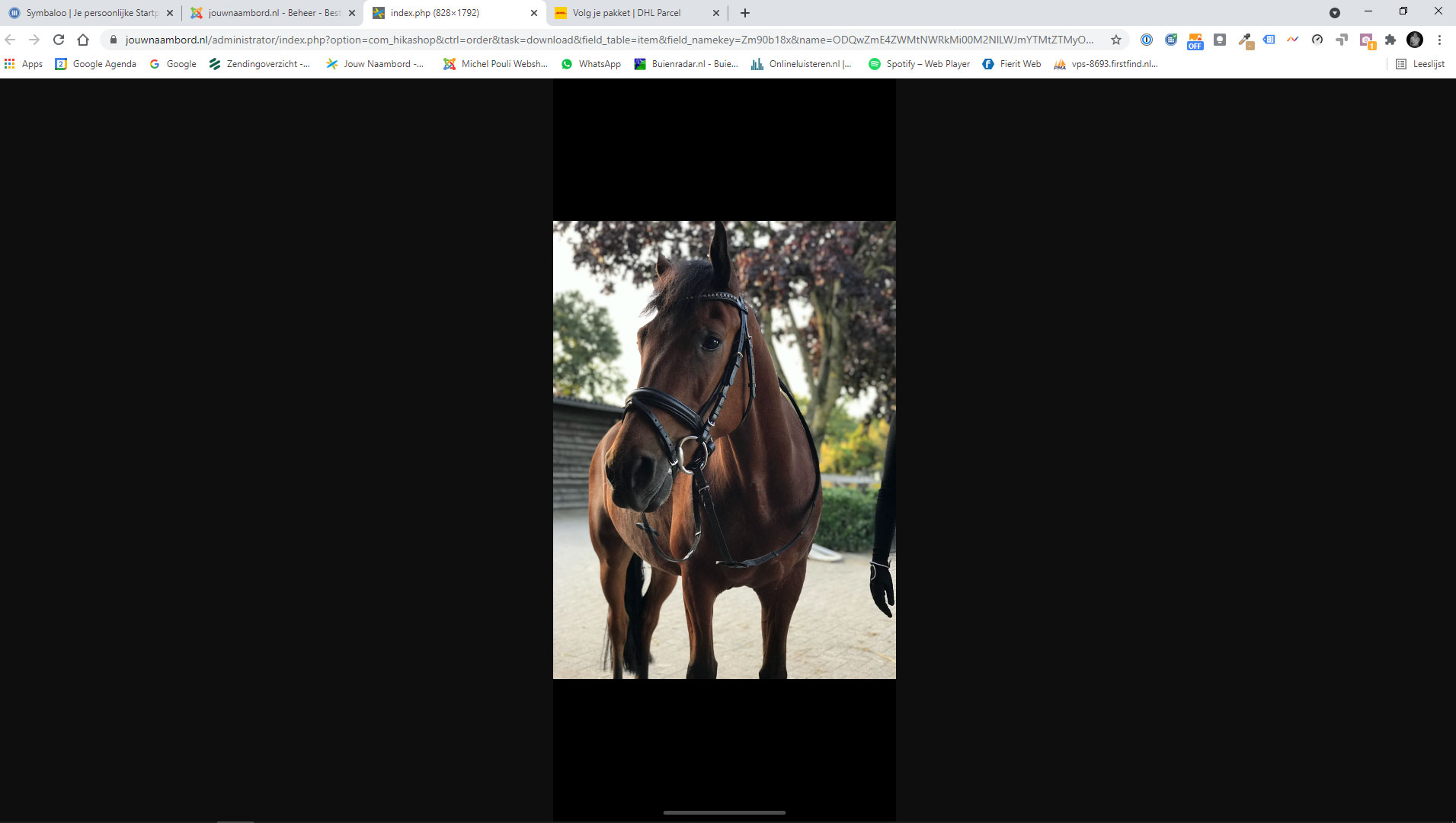

I use ajax fields for customer image uploads. When I download the images in the backend I always save the image to a downloadfolder. Since the latest versin of Hikashop 4.4.1 the download always opens in the browser instead of having the option to save it. At first I thougt it was a browser issue (always using Chrome), but I tried 2 other browsers (Firefox and Edge) and there I experienced the same problem. The image that opens has the pagename index.php (see screenshot). Could this be a small bug?

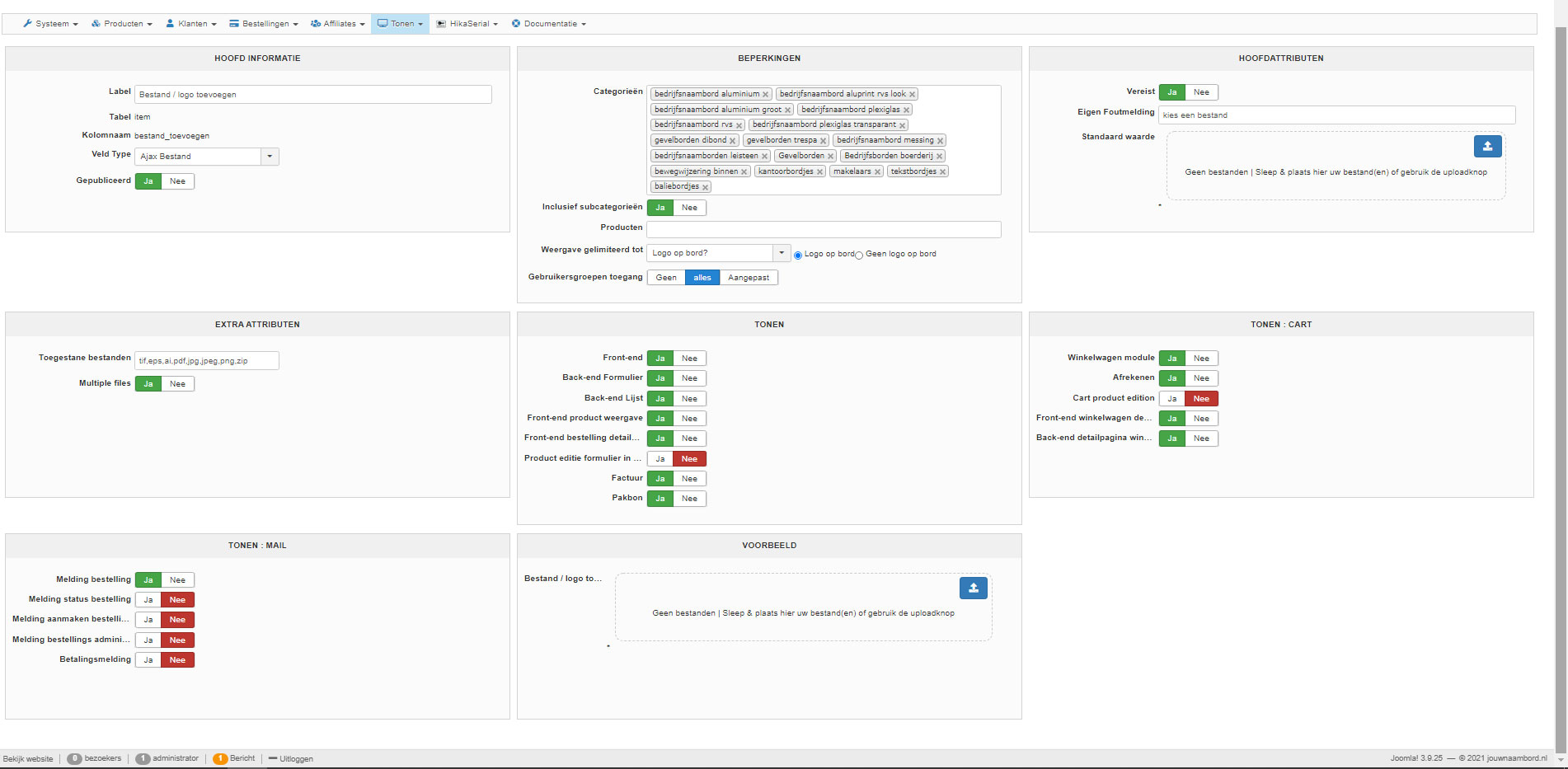

Can you provide a screenshot of the settings of the custom field ?
  • Posts: 515
  • Thank you received: 22
5 years 5 months ago #331553
Sure, see screenshot attached.
  • Posts: 86112
  • Thank you received: 14210
5 years 5 months ago #331558
Thanks.
So before the update, you only had the image displayed and it was not clickable. You had to right click on it and select the option to save it.
Now, you still have the image, so you can still right click on it and select the option to save it. And on top of that, you can click on it to get it to open on a new tab in full size.
This change was made following this thread:
www.hikashop.com/forum/4-how-to/900906-u...ages-from-order.html

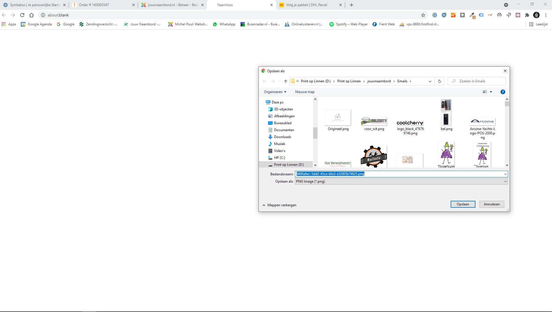

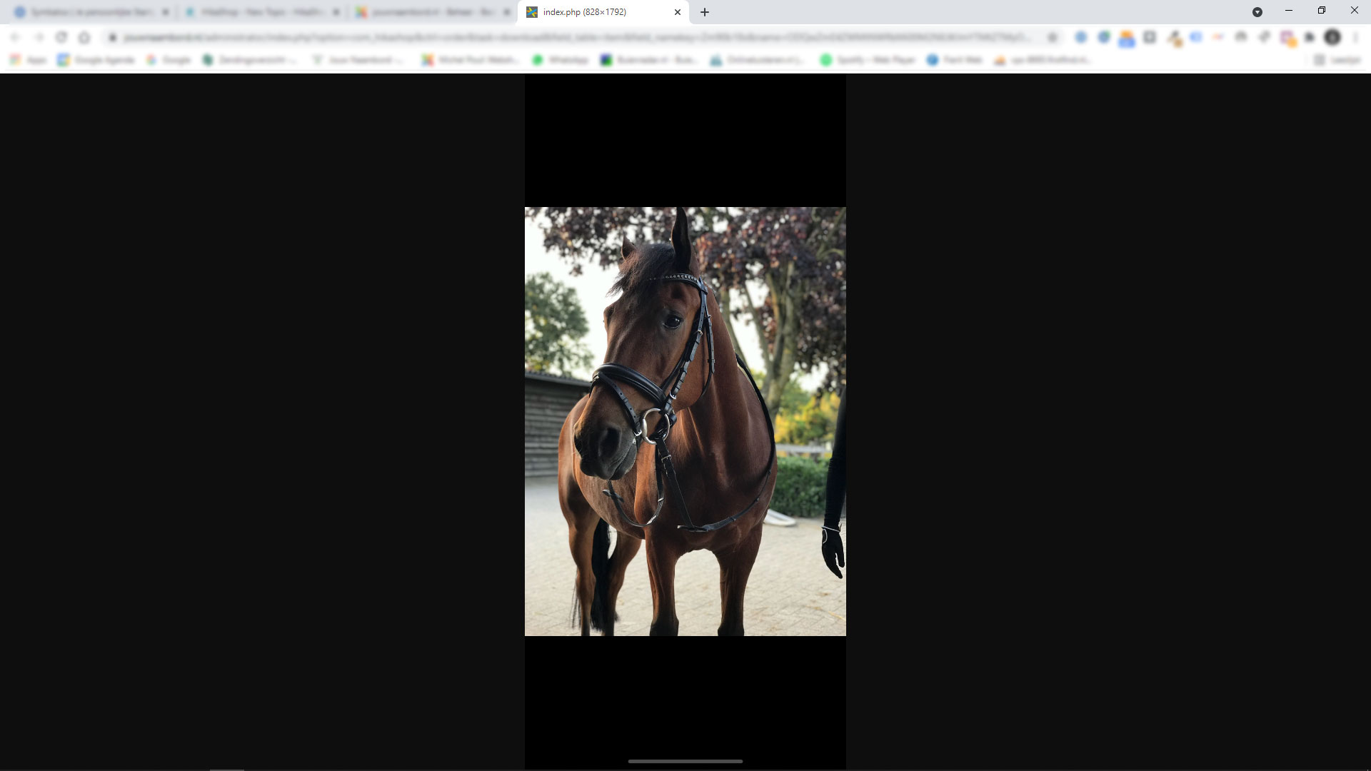

That's not true. It was clickable and I did have the option to save it. I've been doing that for years, so I'm used to it. I downgraded to 4.4.0 and made a screenshot to show you.
