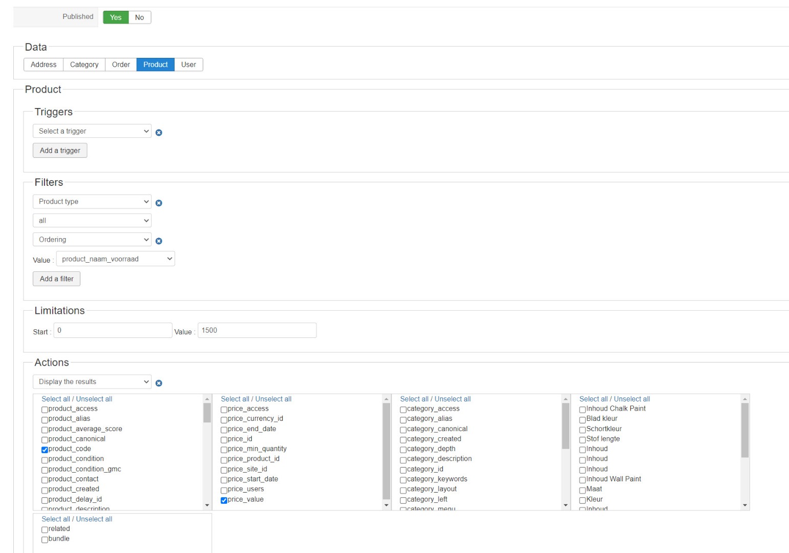

After the latest update a Mass Action give problems.
We get this error: 1136 Column count doesn't match value count at row 1
The Mass Action look like this.
Hope you can fix this issue.

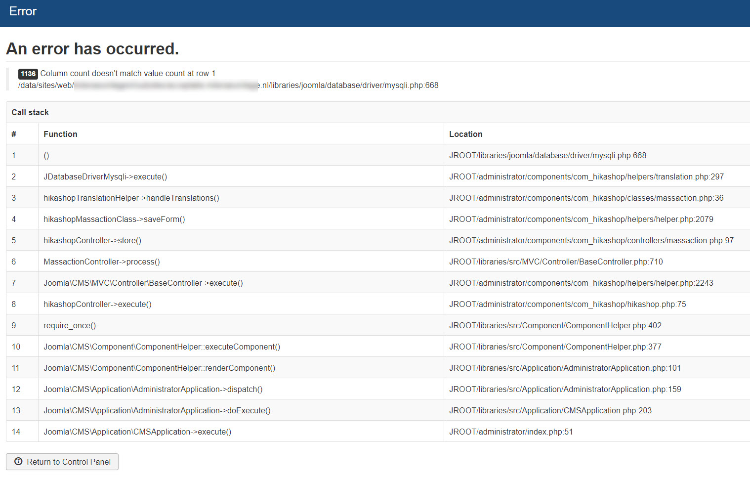

5 years 4 months ago #332091
When we do that we get this error information.
I'll send you the login details through the email.
Kind regards,
Lumiga
