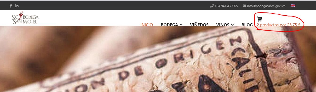

I have followed several forum posts ( www.hikashop.com/forum/4-how-to/878588-a...ge-on-mini-cart.html and www.hikashop.com/forum/install-update/89...rt-icon-in-menu.html ) to achieve placing cart icon into item mneu using mini-cart module inserted with tag from modules anywhere, see picture_1 attached.
Lenguaje overrides used are:
CART_EMPTY="<img src=' /bodegasanmiguel/images/iconos/cart_icon_red.png ' />"
X_ITEM_FOR_X="<img src=' /bodegasanmiguel/images/iconos/cart_icon_red.png ' /> %s producto por %s"
X_ITEMS_FOR_X="<img src=' /bodegasanmiguel/images/iconos/cart_icon_red.png ' /> %s productos por %s"
I have 2 questions:

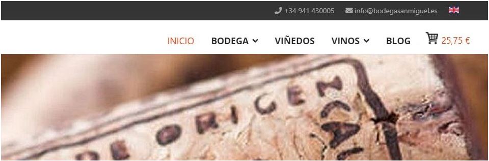

1st.- how can I only show the total price text, as in desired picture_2 attached?
2nd.- how can I place cart icon and total price text in the same line one as picture_2?
Your help will be welcome.

1. You can adapt your translation overrides.
For example, you could have:
X_ITEM_FOR_X="<img src=' /bodegasanmiguel/images/iconos/cart_icon_red.png ' /> %2$s"
X_ITEMS_FOR_X="<img src=' /bodegasanmiguel/images/iconos/cart_icon_red.png ' /> %2$s"
2. It will require some CSS code to do that.
What CSS code to use depends on the HTML in that area and the CSS already added by your template. So I can't say for sure the exact CSS code you would need to add as you didn't provide the URL of that page.
Here is the documentation page where we explain how to add custom CSS to your HikaShop:

Don´t worry about 2nd point, it is solved, just for rest of the people, to place total import side by side to cart icon you only need to add some css class (in my cas eI created new class "iconocarrito" with display: inline) to your translation override, like:
CART_EMPTY="<img class='iconocarrito' src=' /bodegasanmiguel/images/iconos/cart_icon_red.png ' />"
X_ITEM_FOR_X="<img class='iconocarrito' src=' /bodegasanmiguel/images/iconos/cart_icon_red.png ' /> %2$s"
X_ITEMS_FOR_X="<img class='iconocarrito' src=' /bodegasanmiguel/images/iconos/cart_icon_red.png ' /> %2$s"
and it works.
