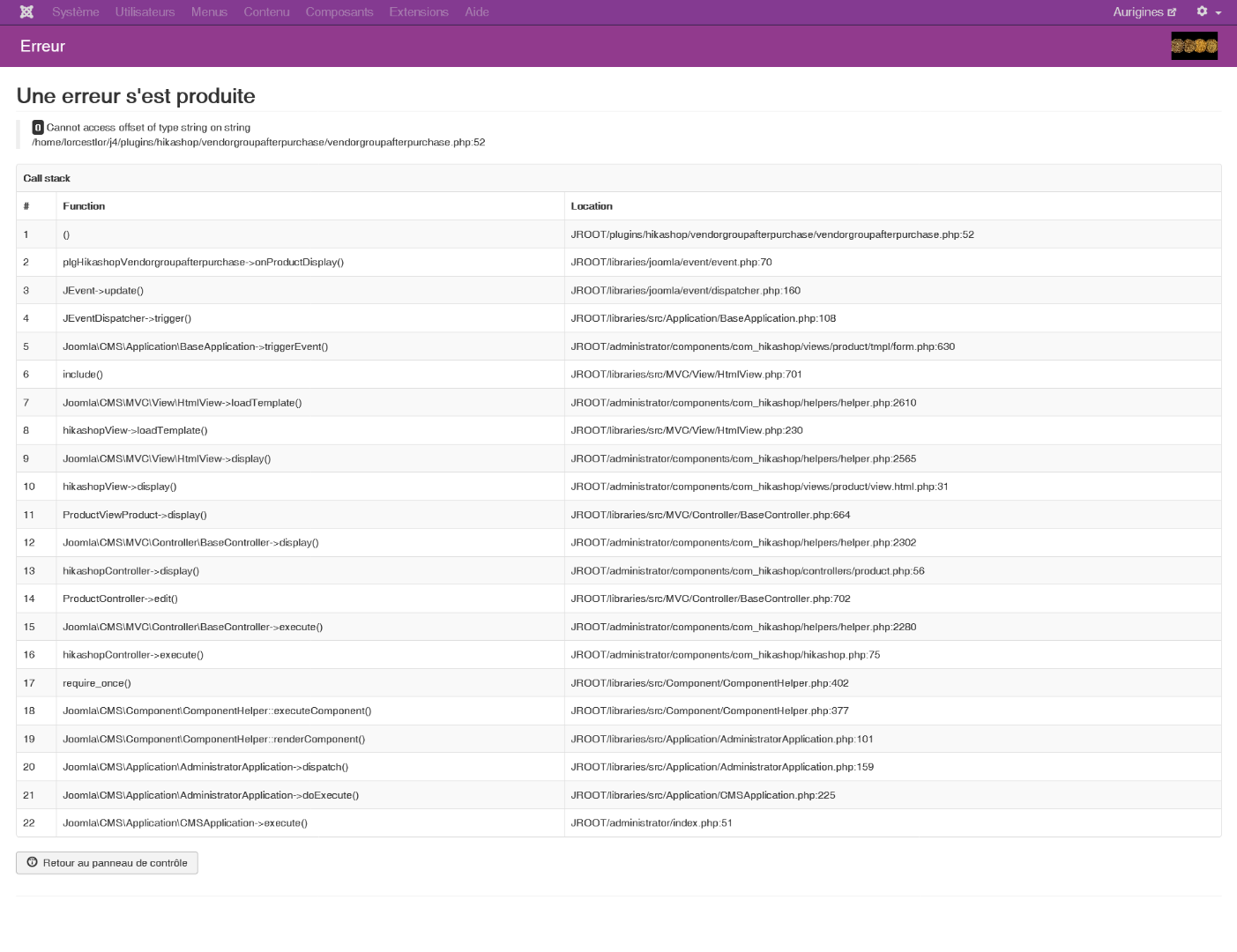

4 years 11 months ago #335795
Hi;,
Here is the screenshot of the error page.
  • Posts: 26384
  • Thank you received: 4077
4 years 11 months ago #335799
That's an issue with the HikaMarket plugin "vendorgroupafterpuchase".
You need to edit the plugin and replace the line
		if(!empty($product->product_vendor_params) && is_string($product->product_vendor_params))
By
		if(empty($product->product_vendor_params))
			$product->product_vendor_params = array();
It will avoid that "product_vendor_params" be considered as a string.
We will add that patch in the HIkaMarket package too.
The following user(s) said Thank You: LOCELO
  • Posts: 214
  • Thank you received: 21
4 years 11 months ago #335802
It's OK !
Thank you!

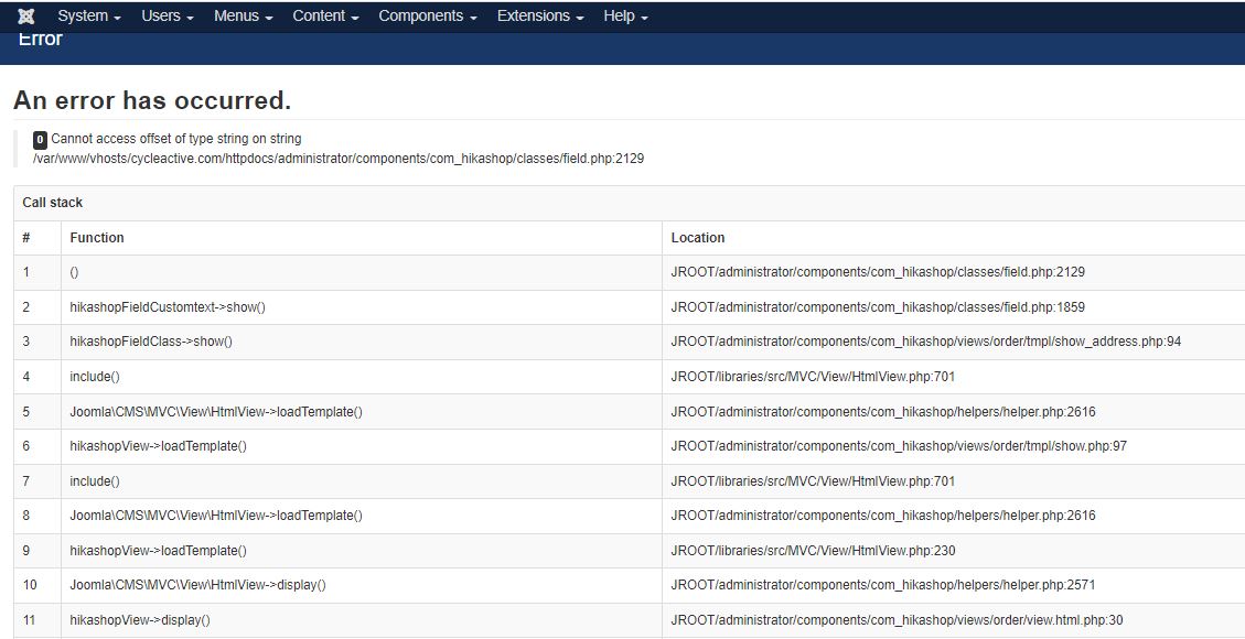

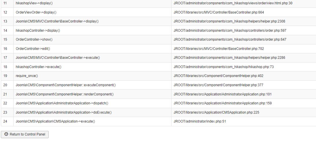

  • Posts: 11
4 years 8 months ago #338036
Ok looks like a similar problem so I'm tagging it onto this thread.
J 3.10.4
PHP 8.0.13
In the backend I can see the list of orders but get an error once I click on one.
An error has occurred.
0 Cannot access offset of type string on string
Can you see whats going wrong from the attachments?
(Note: this error only happens on PHP 8.0.13. If I roll back to PHP 7.4.26 orders can be viewed. )
Cheers
Rich
  • Posts: 86112
  • Thank you received: 14210
4 years 8 months ago #338050
The error seems to be linked to a custom field of the type "custom text".
Add the code:
if(empty($field->field_options))
			return '';
		if(is_string($field->field_options))
			$field->field_options = hikashop_unserialize($field->field_options);
just before the code of the line 2129 of the error message in administrator/components/com_hikashop/classes/field.php and it should fix the problem.
Let us know how it goes so that we can include this on our end.
  • Posts: 11
4 years 8 months ago #338058
yes that's fixed the error. thank you

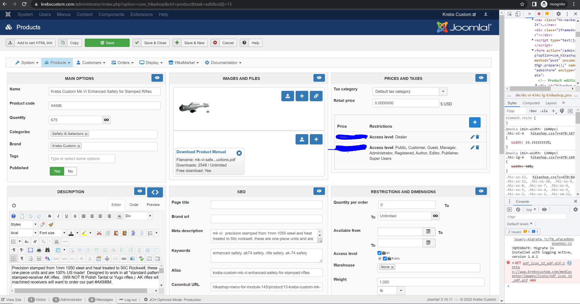

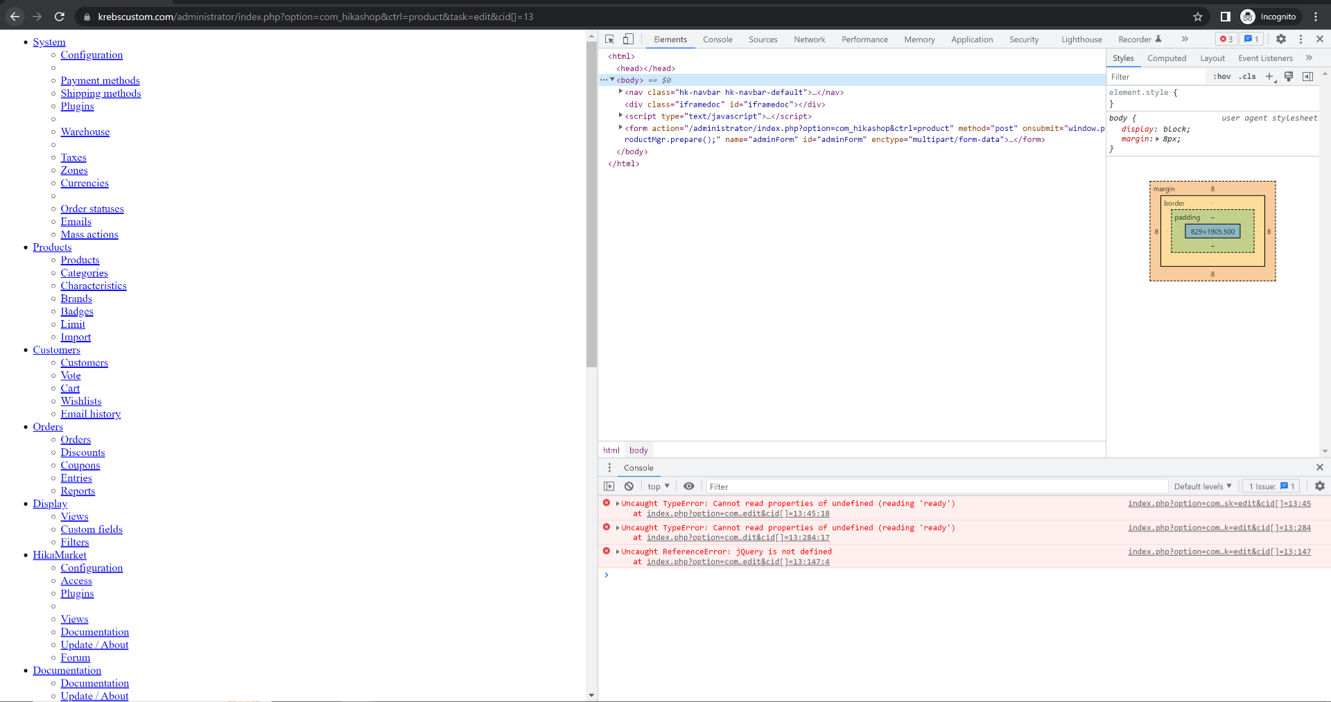

3 years 8 months ago #347616
Hello, I have a similar issue where, when I upgrade PHP to 8.x from 7.4.x, when viewing product page under Hikashop-> Product -> Click on any existing product to edit, it shows blank page with bunch of text with no formatting.
Errors from inspect element is attached to the thread.
I am able to fix this by going back to 7.4.x
Joomla 3.10.11
Hikashop is 4.7
Hikamarket 4.1.1
PHP 7.4.x
Error in PHP 8.X

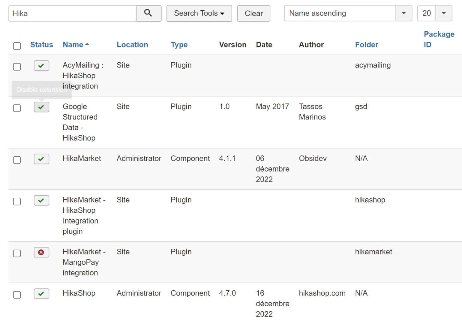

  • Posts: 86112
3 years 8 months ago #347620
First, please activate the "debug" setting of the Joomla configuration and try again.
You'll get an error message at the bottom of that error page which will explain where the problem is. Please provide the full error message there and we should be able to tell you what to do.
Looking at the screenshot of the working product edit page, it seems you're using JCE for your HTML editor, and since it happens only on the product edit page and not on the listing, it might be that you didn't update JCE and the version you have is not compatible with PHP8. But I can't say for sure without the error message.
  • Posts: 2
3 years 8 months ago #347638
The problem I ran into by doing the debug settings is that, it won't even load the debug module on the webpage causing me not to get the full error message that will help us.
Although, I took your suggestion on JCE and upgraded it to the latest one JCE Pro 2.9.32 and then upgraded PHP to latest one PHP 8.2.0 and now it is working like a charm without any issues.
Also, What else I noticed is that JCE plugin was not working fine if I upgrade the PHP prior to the JCP upgrade.
This is the issue I was trying to resolve. Thank you very much.
