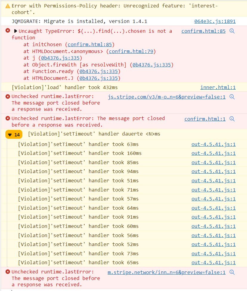

  • Posts: 4
4 years 9 months ago #337872
thanks for replying so fast.
Yes, in the Emulation with mobile devices (MS Edge) I can reproduce the problem. The errors in the developer window are attached.
Another hint:
- the problem occurs when using the mobile template "protostar - default"
- when switching to the mobile template "mobile_basic - default" the it works
one more hint:
- it works on iOS, but not on Android
However I prefer to use protostar ... so I´d like to get it running with protostar.
Thomas

  • Posts: 86113
  • Thank you received: 14210
4 years 9 months ago #337882
The javascript error of your screenshot indicates a problem with the initilisation of the chosen library.
If you have the "user chosen library" setting activated in the HikaShop configuration, you can try turning it off and see if that helps.
