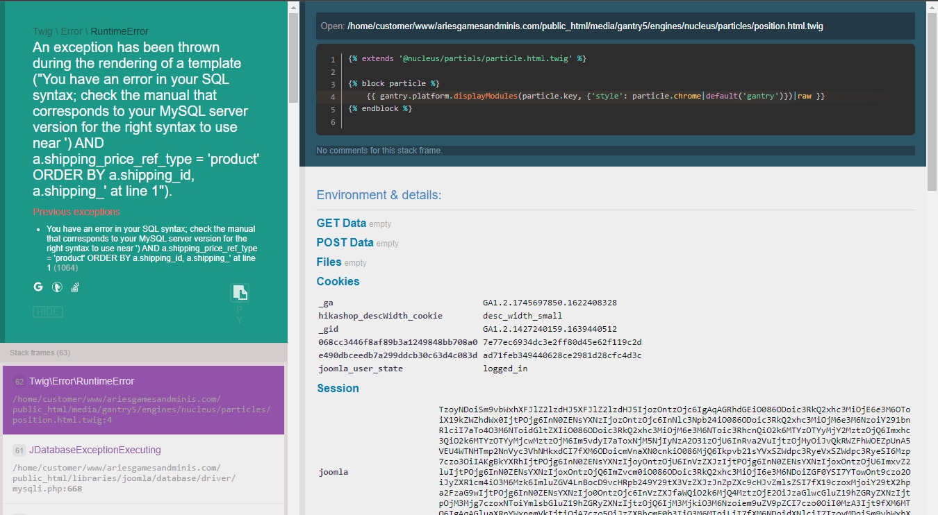

I don't know what is going on, but I've had a couple users inform me that they are getting a white screen at log in. I try myself, and my normal user ID I use to check things works fine...as well as my Admin ID, but when I try to use their ID to log in & check things...I get a white screen.
I did some checking on what I could, but I really need help, this is very much so above me. Oddly...my test site, does not have this issue. BOTH sites are updated with all current versions of everything...so both sites should act the same but are not.

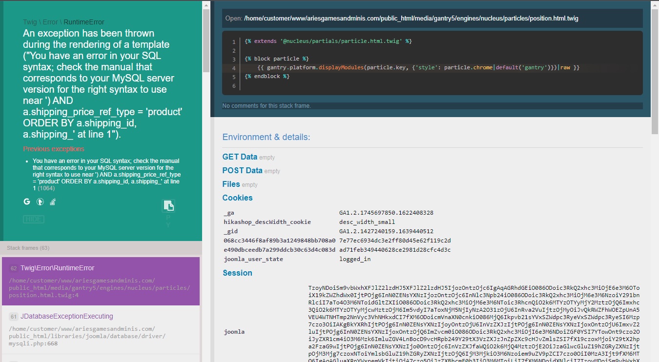

Attached are some images when I turns on debugging. The first is an actual image...but the image was so long, I could not capture it all. I've also added PDF's of those 2 sections on the image which stretches way down the page.

The problem seemed to be coming from the fact that your customers had a product in his cart which wasn't available anymore (deleted / unpublished / ...) so the system was trying to automatically estimate the shipping price without having any information about a cart product.

Mohamed....I did as you noted, and it did not work. I double checked my entries, and still...not working. So I logged in on the backend, made sure the account was signed out, and tried again...still did not work.
Since you mentioned it was something in the cart that was screwing things up, I checked the carts on the test site and got the attached Error.
I'm sending login credentials to the Contact Us page...if you could take a look, I'd appreciate it. I'm trying to get an extension updated from Tsuki for the Square platform and cannot test what i need to.
