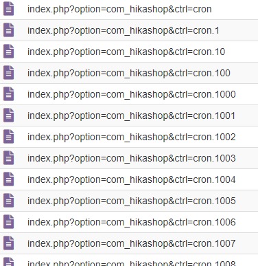

This are in the public folder
index.php?option=com_hikashop&ctrl=cron.10
But many, like.. 100+

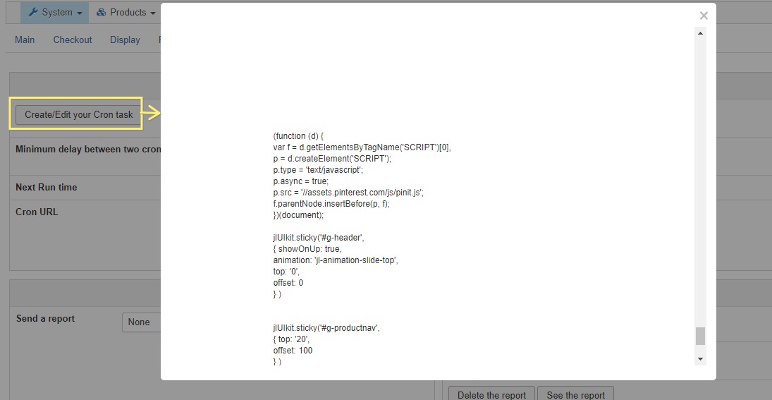

You do not have permissions to access this page.
And also, this think is showing up when I press "Create / Edit your cron task"
It load's some data from another view or so, I can all see some categories there.

I don't know why it would do that.
What is in these files ?
Can you edit one with notepad and check the content ?
The javascript code in the screenshot screenshot seems to be linked to your Joomla template.
So maybe it is linked to a system plugin of your template which would run in the backend and mess with the cron task system ?

In each file, is the message that show up after each cron job
<div id="hikashop_messages_info" class="hikashop_messages hikashop_info"><ul><li>HikaShop Triggered at 08-03-2022 05:45</li></ul></div><div id="hikashop_messages_info" class="hikashop_messages hikashop_info"><ul><li>THE MESSAGE FROM REMINDER PLUGIN</li></ul></div>
<div id="hikashop_messages_info" class="hikashop_messages hikashop_info"><ul><li>HikaShop Triggered at 08-03-2022 05:30</li></ul></div>
I trigger Hikashop Cron URL from my server after each 15 minutes
So, this files are not in the public_html folder, they are in root: /home/myuser/

Can this be generated by the server cron job and not by hikashop?
wget "https://domain.ro/index.php?option=com_hikashop&ctrl=cron" > /dev/null 2>&1
  • Posts: 86113
  • Thank you received: 14210
4 years 5 months ago #340172
It's probably this yes.
Try removing the "2>&1" in your cron job.
Or maybe check with your hosting if there is something special that should be done on your server to trigger a specific URL.
