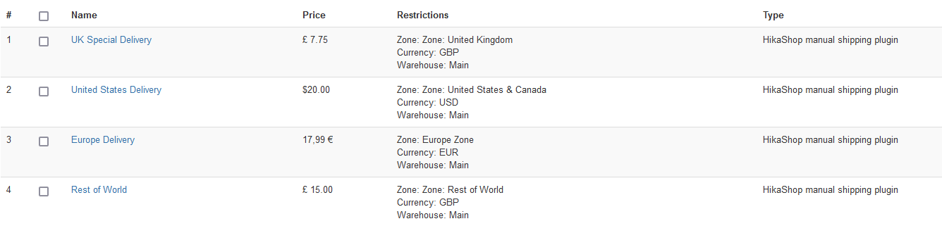

Hi, my deliver charge is based on the Billing address currency. Some people who have their delivery charged are paying the Europe fee just because they are paying in EURO. How do I make the delivery cost to be based on the country address? Thanks

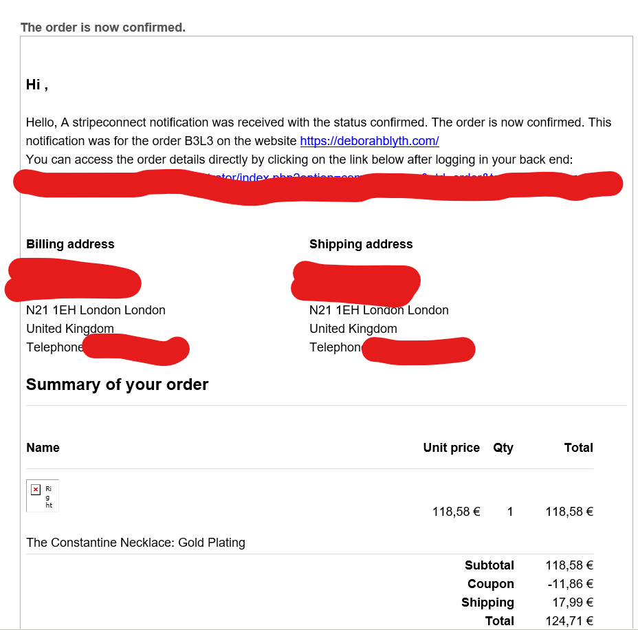

Hi, so I just want to check we are on the same page. We sometimes have people in the UK who have their shipping address as the UK but billing address as EU. So this way they pay in EUROS, but I want them just to pay the UK shipping costs, because we are shipping to the UK.
The way the system is currently configured, is that they end up paying the Europe delivery, even though we are delivering to the UK.

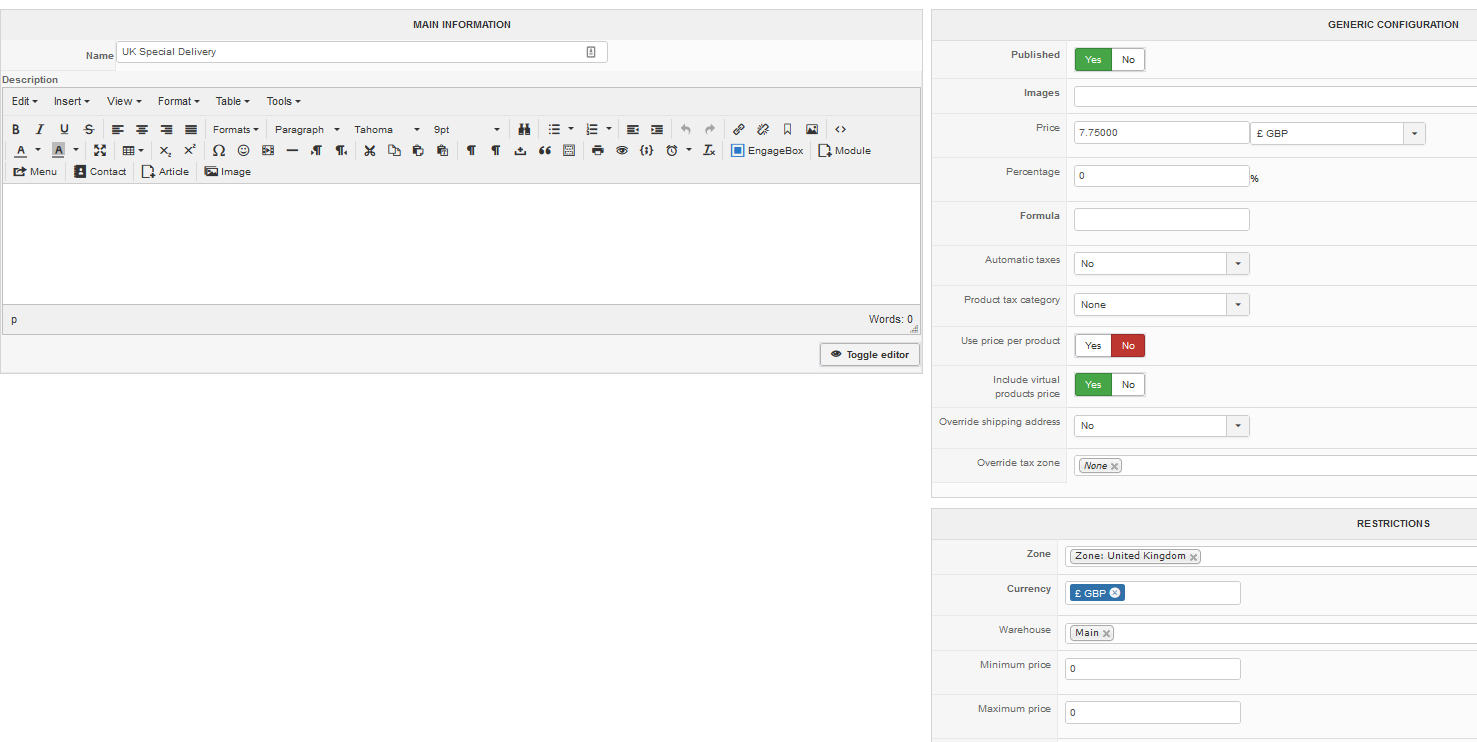

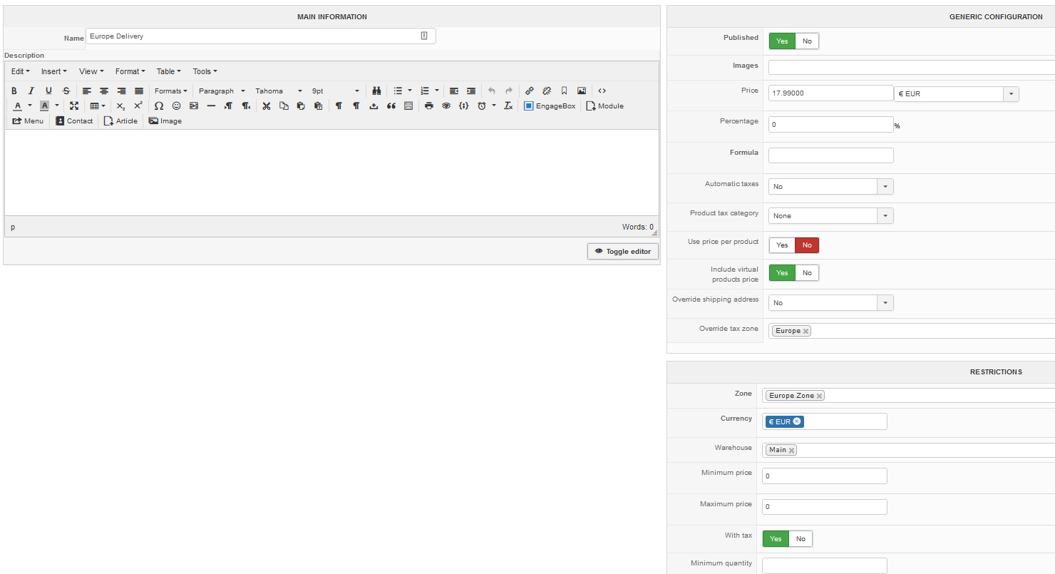

HikaShop already bases itself on the Shipping address to provide the shipping fee.
If I check your screenshots on your first message, I can see that a 17.99€ shipping fee is added to the cart. However, the shipping address is in the UK and the shipping methods for the UK should have a fee of 7.75£ not 17.99€, which is for the Europe zone.
If that it your problem, then it means that you have an issue with the way you configured the zones in the System>Zones menu.
I suppose that the UK country must have been added to the Europe zone.

Hi sorry, yes my fault for not being clear. So I tried your suggestions and removed the United Kingdom out of the Europe Shipping Zone but then when I am in say spain and want to get my order delivered to the UK, it now says 'No shipping methods available for your location'.
