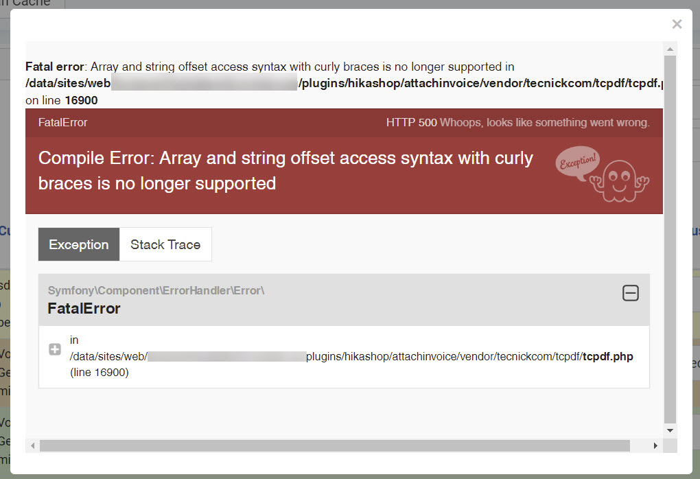

Hi Support,
After update to 4.6.0 and when we change the status in the back-end to confirmed and we sent an e-mail we get this error:
Fatal error: Array and string offset access syntax with curly braces is no longer supported in /.........../plugins/hikashop/attachinvoice/vendor/tecnickcom/tcpdf/tcpdf.php on line 16900

I don't think it has anything to do with the 4.6.0
This is an error caused by a compatibility issue with PHP 8 in the TCPDF library.
It looks like you're using an old version of the PDF invoice plugin.
Download the latest version of the install package of that plugin on our website and install it on yours to get the latest version of the plugin which includes a newer version of TCPDF which supports PHP8.
