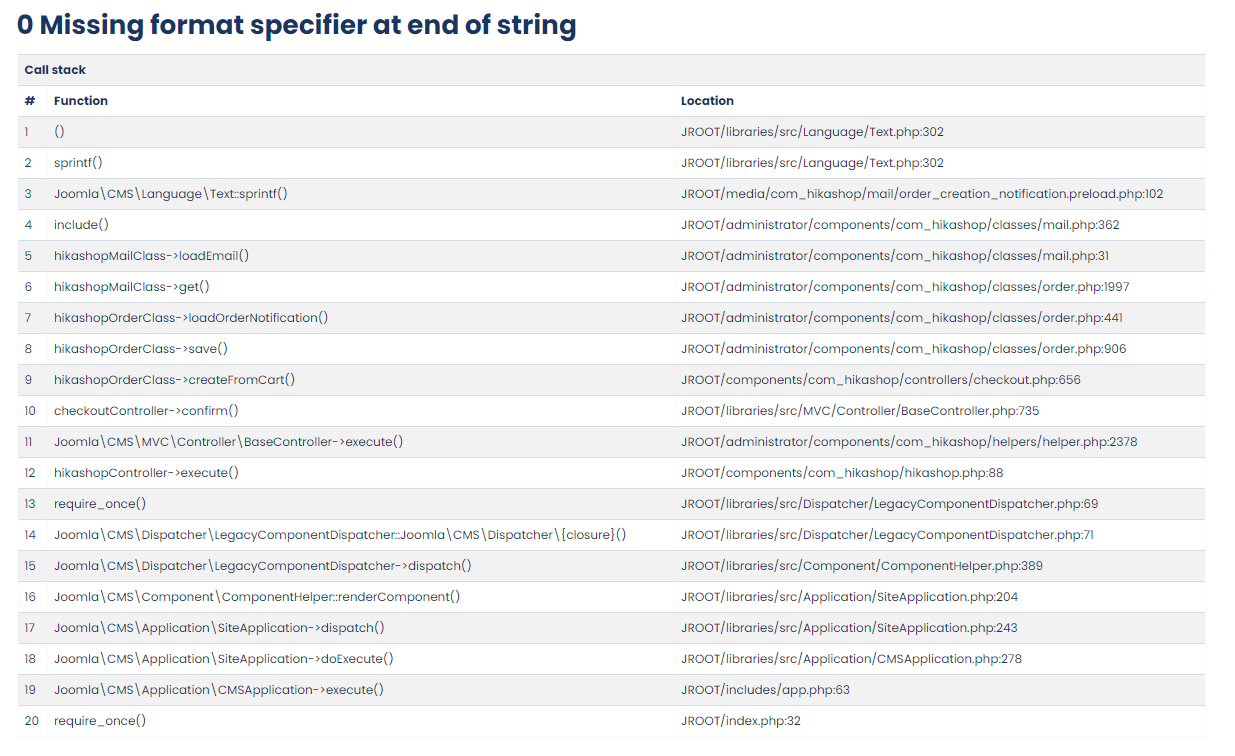

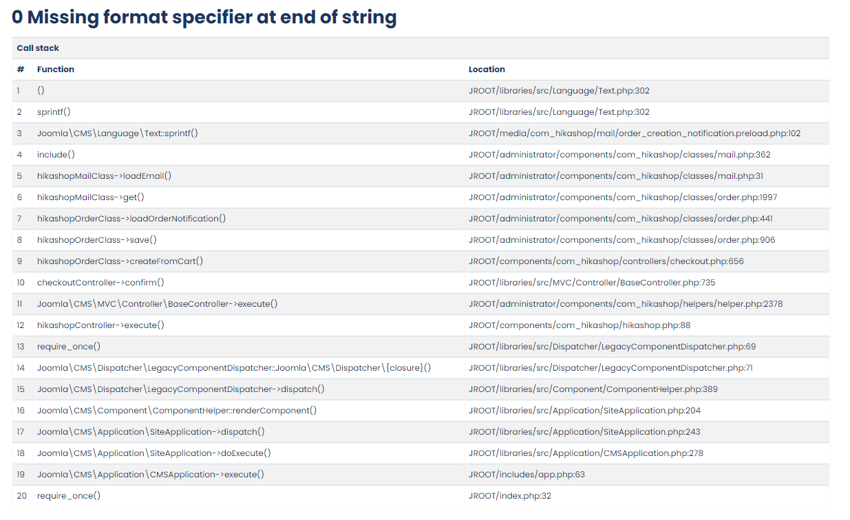

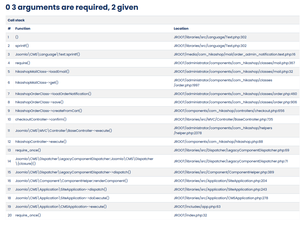

  • Posts: 132
3 years 11 months ago #342579
Debug activated:
Debug and Language debug activated:
Does it help?
Last edit: 3 years 11 months ago by alexmartin.
  • Posts: 85726
  • Thank you received: 14054
3 years 11 months ago #342583
Thank you.
Yes.
This error happens when HikaShop translates the translation key THANK_YOU_FOR_YOUR_ORDER_BEGIN used in the emails.
Looking online for this error for the sprintf function, I found this:
github.com/freescout-helpdesk/freescout/...1d6de0ace3f76fc2419a
This indicates that in the text to be replaced there is a % instead of a %s (we always use %s not %c as in the link but it's the same) and PHP8 crashes instead of ignoring the issue.
So I looked at all the translation files we have for HikaShop and I found that both the Russian and the Malaysian translation files have an issue with that translation key.
I also looked for the website associated with your subscription on our end and it seems to be in Russian, which confirms that the issue is with the Russian translation file.
In it (file administrator/language/ru-RU/ru-RU.com_hikashop.ini, you have the line:
THANK_YOU_FOR_YOUR_ORDER_BEGIN="Спасибо за Ваш заказ %."
which should instead be:
THANK_YOU_FOR_YOUR_ORDER_BEGIN="Спасибо за Ваш заказ %s."
You can manually edit that file via FTP to do the change and it should then fix the problem.
We'll include the modification on our end too.

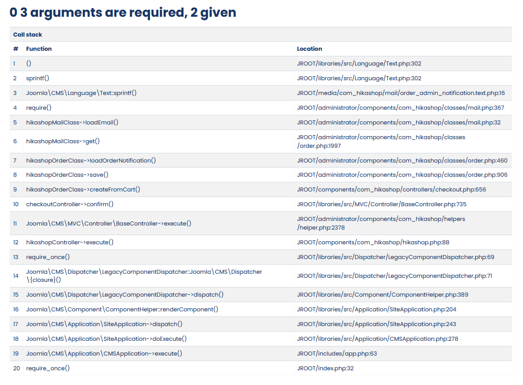

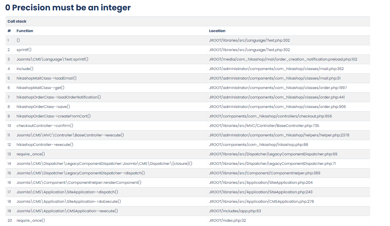

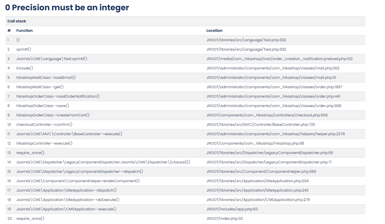

  • Posts: 132
3 years 11 months ago #342613
Yes the site is on Russian,
I have added your recommendation to public_html/language/ru-RU
( not to public_html/administrator/language/ru-RU - ther eis no such line)
Here is the results:
  • Posts: 85726
3 years 11 months ago #342618
Ah yes, there is another problem in the Russian language file.
The line:
ACCESS_ORDER_WITH_LINK="Вы можете получить доступ к подробностям заказа, перейдя по ссылке ниже, после прохождения авторизации на сайте:<br /><a href='%s'>%s</a>"
should be
ACCESS_ORDER_WITH_LINK="Вы можете получить доступ к подробностям заказа, перейдя по ссылке ниже, после прохождения авторизации на сайте:<br /><a href='%1$s'>%1$s</a>"
change that and it will remove that error.
We'll add that change on our end too.
