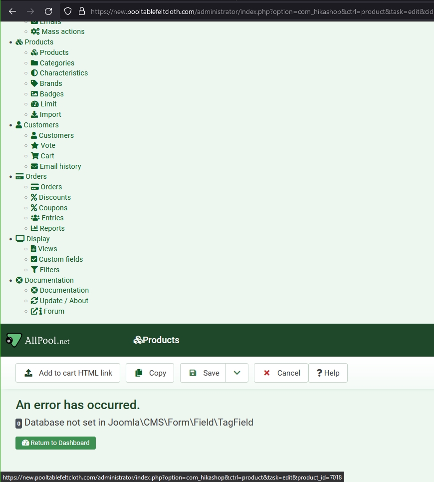

3 years 9 months ago #343939
-- HikaShop version -- : 4.6.1
-- Joomla version -- : 4.2.0
-- PHP version -- : 8.1.9
-- Browser(s) name and version -- : Any
-- Error-message(debug-mod must be tuned on) -- : Database not set in Joomla\CMS\Form\Field\TagField
Just opening up a product in the administration area of Hika causes this error:
It doesn't happen when editing or updating anything else like a category.
It also seems to scramble the HikaShop administrator menu (but just when you get that error).
