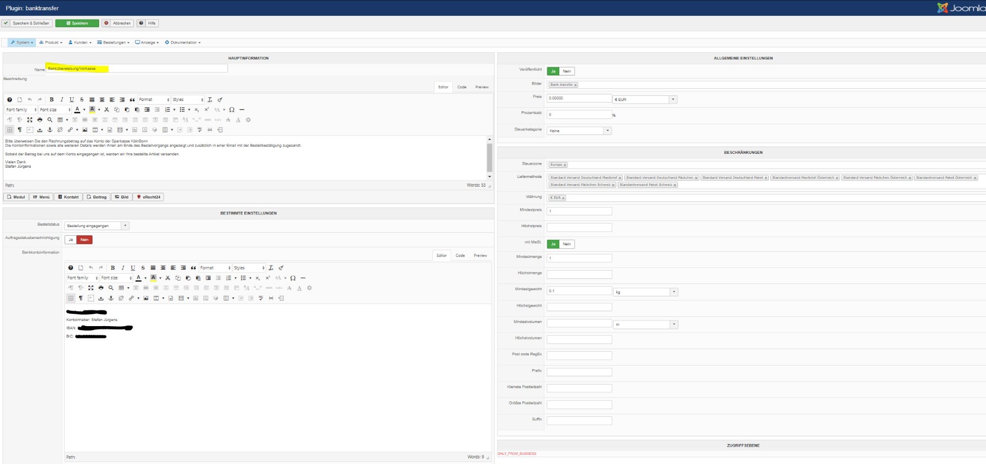

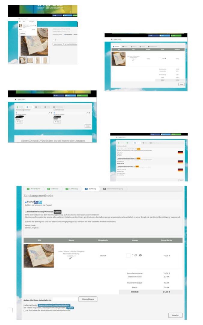

3 years 10 months ago #345871
Please provide these elements in order to help us to better understand the context:
- relative settings screenshot (complete page)
- Url link in order to allow us to see the issue (lacking payment method)
- Step by step process to reproduce the issue (checkout process with good product conditions)
Awaiting your elements to progress

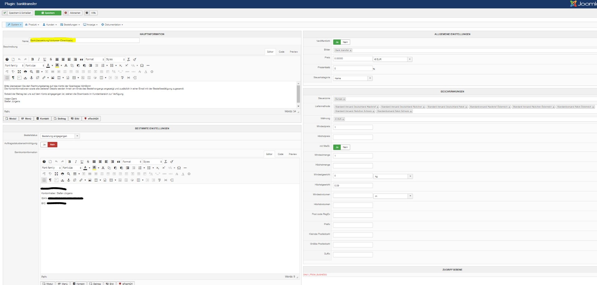

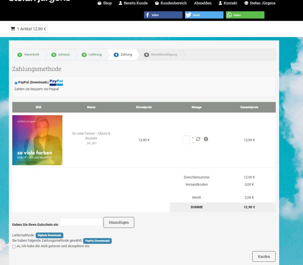

3 years 10 months ago #346129
The screenshots are a bit hard to read. In your bank transfer payment method, it seems that you've selected several shipping methods so that the payment method only appear when one of these shipping methods is selected.
And on your screenshot of the checkout, I can see that the bank transfer payment method doesn't appear with the shipping method "Digitale downloads" selected. However, that shipping method is not in the list of shipping methods of the bank transfer payment method's "shipping methods" setting.

3 years 10 months ago #346156
Hallo Nicolas,
that brought me to the solution!
I selected the shipping method and it worked.
Thank you so much and with best regards
