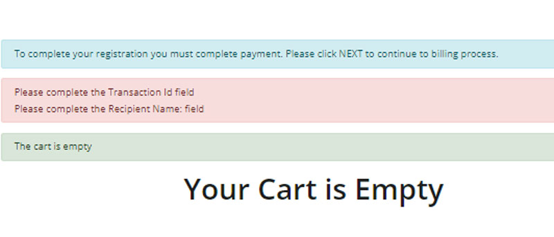

-- Error-message(debug-mod must be tuned on) -- : Please complete the Transaction Id field
Please complete the Recipient Name: field
Just upgraded to J4 and also upgraded Hikashop. I can't seem to add anything to the card from RSVP pro
Anytime all menu items that contain Hikashop breaks the site.

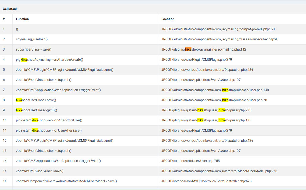

And now i'm getting this on the back end. Please help!

3 years 8 months ago #347903
For the first issue, please contact RSVP's support as we don't know how the integration between RSVP and HikaShop is done. It's completely on the side of RSVP so we don't know much about it and can't help.
For the second issue, this error comes from the AcyMailing extension. Please update your AcyMailing and if you still have the issue please report it to the AcyMailing support.

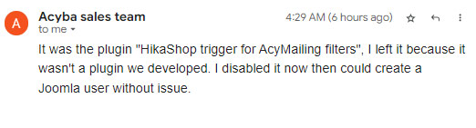

HI - after some work with Acyba mail. Enabling any page that uses Hikashop is still breaking the site. Can you please take a closer look. Attached is the response from Acyba.
All plugins that are associated with Hika shopt (acymail & jevents/resvppro) are definitely up to date.

3 years 8 months ago #347947
So if I understand what you're saying correctly and the message in your screenshot, the second issue with AcyMailing has been solved by disabling the "HikaShop trigger for AcyMailing filters" plugin, and so you only have now the first problem with JEvents and the "Please complete the Transaction Id field" message when adding something to the cart from JEvent.
As I said in a previous message here, for that error you need to check with JEvent.
In your latest message you're saying "any page that uses Hikashop is still breaking the site". But what error message do you have on these pages ? If it's the same message as you reported previously in www.hikashop.com/forum/install-update/90...verything-broke.html as I said, it comes from the hika_rsvp_redirect plugin. And so if it is up to date and you still have that issue, then you need to report the error to JEvent so that they can fix the issue. In the mean time, you can unpublish that hika_rsvp_redirect plugin via your Joomla plugin manager to not have the error.

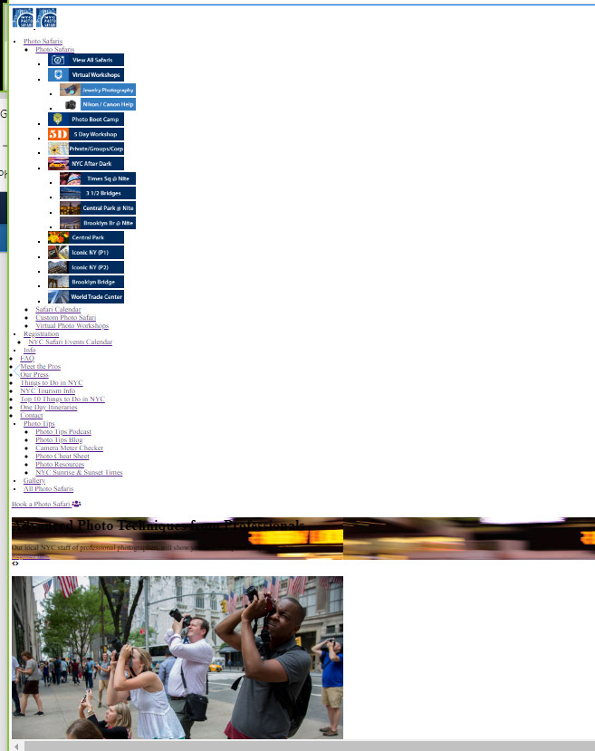

By breaking I mean that the template is completely disabled and everything looks strange. For instance the menus are just a list of menu items as links.
Per my previous post I do not believe this is a jevents issue because it only happens when I enable a page that only uses Hikashop and not jevents. For instance I Have a menu item that uses the Hikashop Product Page menu item type. As soon as it is enabled the template goes away and just links on a white background.
Error message? None. I have debug all the way up. I don't see any error codes. Perhaps I'm missing something?

3 years 8 months ago #347956
Looking at your latest screenshot, this indicates a fatal error during the processing of the page. In such cases, you should have the error message at the end of the page, supposing the "debug" setting is activated and the "error reporting" setting is set to "maximum" in the Joomla configuration page. So please check that these settings at set like that and look at the end of one of the pages with the issue to get the error message. With it, we should be able to tell you what to do.

3 years 7 months ago #348635
I was able to access your backend and check things out.
As far as I can see, it's the CSS/JS optimization mechanism of your template which is creating the problem for some reason. I went in the settings of the template and deactivated it and it now displays the same, regardless of whether you have the menu item enabled or not.
