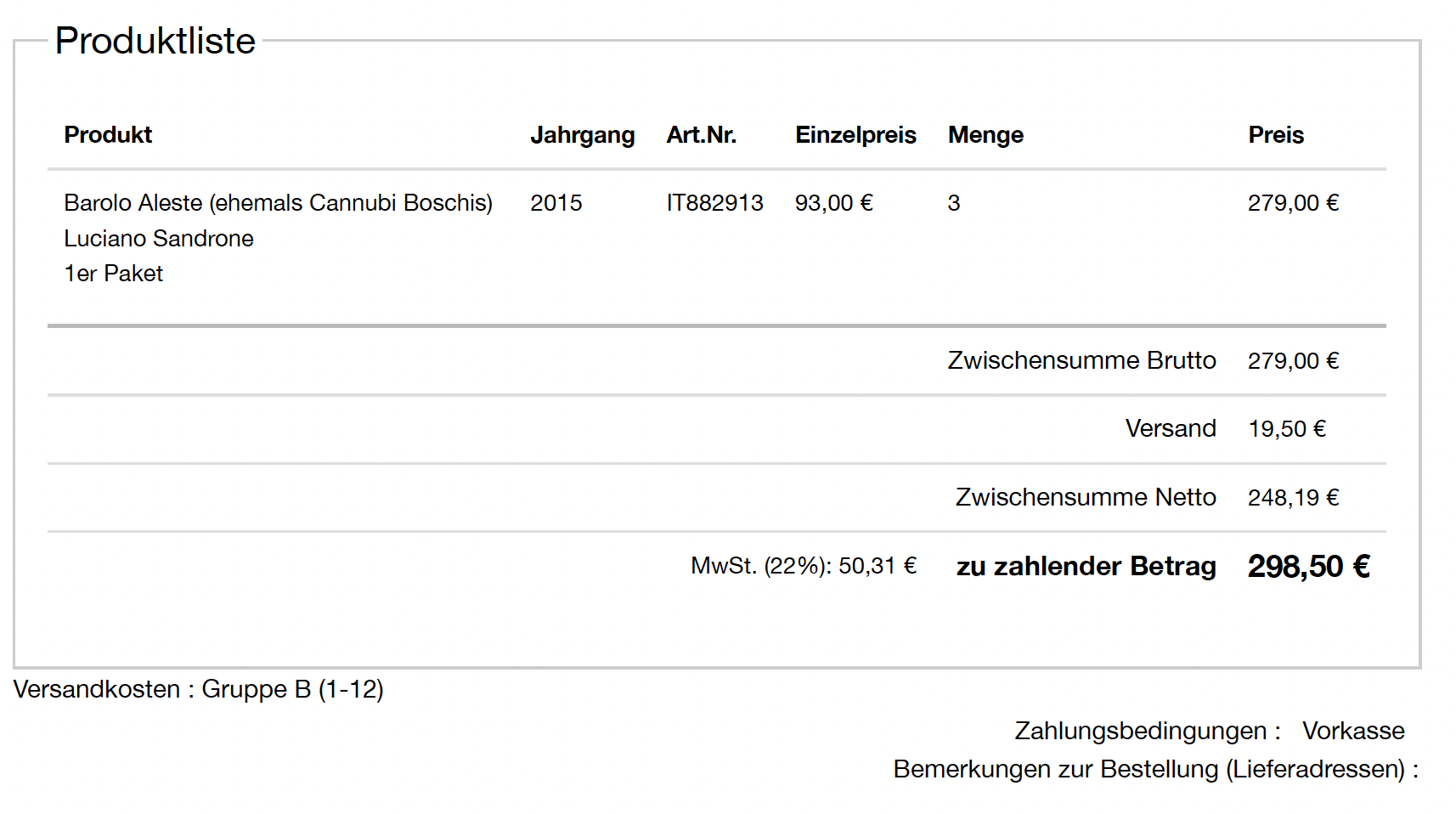

Since the last update, VAT is calculated automatically by the system. which is great. But unfortunately the VAT of the shipping costs is no longer calculated correctly or not at all. As if the shipping had no VAT indication.
See my screenshot.
Any idea how to fix?
many thx

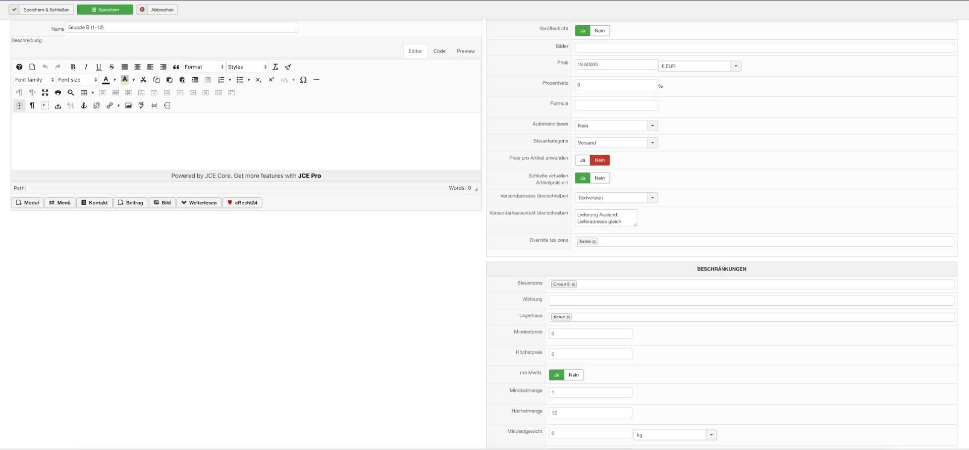

3 years 8 months ago #348260
Pls take a look at my settings.
Many thx
  • Posts: 86112
  • Thank you received: 14210
3 years 8 months ago #348263
I don't read German but it seems to be that you've turned off the taxes in your shipping method.
You probably want to activate the "automatic taxes" setting, or set the "product tax category" setting below to the same tax category as your products.
  • Posts: 61
  • Thank you received: 5
3 years 7 months ago #348376
We just activated the "automatic taxes" function.
I think the issue is solved.
Many thx
