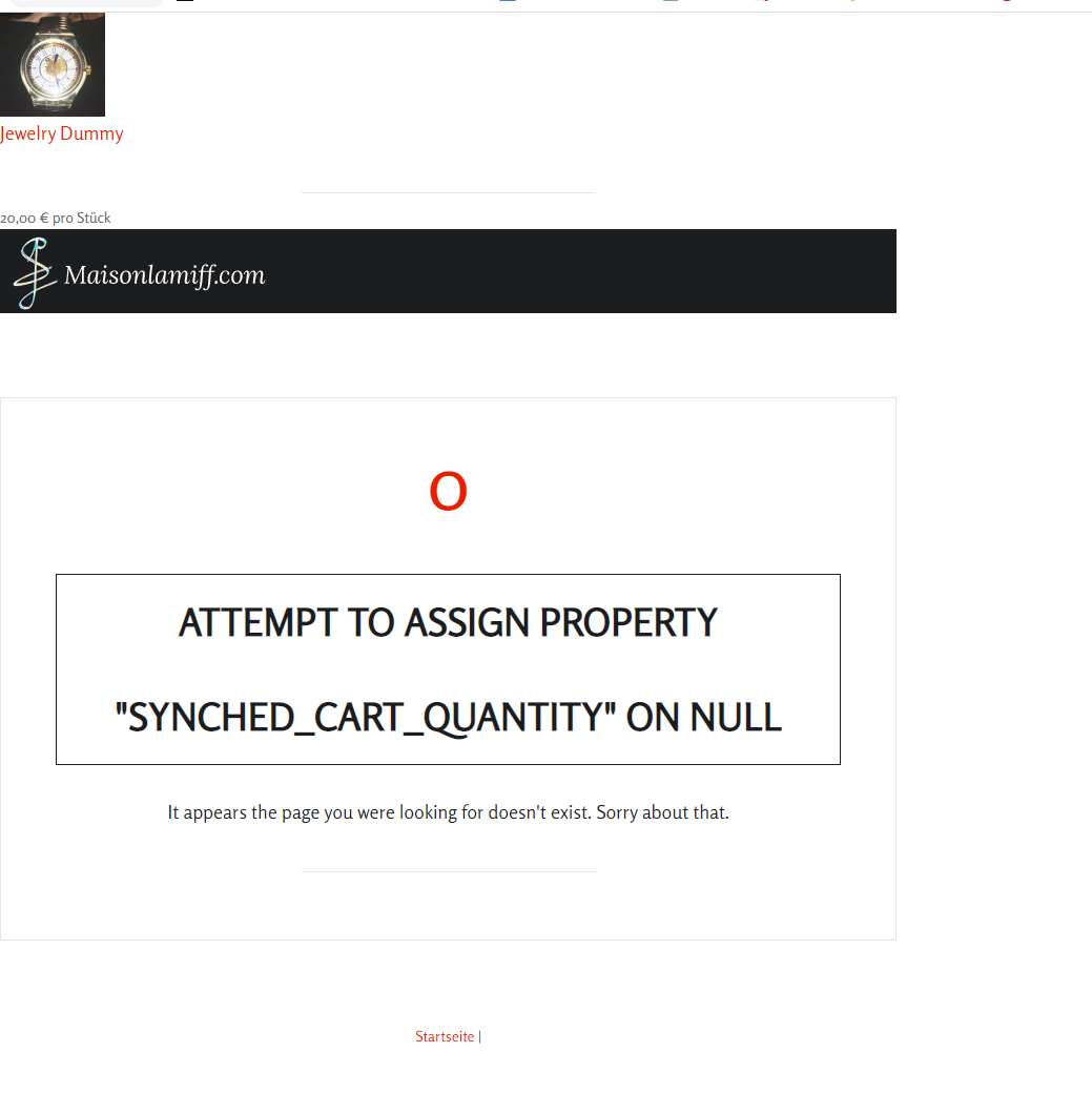

-- HikaShop version -- : 4.7.1
-- Joomla version -- : 4.2.8
-- PHP version -- : 8.0
-- Error-message(debug-mod must be tuned on) -- : ATTEMPT TO ASSIGN PROPERTY
"SYNCHED_CART_QUANTITY" ON NULL
when switching from PHP 7.4.x to 8.0 i get the error as shown in the screenshot.
I am using the "Storefront - eCommerce Joomla! template" storefront.demo.gavick.com/
When i switch back to PHP 7.4. and activate show php errors, i get:
Notice: Undefined property: ProductViewProduct::$row in .../components/com_hikashop/views/product/tmpl/show_quantity.php on line 60
Notice: Trying to get property 'product_id' of non-object in .../com_hikashop/views/product/tmpl/show_quantity.php on line 60
Warning: Creating default object from empty value in .../com_hikashop/views/product/tmpl/show_quantity.php on line 61
Best regards
Maurizio de Matteis
