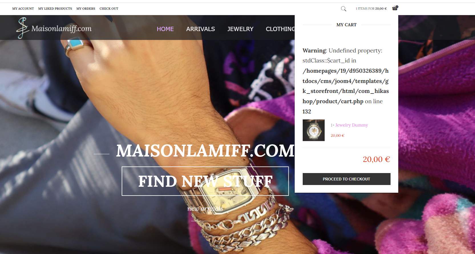

-- HikaShop version -- : 4.7.1
-- Joomla version -- : 4.2.8
-- PHP version -- : 8.x
-- Error-message(debug-mod must be tuned on) -- : Warning: Undefined property: stdClass::$cart_id in /homepages/19/d950326389/htdocs/cms/joom4/templates/gk_storefront/html/com_hikashop/product/cart.php on line 132
i have an error message in the cart module.
Thank you and with best regards
Maurizio
the code snippet:

This warning comes from the view override in your template.
This line is not in the default view file in HikaShop.
You could rename the file templates/gk_storefront/html/com_hikashop/product/cart.php to something else via FTP to deactivate the override, and that would fix the warning. However, you'll loose the look of your cart module.
You could also turn off the "error reporting" and "debug" settings of the joomla configuration (which should be the case normally on a live website, for security reasons) and that would hide the warning.
However, the best would be to provide the warning to your template provider's support and check with them what they recommend.
