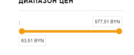

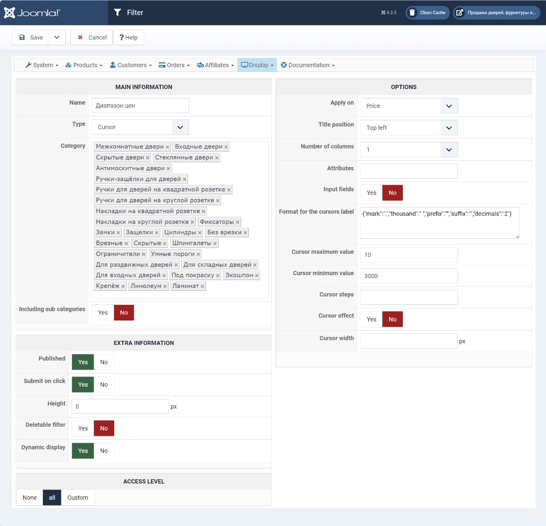

Hello, there was a problem with the price filter, it does not work correctly. Could you point out what I've set up wrong? How to make it so that it is filtered directly in the category where I am?

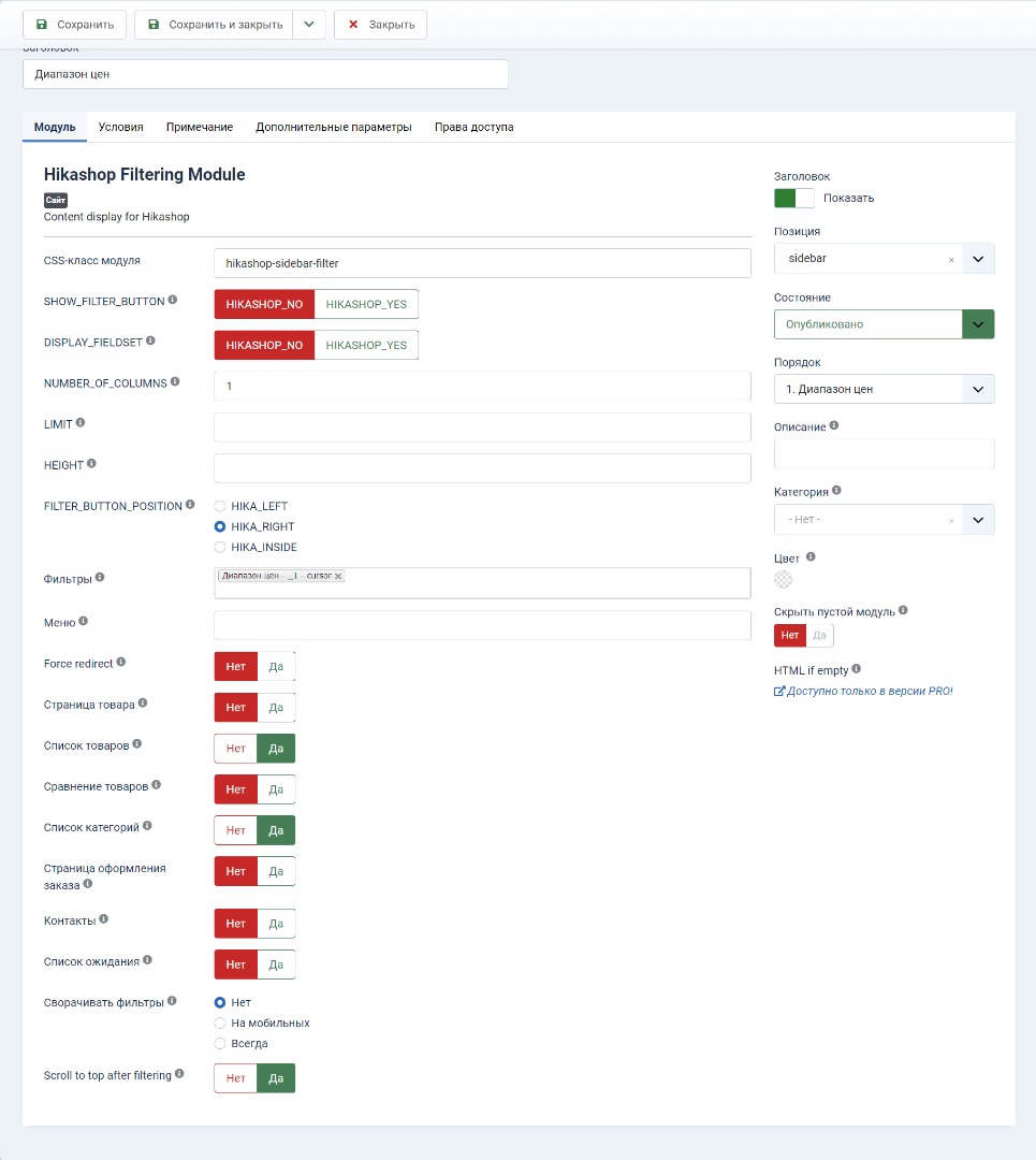

Here are the settings:

I looked at your link and when I use the price filter there, it filters the products on the right side and doesn't change the page or display products from other categories.
So it seems that your main question
is already solved. Or I didn't understand what you mean.

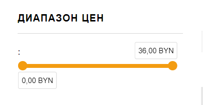

The price filter does not work. If you filter by price, it uses only one price for the filter. Try changing the values. ilsanmarket.by/katalog/linoleum.html
It doesn't even display correctly:

Ok, on that page I do see a problem indeed. The filtering is working, but the min and max values of the filter are wonky for some reason.
We would need a backend and a FTP access in order to investigate.
Could you provide that via our contact form ?

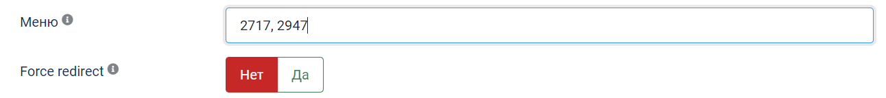

Hello, is it possible to display menu items in the module settings separated by commas?
I tried to enter one menu item and several separated by commas, it still does not work

Regarding the "menu" setting of the filter module, you can only enter the id of one menu item.
Also, it will only be used when the current page is not a products listing, or, if you have the "force redirect" setting below activated, it will also redirect to that menu item if the current menu item is not the one with that id.

Please understand that this kind of issue is quite complex to debug. It took me several hours today to debug it, and I also had many other messages to answer to from other users.
I found that the issue is linked to improvements we've made to the dynamic filters in the 4.7.4:
Filters with their "dynamic display" setting turned on will now keep their values once they are used until the filters are reset.
www.hikashop.com/support/documentation/5...ashop-changelog.html
I've made a few patches on your website and did some tests and it seems to work fine now.
We'll include these patches on our end for the next version of HikaShop.
Thanks for your cooperation.

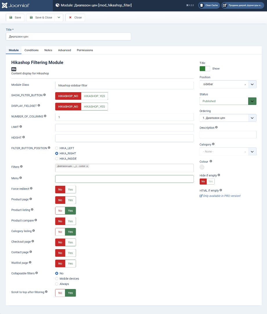

  • Posts: 85726
  • Thank you received: 14054
2 years 9 months ago #355025
I'm sorry but I don't see any problem on your links. Could you explain what problem you're seeing there ?
And what is the link with the new screenshot of the filter module settings ?

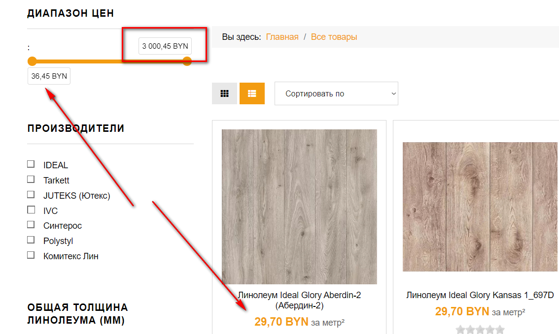

Hello. I wanted to clarify why in this category the filter starts with the minimum price of the product, and in another category it starts with “0”?
  • Posts: 85726
2 years 9 months ago #355038
Doesn't that mean that you have a product without a price set in it ?
The system will load the price of each product on the listing to calculate the minimum and maximum.
It could be that the product doesn't have prices (for example, if you only set the price of that product in the different variants).
  • Posts: 220
  • Thank you received: 10
2 years 9 months ago #355077
That's right, there is one. I made this product to order
  • Posts: 85726
2 years 9 months ago #355082
Then it's normal, right ? What is your question then ?
