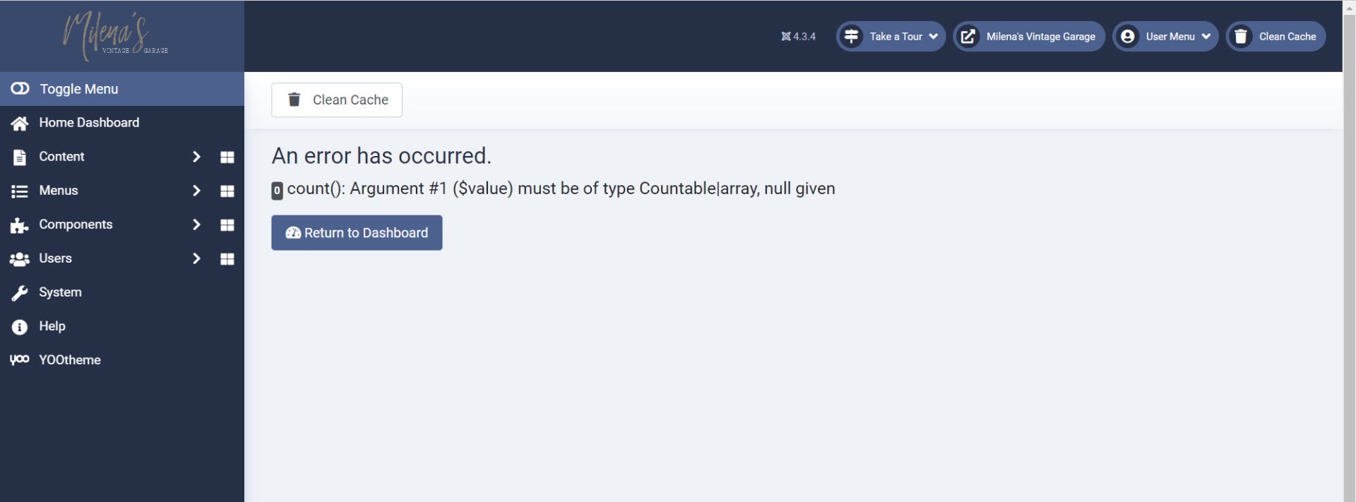

2 years 11 months ago #355290
-- HikaShop version -- : 5.0.0
-- Joomla version -- : 4.3.4
-- PHP version -- : 8.1
-- Error-message(debug-mod must be tuned on) -- : An error has occurred.
0 count(): Argument #1 ($value) must be of type Countable|array, null given

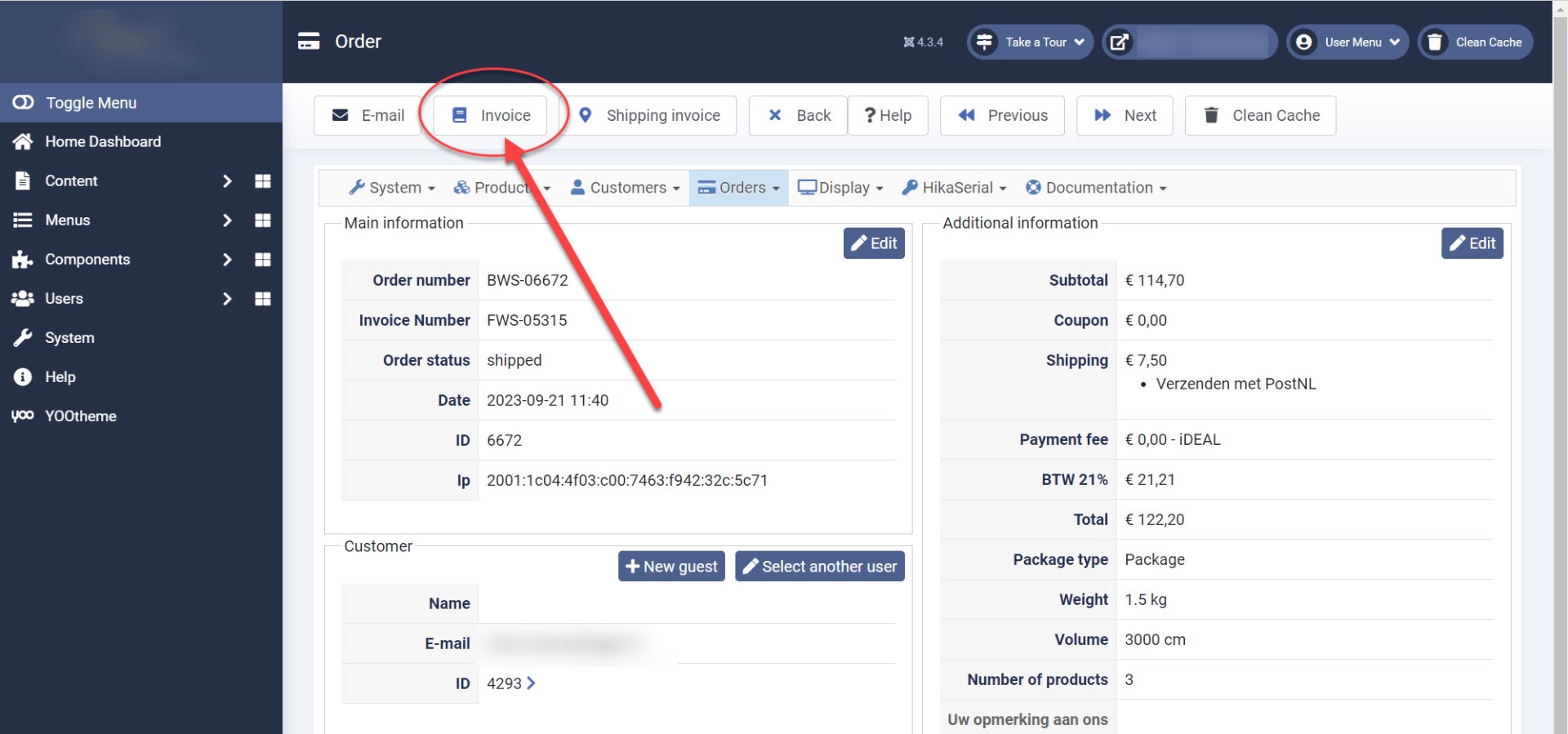

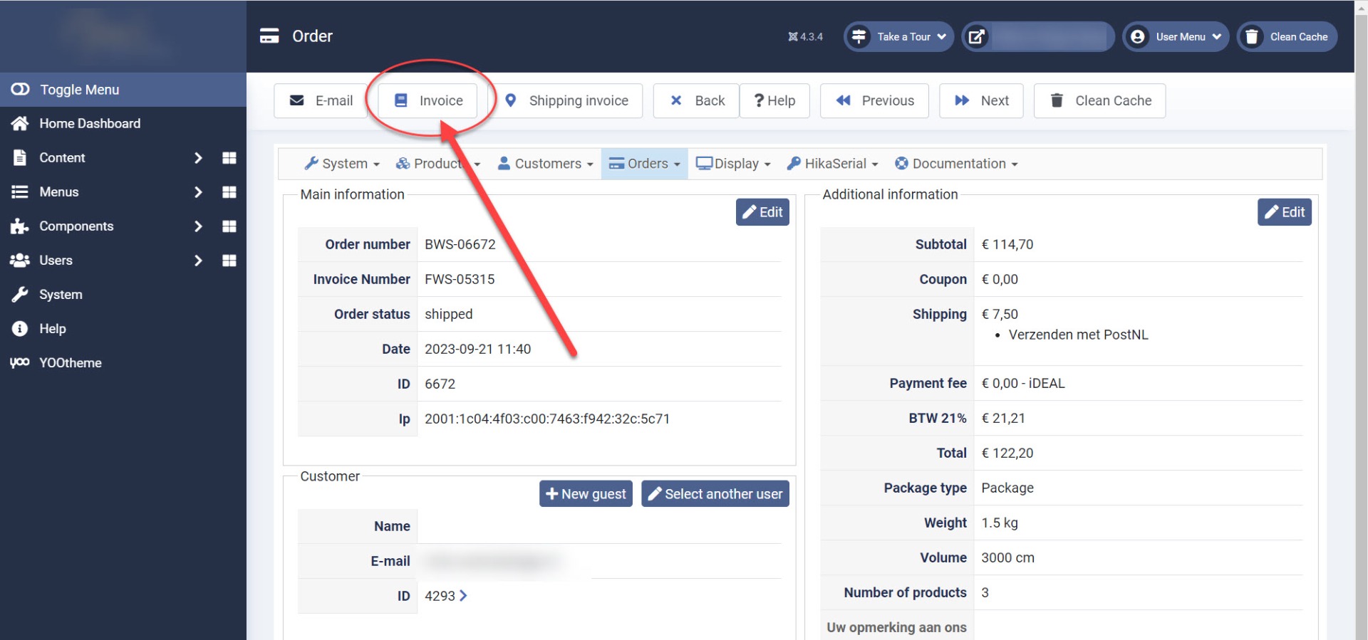

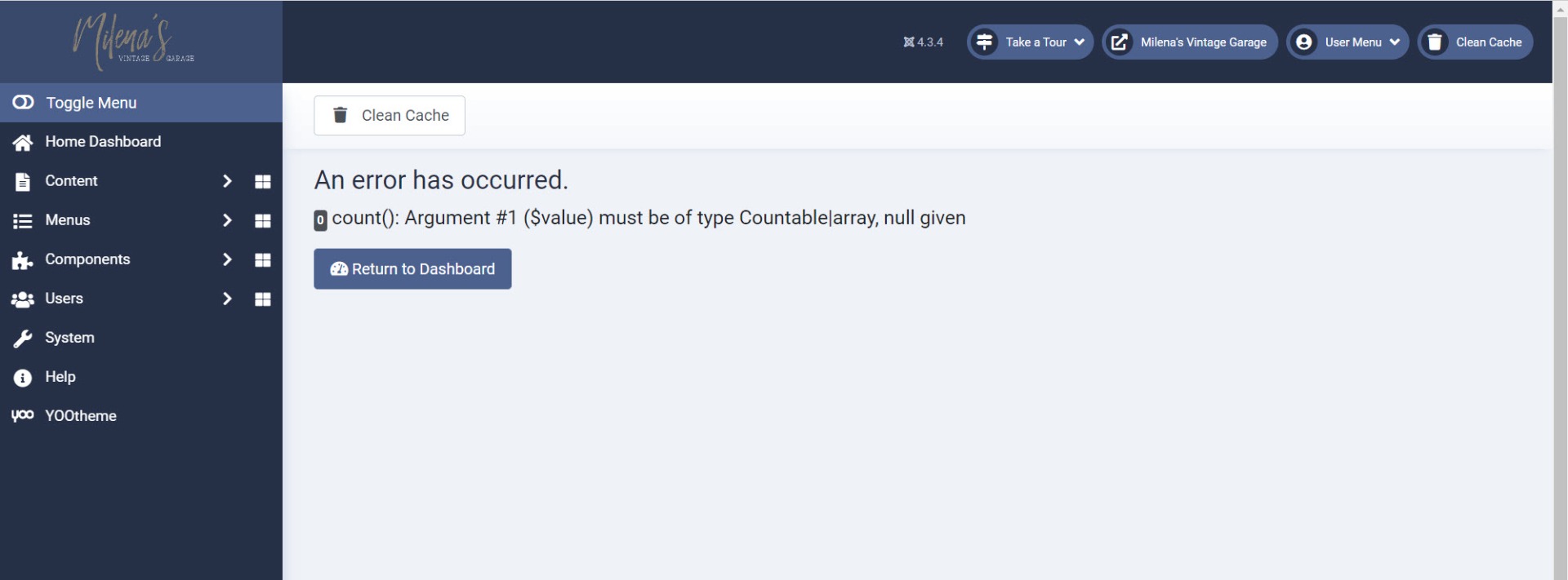

Hi Support,
Webshop is updated to version 5.0.0.

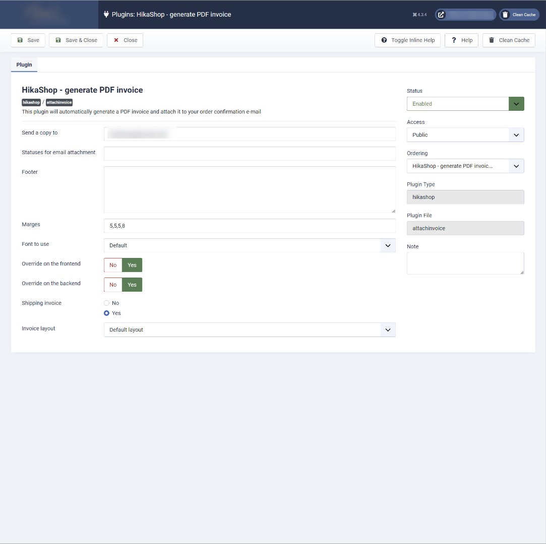

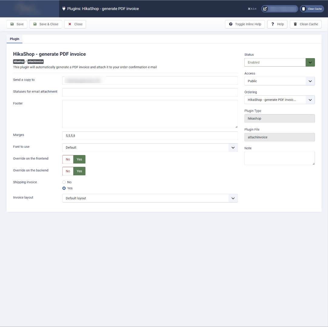

Also PDF invoice-plugin is paid and downloaded yesterday and installed and configurated.
But when we want to create a invoice we get an error!

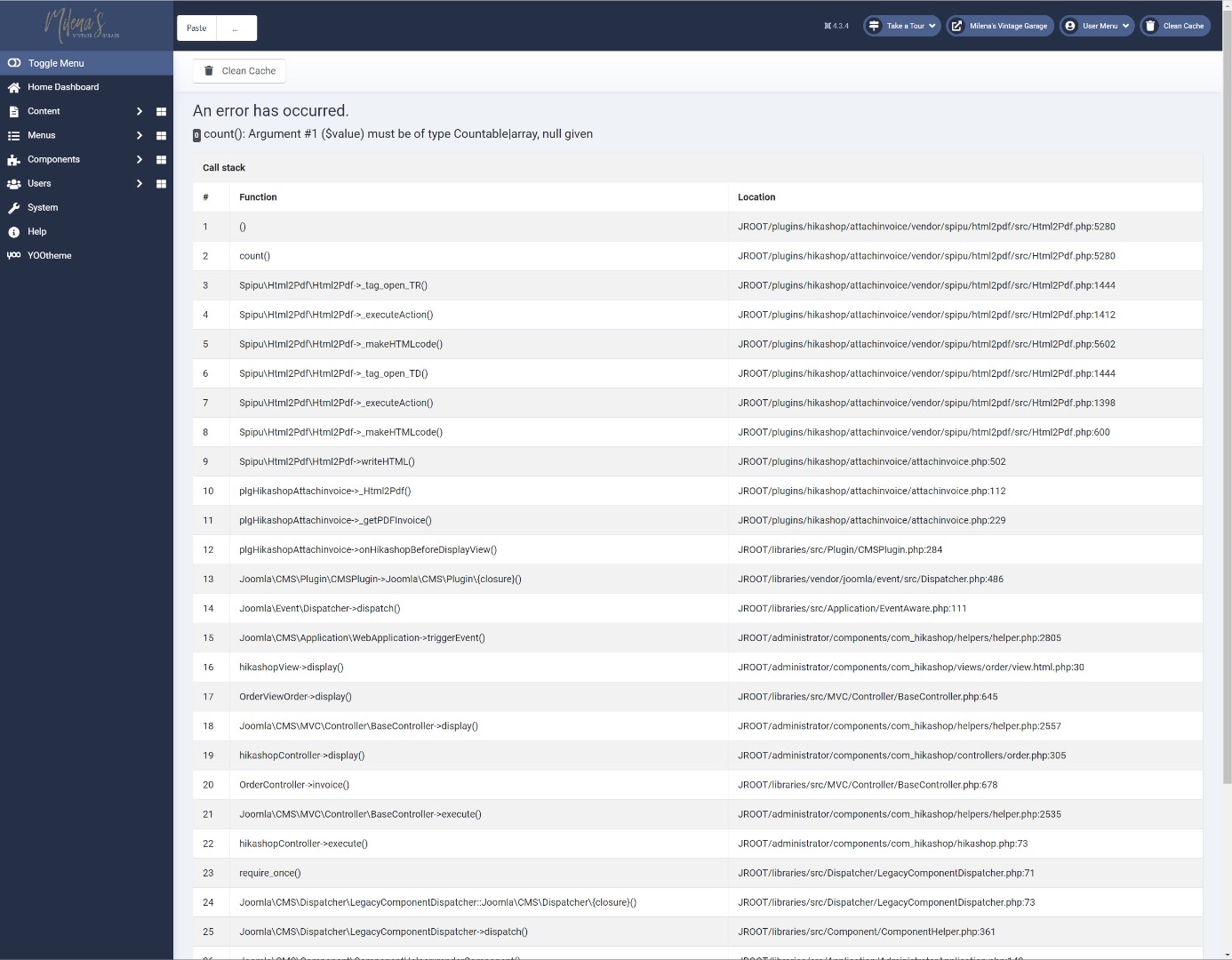

When we turn on Debug system we see this:
The PDF invoice plugin is configured this way:
Here the error in text:
Call stack

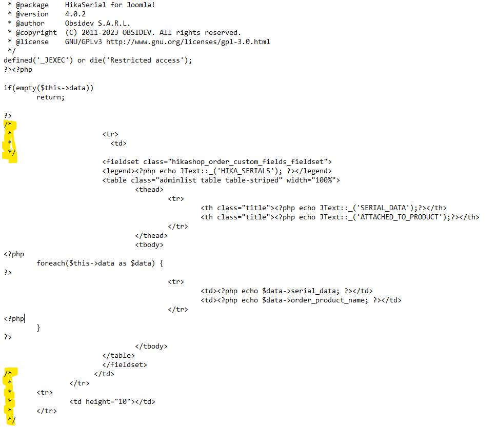

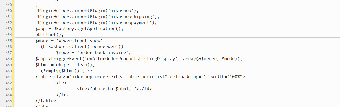

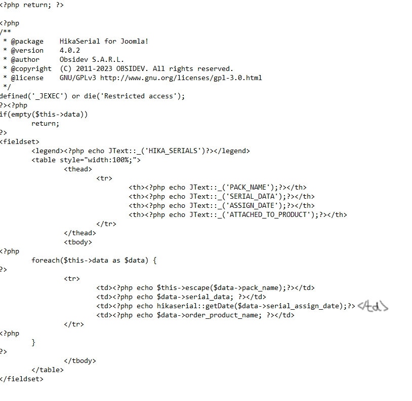

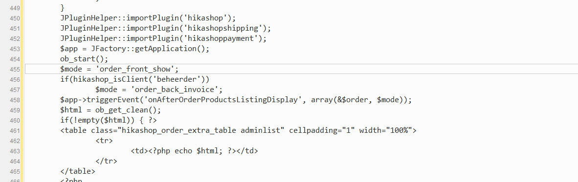

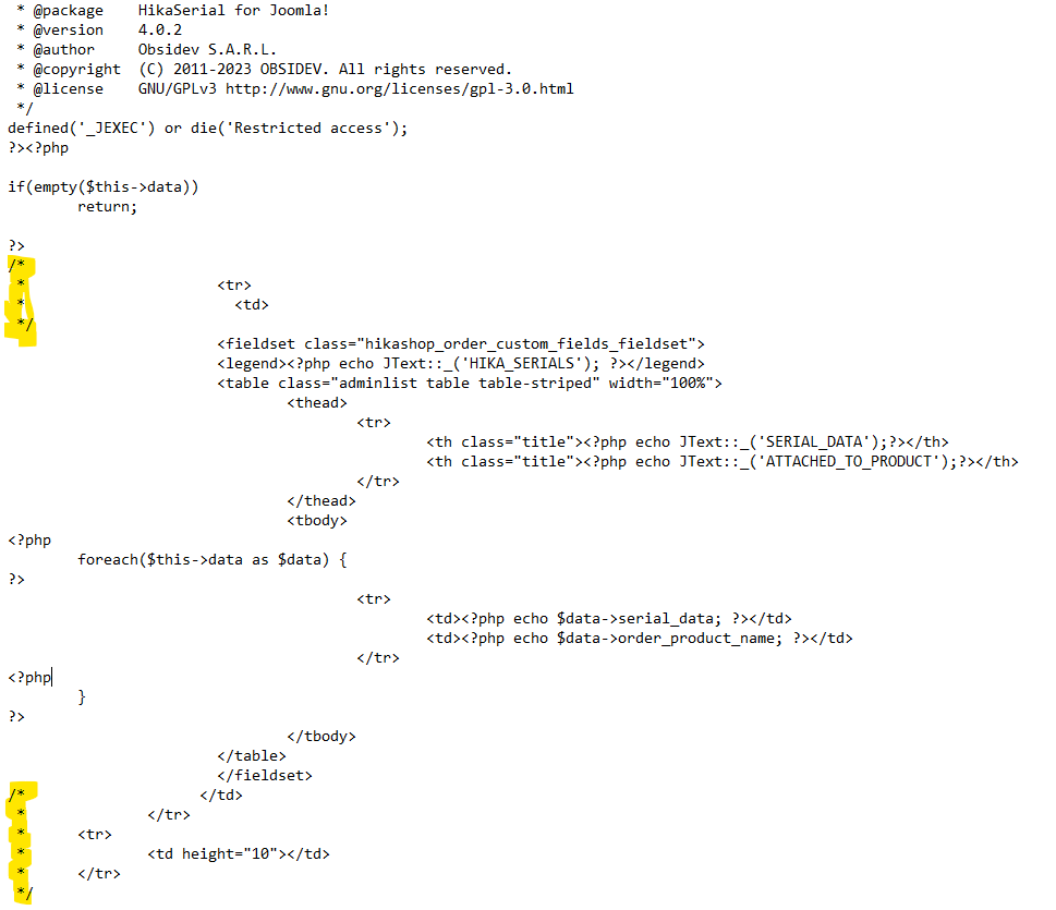

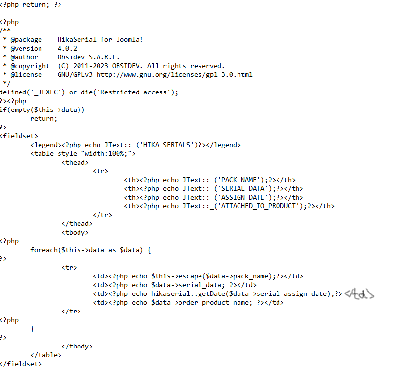

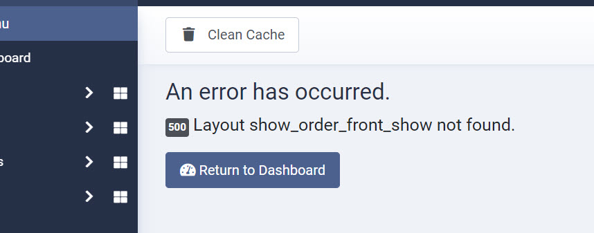

2 years 11 months ago #355298
We have added the code from issue:
www.hikashop.com/forum/5-support-en-fran...-invoice.html#355250
But that didn't work.
We now see this error!
Here the changed code:
Kind regards,
Lumiga

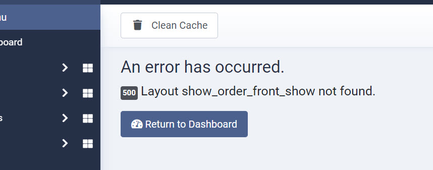

  • Posts: 637
  • Thank you received: 26
2 years 11 months ago #355299
Debug mode on:
500 Layout show_order_front_show not found.
Call stack
# Function Location
1 () JROOT/libraries/src/MVC/View/HtmlView.php:420
2 Joomla\CMS\MVC\View\HtmlView->loadTemplate() JROOT/administrator/components/com_hikaserial/helpers/helper.php:956
3 hikaserialView->loadTemplate() JROOT/libraries/src/MVC/View/HtmlView.php:203
4 Joomla\CMS\MVC\View\HtmlView->display() JROOT/administrator/components/com_hikaserial/helpers/helper.php:805
5 hikaserialView->display() JROOT/administrator/components/com_hikaserial/views/orderserial/view.html.php:22
6 orderserialViewOrderserial->display() JROOT/administrator/components/com_hikaserial/helpers/helper.php:230
7 hikaserial::getLayout() JROOT/plugins/hikashop/serials/serials.php:358
8 plgHikashopSerials->onAfterOrderProductsListingDisplay() JROOT/libraries/src/Plugin/CMSPlugin.php:284
9 Joomla\CMS\Plugin\CMSPlugin->Joomla\CMS\Plugin\{closure}() JROOT/libraries/vendor/joomla/event/src/Dispatcher.php:486
10 Joomla\Event\Dispatcher->dispatch() JROOT/libraries/src/Application/EventAware.php:111
11 Joomla\CMS\Application\WebApplication->triggerEvent() JROOT/plugins/hikashop/attachinvoice/attachinvoice/invoice.php:458
12 require() JROOT/plugins/hikashop/attachinvoice/attachinvoice.php:99
13 plgHikashopAttachinvoice->_getPDFInvoice() JROOT/plugins/hikashop/attachinvoice/attachinvoice.php:229
14 plgHikashopAttachinvoice->onHikashopBeforeDisplayView() JROOT/libraries/src/Plugin/CMSPlugin.php:284
15 Joomla\CMS\Plugin\CMSPlugin->Joomla\CMS\Plugin\{closure}() JROOT/libraries/vendor/joomla/event/src/Dispatcher.php:486
16 Joomla\Event\Dispatcher->dispatch() JROOT/libraries/src/Application/EventAware.php:111
17 Joomla\CMS\Application\WebApplication->triggerEvent() JROOT/administrator/components/com_hikashop/helpers/helper.php:2805
18 hikashopView->display() JROOT/administrator/components/com_hikashop/views/order/view.html.php:30
19 OrderViewOrder->display() JROOT/libraries/src/MVC/Controller/BaseController.php:645
20 Joomla\CMS\MVC\Controller\BaseController->display() JROOT/administrator/components/com_hikashop/helpers/helper.php:2557
21 hikashopController->display() JROOT/administrator/components/com_hikashop/controllers/order.php:305
22 OrderController->invoice() JROOT/libraries/src/MVC/Controller/BaseController.php:678
23 Joomla\CMS\MVC\Controller\BaseController->execute() JROOT/administrator/components/com_hikashop/helpers/helper.php:2535
24 hikashopController->execute() JROOT/administrator/components/com_hikashop/hikashop.php:73
25 require_once() JROOT/libraries/src/Dispatcher/LegacyComponentDispatcher.php:71
26 Joomla\CMS\Dispatcher\LegacyComponentDispatcher::Joomla\CMS\Dispatcher\{closure}() JROOT/libraries/src/Dispatcher/LegacyComponentDispatcher.php:73
27 Joomla\CMS\Dispatcher\LegacyComponentDispatcher->dispatch() JROOT/libraries/src/Component/ComponentHelper.php:361
28 Joomla\CMS\Component\ComponentHelper::renderComponent() JROOT/libraries/src/Application/AdministratorApplication.php:143
29 Joomla\CMS\Application\AdministratorApplication->dispatch() JROOT/libraries/src/Application/AdministratorApplication.php:186
30 Joomla\CMS\Application\AdministratorApplication->doExecute() JROOT/libraries/src/Application/CMSApplication.php:293
31 Joomla\CMS\Application\CMSApplication->execute() JROOT/administrator/includes/app.php:61
32 require_once() JROOT/administrator/index.php:32
Kind regards,
Lumiga

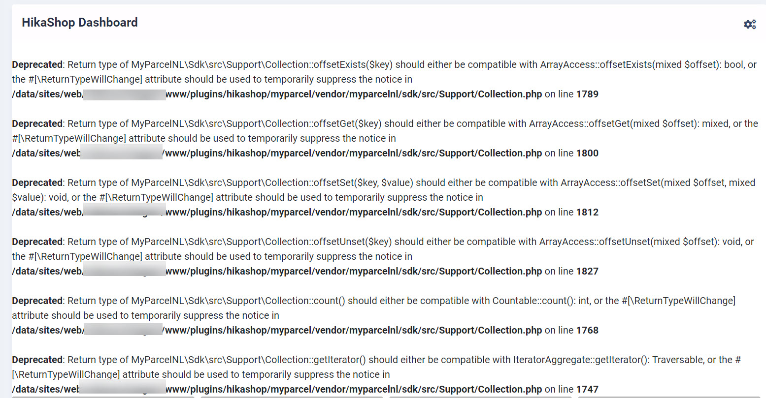

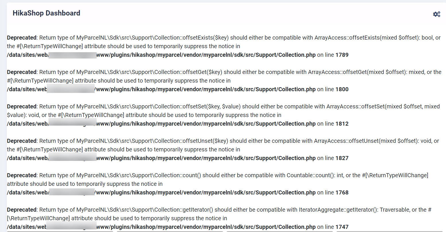

  • Posts: 86112
  • Thank you received: 14210

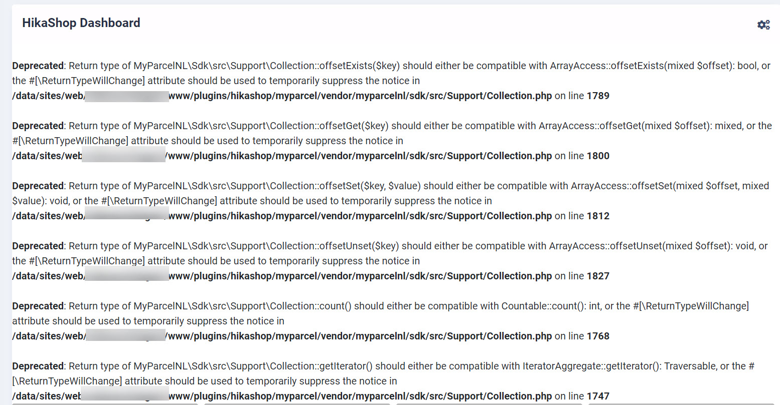

2 years 11 months ago #355293
Please open different threads for different issues next time.
1. I don't get the error with a fresh install of HikaShop 5 and the latest version of the PDF invoice plugin on PHP 8.2.
Also, the error message seems to indicate that there is a problem with the HTML provided (something to do with invalid HTML in a table or tr or td). Did you customize the invoice layout of the PDF plugin in the past ?
2.
If you still see the messages with MyParcel, it means that you're not using the latest version. Please double check.
Following your other thread here www.hikashop.com/forum/install-update/90...myparcel-plugin.html we did made a new release of both MyParcel plugins specifically to include the changes suggested.
I just checked to make sure at the plugins do have the changes:
i.imgur.com/JNt8QGT.png
Open the file pointed at by the deprecated messages and search for ReturnTypeWillChange
You should find these.
Also, check the version number of the plugin in the extensions manager, it should be 1.1.7
3. You modified the code from the other thread and changed "administrator" to something in another language. That's why it doesn't work.
Last edit: 2 years 11 months ago by nicolas.

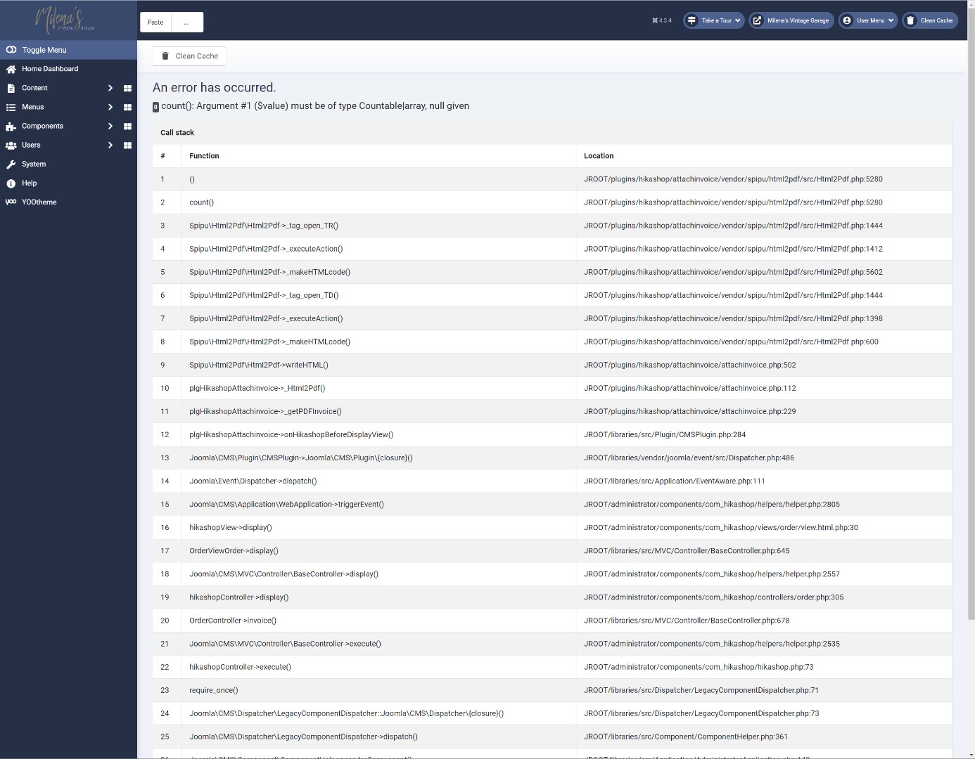

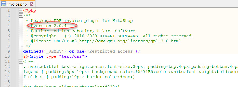

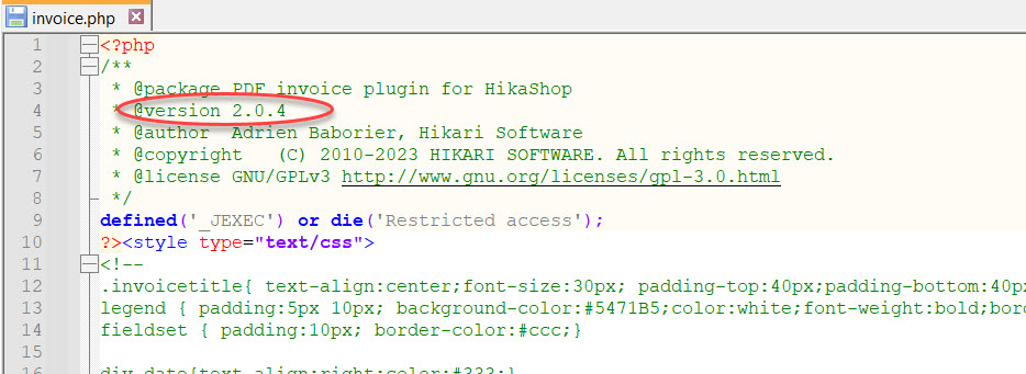

2 years 11 months ago #355306
1.
I can confirm that two other websites don't have issues.
However, I am unsure why this website still presents issues.
I've reinstalled Hikashop 5.0.0 and deleted the PDF invoice plugin before installing it again.
I can confirm it's version 2.0.4 now, as you can see in the screenshot.
I made changes in the past to /plugins/hikashop/attachinvoice/attachinvoice/invoice.php,
but I've since deleted everything, and even with the default code, I encounter this error.
I will send you the login credentials and hope you can take a look.

Indeed, I didn't have the latest version of MyParcel. Now, with the latest version, deprecated errors are gone. Thanks!
3.
I don't know why that happened (maybe automatic translation somewhere), but now we used the latest version, 2.0.4. However, we still have this issue, see point one.

  • Posts: 86112
2 years 11 months ago #355324
The issue is like this:
- in the recent version of the PDF invoice plugin, we've added support to the onAfterOrderProductsListingDisplay event of HikaShop so that third party extensions can add extra information to the invoice, similarly to what's already in the HTML invoice in HikaShop.
- HikaSerial does implement that event. However, due to a mistake in past versions of HikaShop, it adds extra tr/td tags to the HTML returned to the event.
- We fixed HikaShop in the past, which led to the invoice generated with HikaSerial data in it having invalid HTML code. However, browsers are quite tolerant with that kind of issue and no one saw the problem with it.
- So when we added the support of that event in the PDF invoice plugin, we used the same code than in HikaShop. However, HikaSerial still outputs HTML which leads to an invalid HTML. And the library we use in the PDF invoice plugin to convert the HTML to PDF is way less tolerant with invalid HTML. Because of this, you end up with the errror you reported in the HTML2PDF library when parsing the HTML of the invoice.
In order to fix the issue on your website, I've manually edited the file /administrator/components/com_hikaserial/views/orderserial/tmpl/show_order_back_invoice.php and removed the tr/td tags around the fieldset tag.
I've notified Jerome, who is in charge of HikaSerial, so that he can take this feedback into account for the next version of HikaSerial.

Same error here.
I changed the file administrator/components/com_hikaserial/views/orderserial/tmpl/show_order_back_invoice.php
But still receive the error

  • Posts: 9
2 years 10 months ago #356467
I remarked all <tr> and <td>'s outside the <fieldset> from the code, see the attachment
I use Joomla! 4.4.0 Stable [ Pamoja ] 17-October-2023 16:00 GMT
HikaShop Business: 5.0.0
HikaSerial 4.0.2
HikaShop - generate PDF invoice 2.0.4

It could be that it is actually another view file which is used and that the error you have doesn't come from this file on your website.
Try adding :
<?php return; ?>
at the beginning of administrator/components/com_hikaserial/views/orderserial/tmpl/show_order_back_invoice.php
If you still have the issue after this change, then it means that the problem you have is not in administrator/components/com_hikaserial/views/orderserial/tmpl/show_order_back_invoice.php on your website but somewhere else.
It could for example be that you have a view override for that file in your Joomla template in administrator/templates/YOUR_TEMPLATE/html/com_hikaserial/orderserial/show_order_back_invoice.php
And in that case, it's this override file you want to modify.
  • Posts: 9
2 years 10 months ago #356484
<?php return; ?> didn't help; so its not in the serial module
I also looked for a file
but I do not have that.
Is there a way to show the html of the invoice just before it is sent to the pdf generator?

  • Posts: 9
2 years 10 months ago #356485
Extra information:
From the backend (administrator dashboard) opening the invoice works now!
From the frontend (customer order details form) the printing fails
When ordering the system is not sending an email with the invoice.

  • Posts: 9
2 years 10 months ago #356498
Yes found it!
In the file components/com_hikaserial/views/orderserial/tmpl/show_order_front_show.php
was a missing </td>, see attchment
