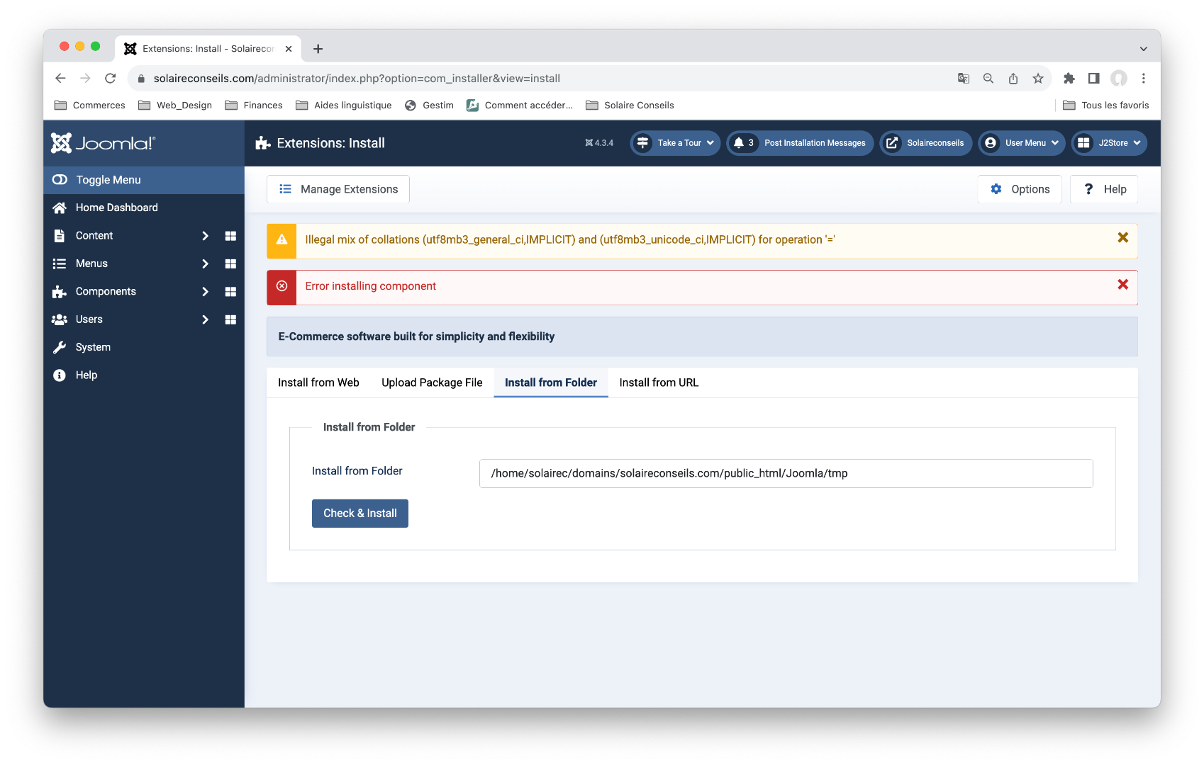

-- HikaShop version -- : 5.0
-- Joomla version -- : 4.3.4
-- PHP version -- : 8.2
-- Browser(s) name and version -- : chrome 17.0.5938.132
-- Error-message(debug-mod must be tuned on) -- : Warning: Illegal mix of collations (utf8mb3_general_ci, IMPLICIT) and (utf8mb3)unicode)ci, IMPLICIT) for operation ‘=‘
Error installing component
Got this message when trying to install Hikashop Starter 5.0.
Only database tables was created and the Hikashop extension in administer folder.

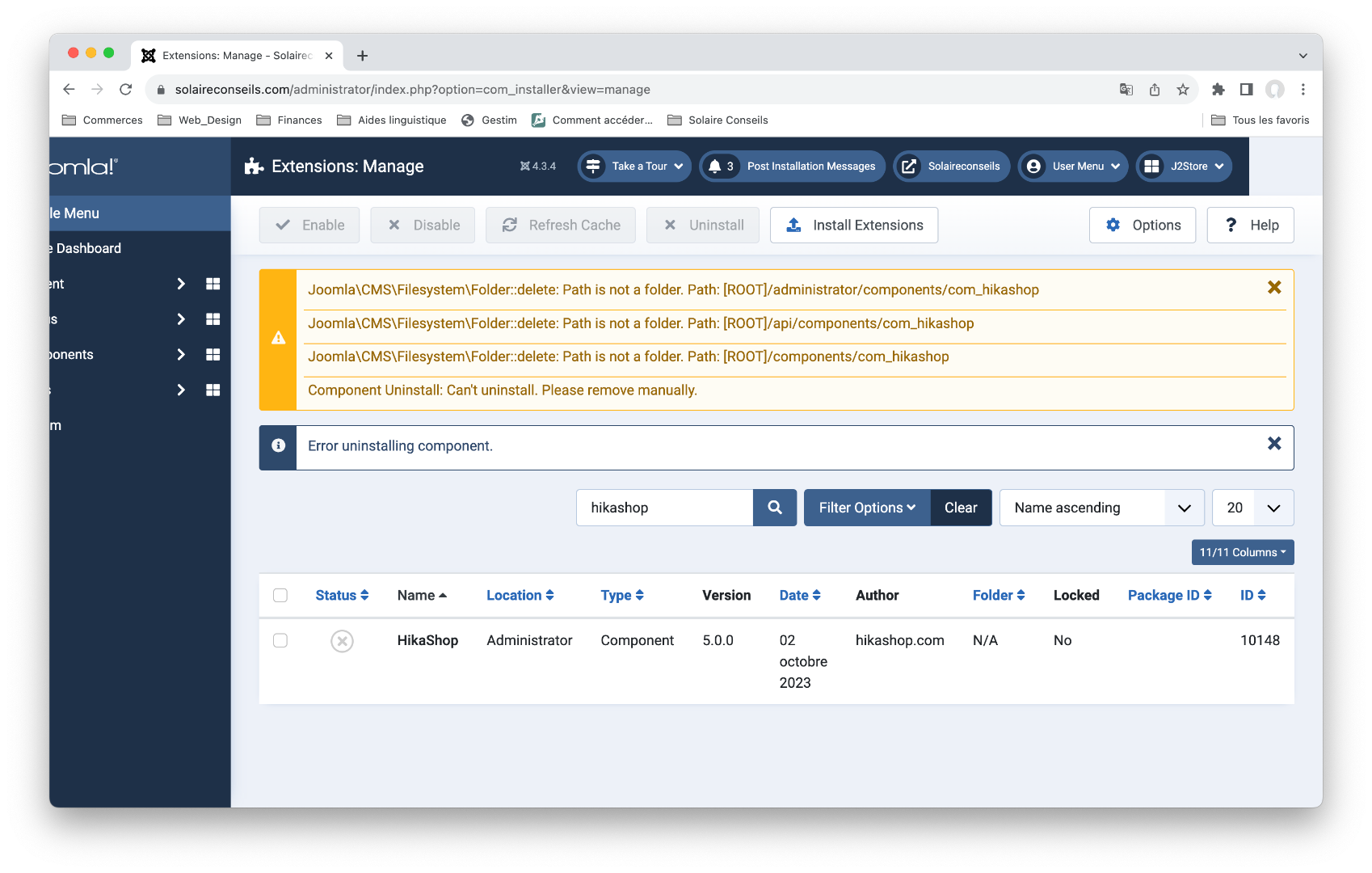

I droped all the Hikashop tables from the DB and tried to uninstall the extension to do a clean install from the ftp as suggested in some articles.
Got an error with a message saying: can’t uninstall, please remove manually. I checked in all the folders listed in the message and no com_hikashop exist there but Joomla still show the extension.
I decided to manually created these com_hikashop folders and redo the Extension uninstall process. Joomla removed all the folders but I got a new message like din’t find Filesetup.XML.
Finally I moved forward with the FTP installation with exactly the same result
I don’t know what else to do to try to fix this issue. If somebody have an idea, you’re welcome.

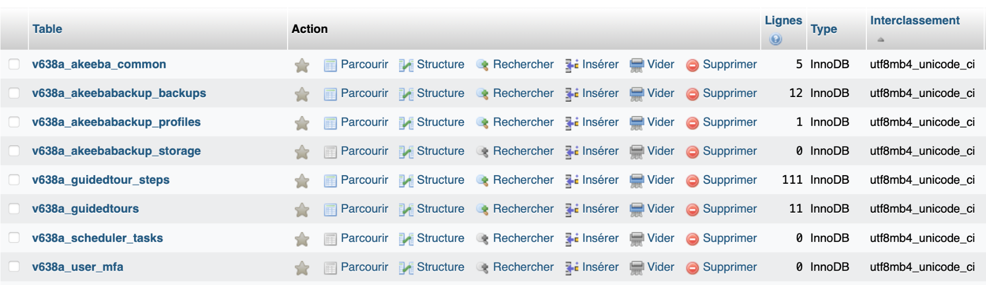

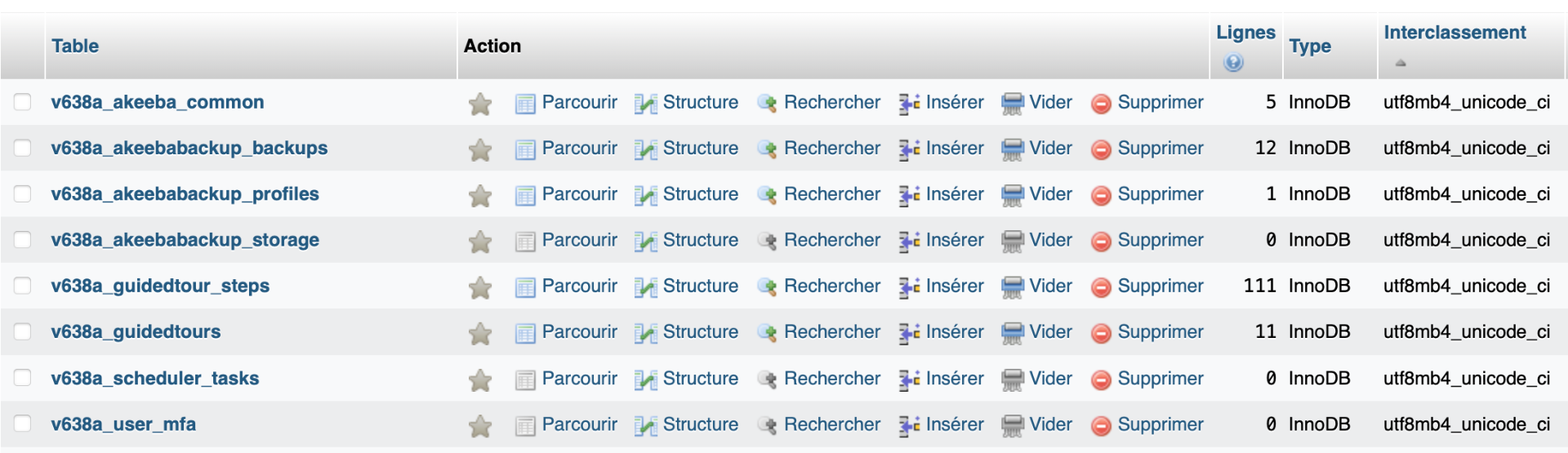

I just checked My database and All the tables including the ones Hikashop created have utf8mb3_general_ci charset except 8 tables including 4 from Akeebabackup that use utf8mb4_unicode_ci. Furthermore, the server connection collation charset is set to utf8mb4_unicode_ci. Nothing about utf8mb3_unicode_ci Charset from the conflict message!!!!
Do I have to change something on these?

The error message says that there is a problem between utf8mb3_general_ci and utf8mb3_unicode_ci
So tables with utf8mb4_unicode_ci should not be linked to the issue.
Note also that in each table, each column can have a different collation. So it's not just the collation of the tables you need to check but the collation of the columns in each table.
It's possible that some tables have the collation utf8mb3_general_ci but that some columns in them have the collation utf8mb3_unicode_ci and when HikaShop runs one of its MySQL queries between two columns, it creates that error because of the different collation of the columns.
I would first check the columns of the users table of Joomla against the columns of the hikashop_user table.
