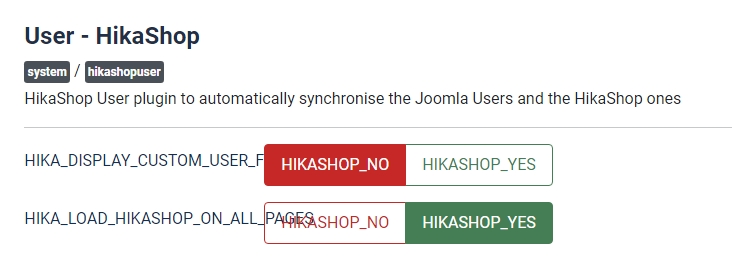

  • Posts: 7
2 years 9 months ago #356701
There is one small progress.
After deleting the code, the Frontend is working, except the "Contact form". The Contact form is broken - gives this error (again number 2)
0 - Too few arguments to function plgSystemHikashopuser::onContentPrepareForm(), 1 passed in /home/www/ ... /domains/ ... /www/administrator/components/com_hikashop/pluginCompatJ4.php on line 58 and exactly 2 expected
Backend (Plugins settings) is still broken and I can't access anything while the plugin is enabled.
If it helps, when I open the User synchronization plugin, I can see this:
  • Posts: 86112
