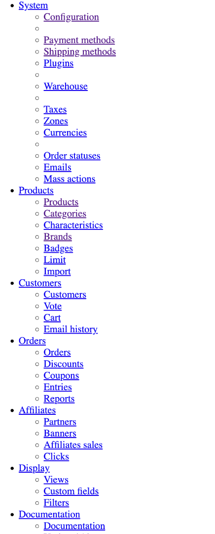

Recently updated to Joomla 4 and at some point admin for Hikashop ahs lost all styling. Backends for other Joomla components are fine.

Your screenshot indicates that there is a fatal error.
Activate the "debug" setting of the Joomla configuration and reproduce the error.
Then, look at the bottom of the page and you'll see the error message which will indicate where the problem is.
With it, we'll be able to tell you what to do.

Not sure what was going on yesterday , possibly some sort of caching issue, but I am now getting an error message indicating crashed table.
Repaired hikashop_cart table and all is ok now.
