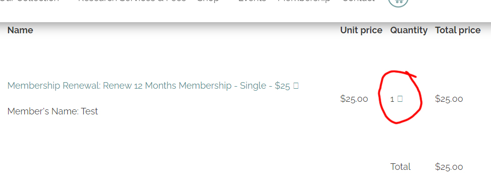

Hi, I need to show the icon to remove items from the cart as a trash can. At the moment it only displays as a small click box.
I added this to the frontend css, but it made no difference:
.hikashop_checkout_cart .fa-times-circle:before {
    content: "\f1f8" !important;
How can I show a trash can icon in the checkout?

2 years 8 months ago #358107
Screenshots attached.

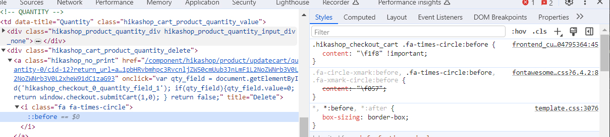

2 years 8 months ago #358119
Without being able to directly look at the situation in more depth (the URL to the website would have been great in that respect), it looks like you might have the same problem as here:
www.hikashop.com/support/forum/5-support...s/357244.html#357222
Here is the text of that message in English:
In HikaShop, we have version 5.2.0 of fontawesome which allows you to display icons.
Previously, we loaded this version included in HikaShop, and it was possible to change a hidden option in the database, so as not to load it (in case the template had a more recent version of fontawesome).
As this version is now rather old, on Joomla 4 and Joomla 5, we now ask Joomla to load fontawesome for us with the code:
[coded]
$wa = $doc->getWebAssetManager();
$wa->useStyle('fontawesome');
[/coded]
Locally, on our test sites, when we check the result, it is the file /media/system/css/joomla-fontawesome.css?2865f3 which is loaded by Joomla 5 and the icons are displayed correctly.
On your site, I see that you are also on Joomla 5, but it is the file /media/vendor/fontawesome-free/css/fontawesome.min.css?6.4.2 which is used, instead of the file which is used on our side, despite the fact that you also have this file present (it is just not loaded on your pages).
So, I'm not an expert on fontawesome, but from what I see, the CSS that initializes the font for fontawesome seems to be missing in the file that is used on your site. Below is a capture of the code in the file on our side, which is missing in your fontawesome file:
i.imgur.com/dRaJZCY.png
I'm not sure of anything, but it smells like a problem in the template you are using (or a system plugin) that would load its fontawesome version instead of using the Joomla one, and there will be a problem with it.
Try switching to the default Joomla template to see if you still have the problem. If this is displayed correctly, then you will need to contact support for your template. If this still does not display correctly, then you should see if you have a system plugin related to fontawesome.
Note also that further to this, we got some feedback by someone else that if you're using a template made with Template Creator, it has a setting to fix this:
www.hikashop.com/support/forum/install-u...ec-5-0-2.html#358043
since Cédric K's Template Creator, there is this function which was in auto mode, but by putting the upload of these fonts in "yes mode" so in forced mode everything works again: it's just happiness!!!! !

  • Posts: 86112
  • Thank you received: 14210
2 years 8 months ago #358148
My bad, I missed it.
So I checked today, and it's indeed the same problem I was talking about.

2 years 8 months ago #358173
Basically, what their message means is that the problem is not in the template and it must be because HikaShop doesn't load fontawesome.
But I already wrote above that HikaShop does ask joomla to load fontawesome. I've even provided the code. So that means they probably didn't read my message.
The first thing to do is to not believe neither them nor me and try something simple:
Switch temporarily to the Cassiopeia template and see if you have the icons displaying.
If you do (like it does on our end with Joomla 5 and Cassiopeia), then the template has to be involved in the problem and there is probably something which can be done in the template to avoid that issue.
If you still don't see the icons with the default template, then it means the problem is probably linked to another extension, like a module or system plugin. In that case, it would be good to first identify what is generating the problem by disabling the modules / plugins one by one.
