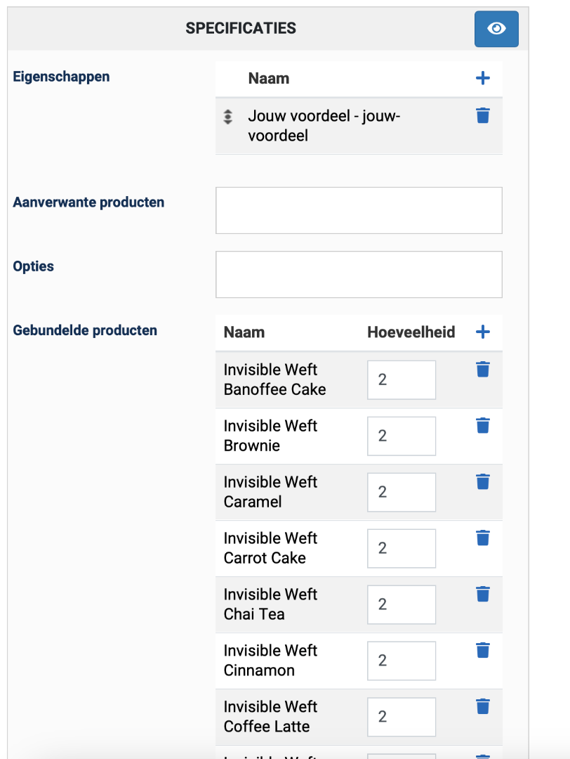

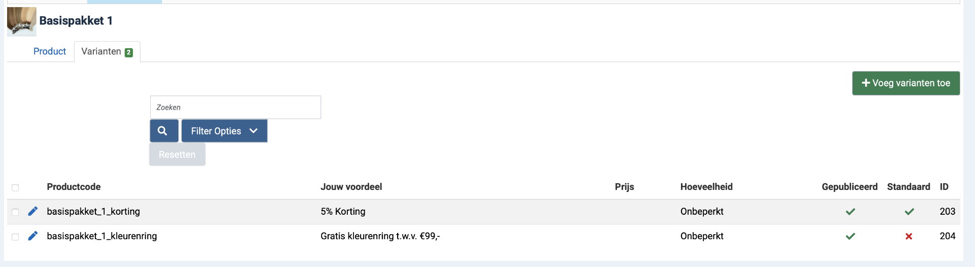

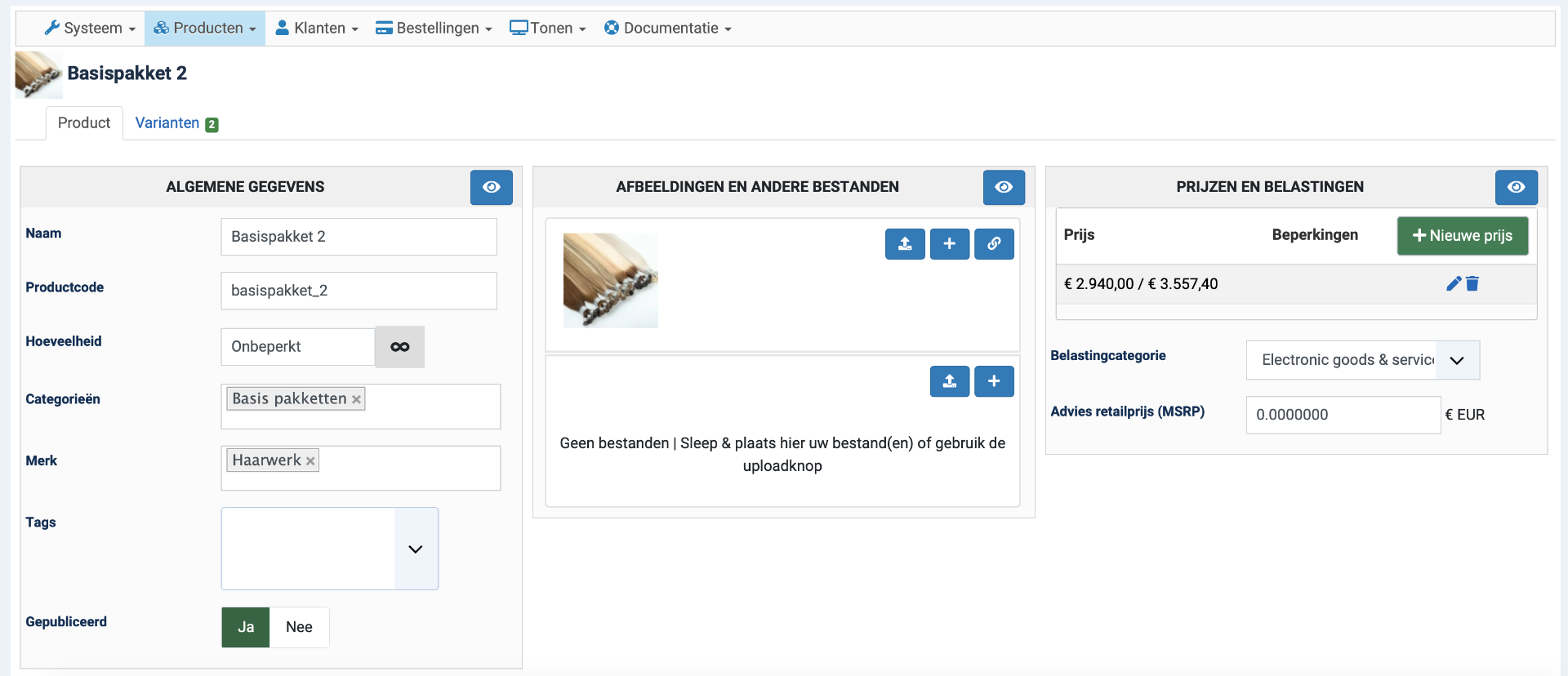

I have a product that has 2 variants because you have an option to get a free product or discount.
This product has 21 bundled products linked to it.
When i order the product the stock of those 21 products is not updated. WHat am i doing wrong?
See attache screenshots for configuration
