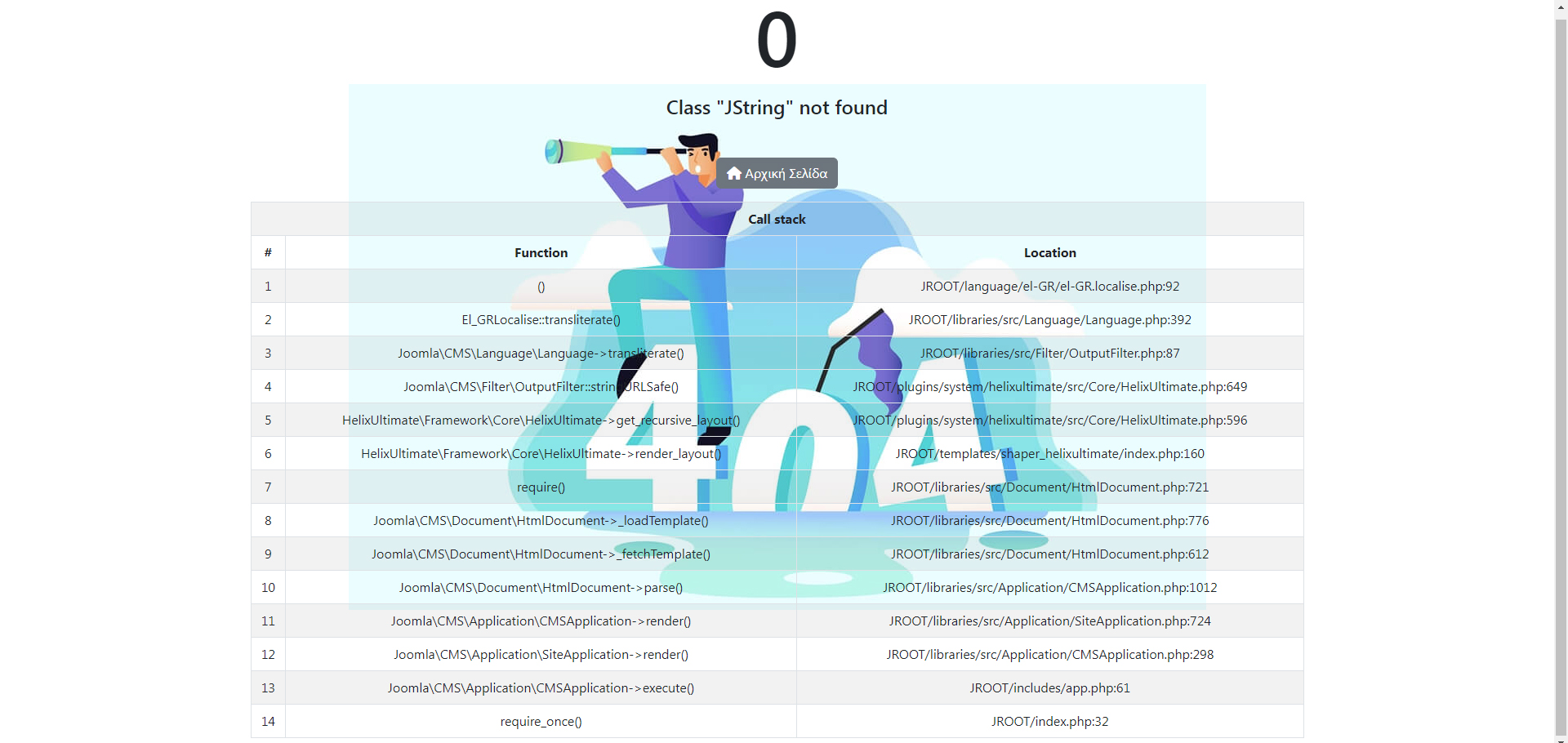

I upgraded to Joomla 4 from Joomla 3 and i'm facing issues at the checkout page.
At the last step of checkout, i click the finish order button and i get an error screen "Call to undefined method Joomla\CMS\Application\SiteApplication::isAdmin()"
Some errors include Hikashop but i don't know where the problem comes from. I disabled all payment methods to check but didn't work.

The error "Call to undefined method Joomla\CMS\Application\SiteApplication::isAdmin()" doesn't correspond to what I can see on your screenshot.
What I can see on your screenshot indicates a problem with the Greek language pack you're using on your website. It's apparently an old language pack made for Joomla 3, not Joomla 4. You'll have to update it.

I did update the language you were right about that, although it didn't fix the problem.
