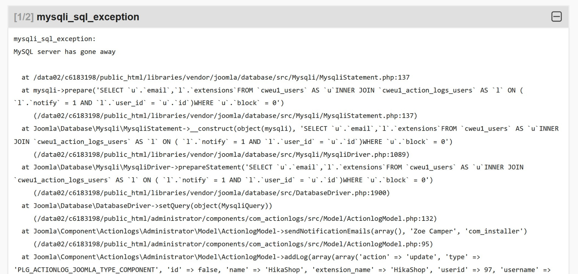

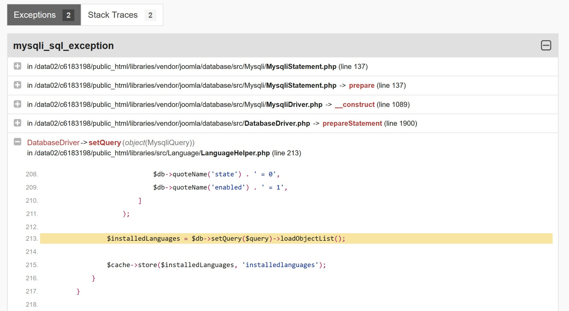

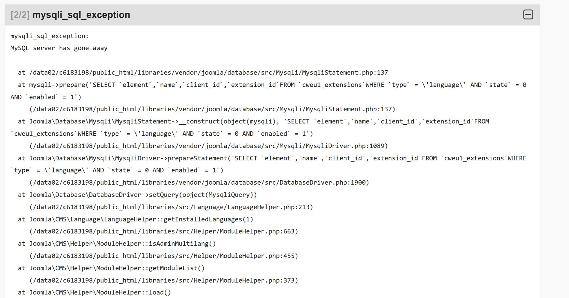

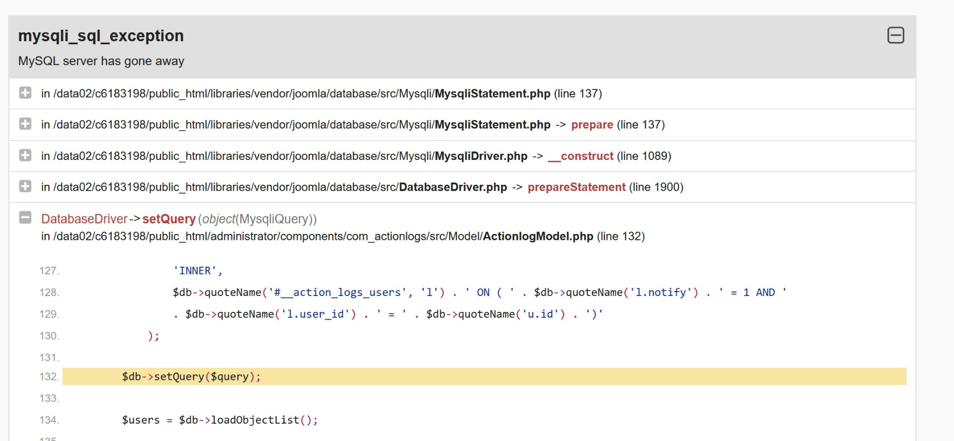

Having turned on debug, I have 2 exceptions and 2 Stack Traces when trying to update from 5.0.2 to 5.1.2. See screenshots.

The errors are not really coming from HikaShop or Joomla.
They come from your MySQL server.
forum.joomla.org/viewtopic.php?t=998983
joomla.stackexchange.com/questions/933/e...server-has-gone-away
I would recommend asking your hosting company support about it.
They should be able to tell you why this is happening, and potentially even fix it for you in some cases.
