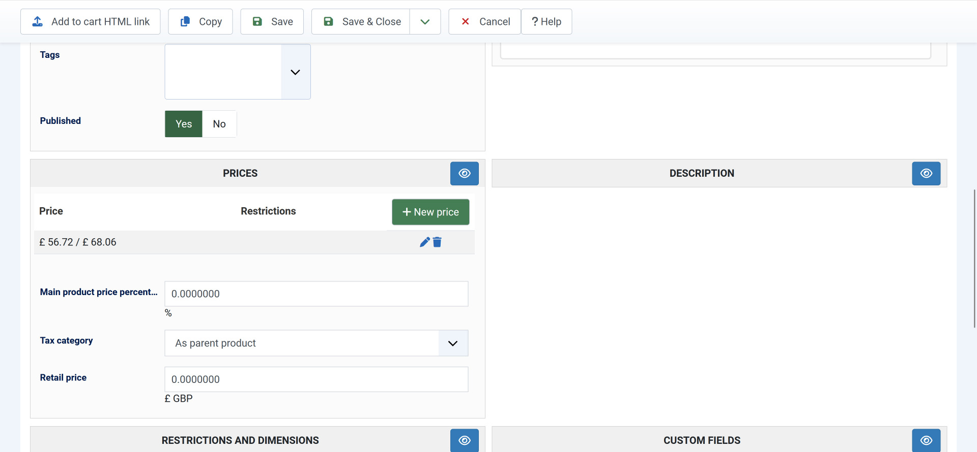

  • Posts: 107
1 year 9 months ago #364568
Hi Nicolas
What do you think causes this i have attached a photo for you to look at.
John

  • Posts: 107
1 year 9 months ago #364586
Hi Philip
Why i click on Variants and click on the edit button i can not see the Description part underthe word Description. I have tryed this on other browsers and its the same:(. Can some one please help me.

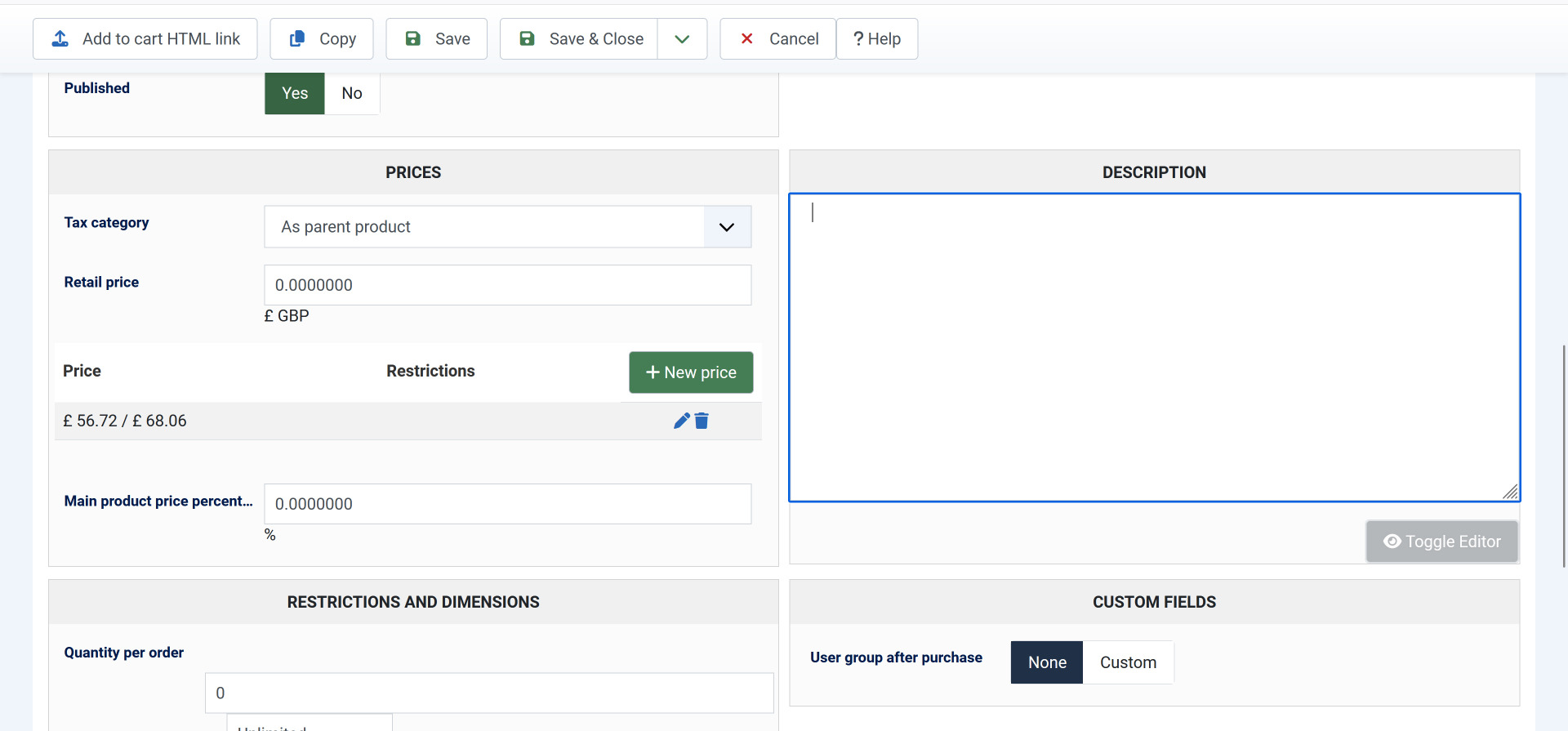

  • Posts: 107
1 year 9 months ago #364704
Hi Nicolas
Thanks for all your help but it did not work, :( I have attached a photo of what it look like now..
  • Posts: 86112
  • Thank you received: 14210
1 year 9 months ago #364713
I checked on your website and I can see what the problem is.
It's because TinyMCE is not able to activate itself when loaded in AJAX if it's not already somewhat loaded on the page.
So it would require extra, more complex, changes on the main product edit form view to preload tinyMCE on the main page.
So I've had to also add this code:
      <?php
      $editor = hikashop_get('helper.editor');
      $editor->setEditor('tinymce');
      $editor->display();
in product / form via Display>Views on your website for this to work. It's now working fine.
