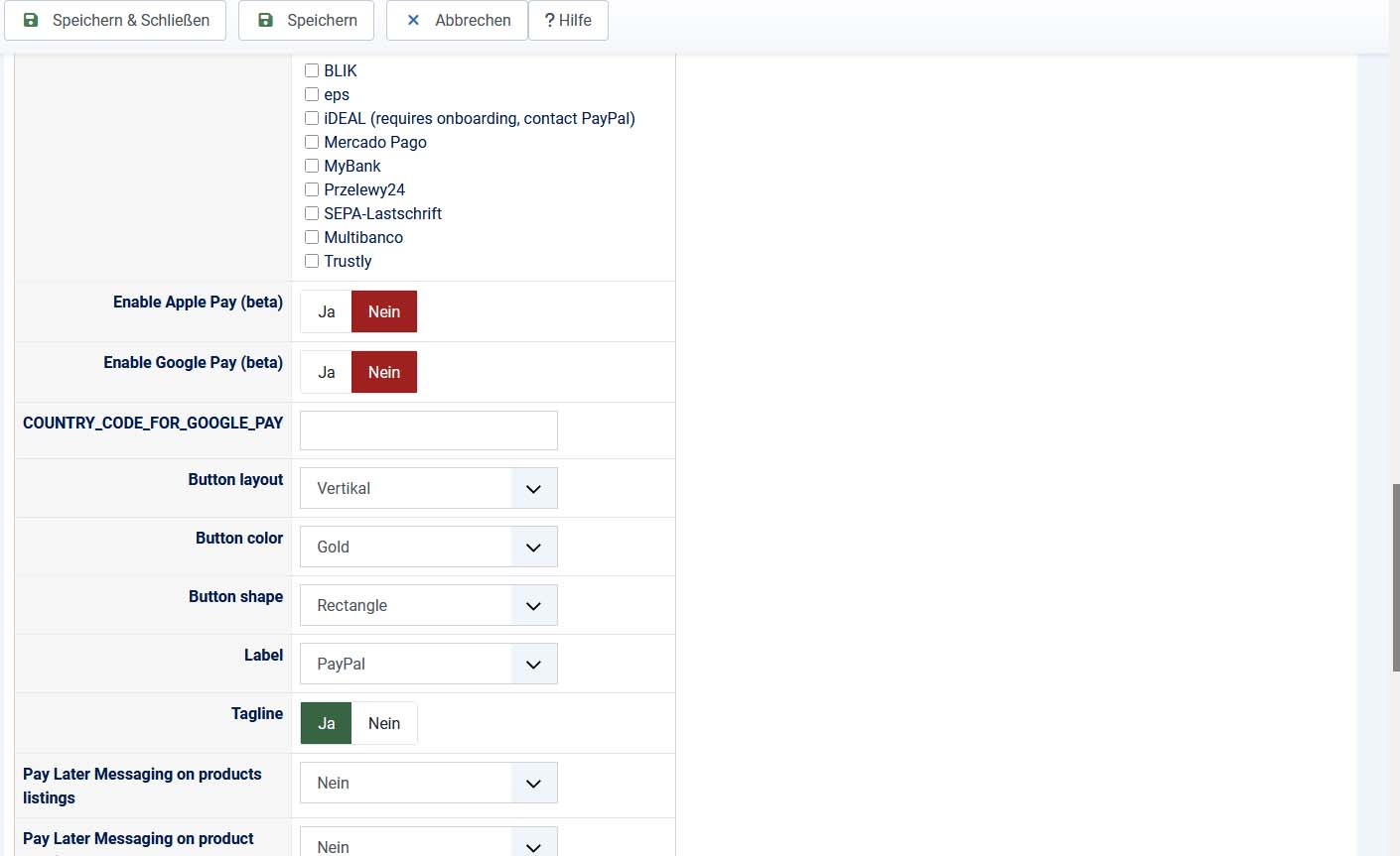

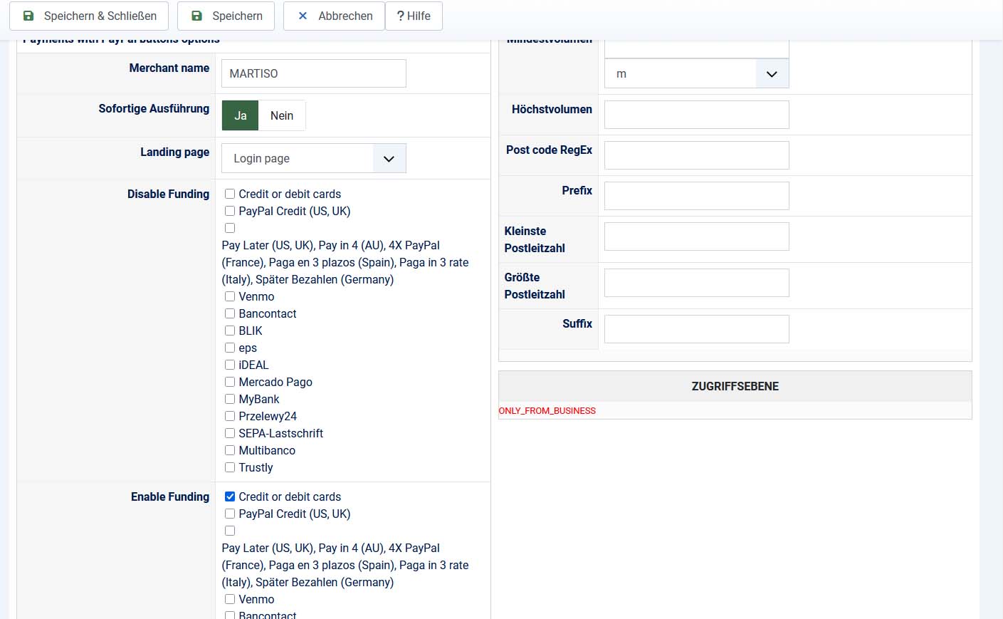

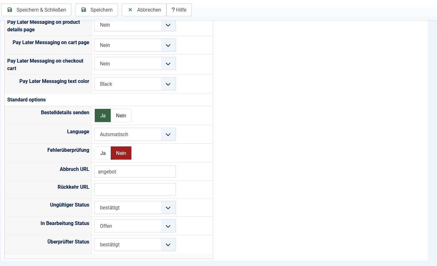

After restarting, the “client ID” and “client secret” are entered. When you want to complete the purchase, the selection page appears. If you select “PayPal” for example, the login page opens briefly. Then the message “The payment request was refused by PayPal. Please click here to return to the checkout” appears.

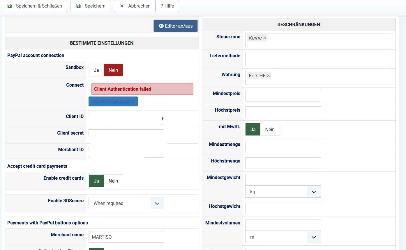

When I try to connect with “connect” in the backend, the PayPal page appears. After entering the code, the message “This page does not exist” appears.
When I enter “client ID” and “client secret” and “Merchant ID” and save, the message “Client Authentication failed” appears.

The message “Client Authentication failed” normally indicates that either the “client ID”, “client secret” or “Merchant ID” are incorrect.
It could just be a copy / paste issue. For example, if you have an extra space at the end of either fields it could lead to that problem.
So, please double check what you have there.
Between the 6.1.0 and the 6.1.1 we released a few days ago, we didn't change anything to the client authentication process, and the client authentication process worked fine in the 6.1.0 for everyone. And I confirm it still works fine on our test server with the 6.1.1.
So it's likely the problem comes from the information provided in these fields, or the "sandbox" setting should be activated if you're using sandbox credentials for the “client ID”, “client secret” and “Merchant ID” fields.
