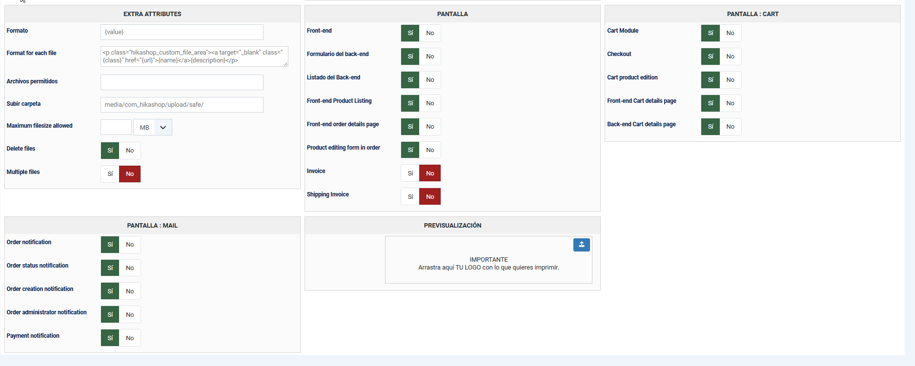

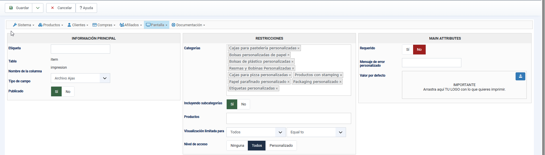

Can you please provide a screenshot of the settings of your custom field with the issue ?
  • Posts: 460
  • Thank you received: 19
9 months 2 weeks ago #369533
I’m attaching two screenshots of the custom field configuration.
