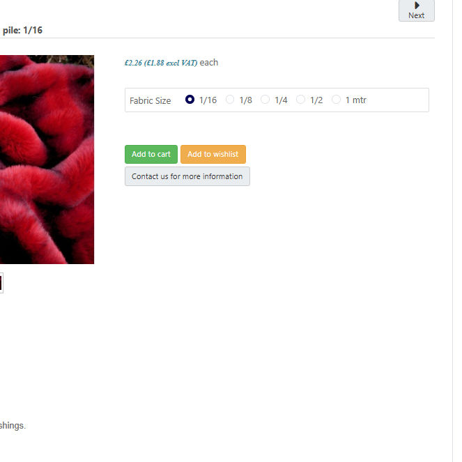

Hi, I have the same issue. It used to show?
All of what you suggested is on but nothing will show on the product page (cart only?)
thanks

6 months 2 weeks ago #370573
The "synchronized add to cart" setting should be turned off, not turned on. It's probably your problem.

6 months 2 weeks ago #370579
sorted:)
