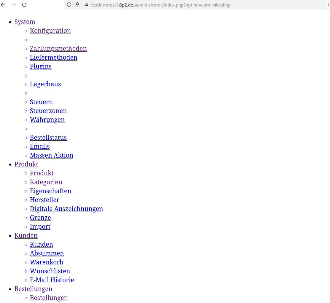

Thank you, the error is vanished. But I can't see a right Main Hika shop page. Please find an image attached. No further error messages on the screen only at the bottom:
Notice: Undefined variable: region in /homepages/12/d82533704/htdocs/backup/20260209_intranet/administrator/components/com_hikashop/views/dashboard/tmpl/map.php on line 74
Recoverable fatal error: Object of class stdClass could not be converted to string in /homepages/12/d82533704/htdocs/backup/20260209_intranet/administrator/components/com_hikashop/views/dashboard/tmpl/map.php on line 75
But I think that is not the reason for the view.

We found and fixed this issue too. The map widget template had a code structure problem following modifications in the last version of HikaShop. Please download the latest build of HikaShop 6.3.0 again and install it over your current version. This will apply both patches (for the SQL error and for these map widget errors).
