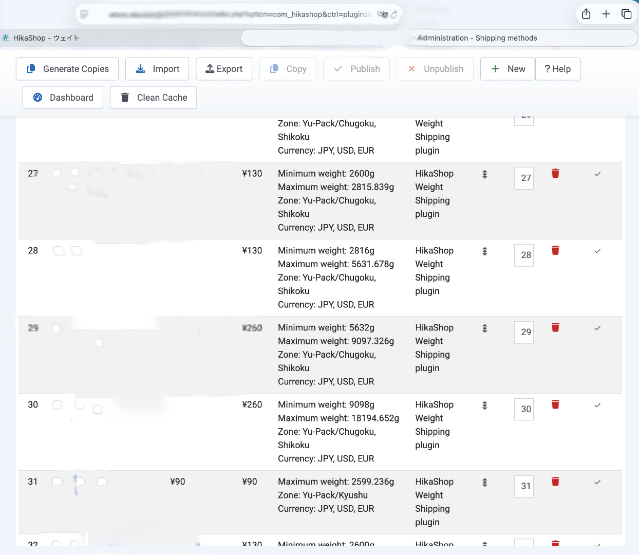

I am experiencing a critical issue with the "HikaShop Shipping Plugins - Weights" plugin. This is the only shipping method on my site, and it contains over 3,000 entries.
[Current Symptoms]
  1. When navigating to "System > Shipping methods," the list becomes blank (grey) after the 32nd entry, and everything beyond that is invisible.
  2. Since updating to HikaShop 6.4.0, this occurs immediately upon opening the page, regardless of display settings.
  3. In previous versions, the screen would go blank if I selected the default maximum display of "200." Therefore, I had been using the "100" setting as a workaround.
[Error Log Found]
I found the following warning in my server logs:
PHP Warning: PHP Request Startup: Input variables exceeded 1000. To increase the limit change max_input_vars in php.ini.
PHP Warning: PHP Request Startup: Multipart body parts limit exceeded 1020. To increase the limit change max_multipart_body_parts in php.ini.
[Steps Taken]
I increased the limits in my php.ini as follows, and confirmed they are active via phpinfo(), but the issue persists:
  1. max_input_vars = 10000
  2. max_multipart_body_parts = 10000
(Note: My memory_limit is set to 2G)
Could you please provide a fix or a workaround for managing such a large volume of shipping data in version 6.4.0?

Thank you for the detailed information and screenshot. We found the issue.
In version 6.4.0, we removed the pagination from the shipping methods listing page to fix a display issue with single-instance plugins. As a result, all shipping methods were loaded at once. With your Weights plugin instances, with thousands of rate entries, loading all their configuration data simultaneously was consuming too much memory and exceeding PHP memory limits.
We have restored the pagination on the shipping and payment methods listing pages. The single-instance plugins are now properly included in the paginated total and displayed at the end of the list so that the pagination can still work while taking them into account.
You can download the latest update from your member area and install it over your current version. After updating, the shipping methods listing should load normally again with pagination controls at the bottom of the page.
