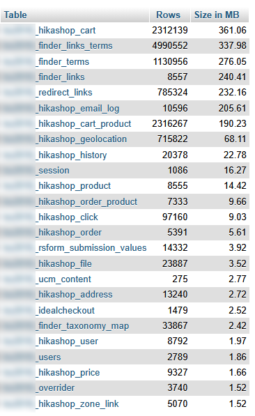

Thank you fro your reply. As you suggested, I have done a database query for the number of rows and size in MB for each table in my database. I have attached a screenshot of the largest ones. I am not sure what to make of this and what I could do to reduce the size of some tables (if even possible). You were right that the products don't appear to be the problem. As you can see from the screenshot the largest tables are related to the cart, finder, links and email.

You have 500 MB of data for carts, with 2.3 millions carts in the database. Most of them must be spam, the rest, too old. Probably only a few dozen is even relevant. We implemented improvments recently against these, but these must be from before.
Empty the hikashop_cart and hikashop_cart_product tables to fix this.
You also have 900MB of data from the Joomla Smart Search. You can try to clear the index and try to reindex the search in the Smart Search component. Also, in the HikaShop Smart search plugin, there is a setting to index variants. Check that this is turned off before reindexing the data. That should eat a lot less memory.
You also have 100MB of emails, for a total of a bit more than 10K emails logged. I would recommend clearing the hikashop_email_log table and making sure the plugin is properly configured, as I was saying in my previous message.
The product and variant data is only 50MB in total. You can ignore it, that's not your problem, as I was expecting.

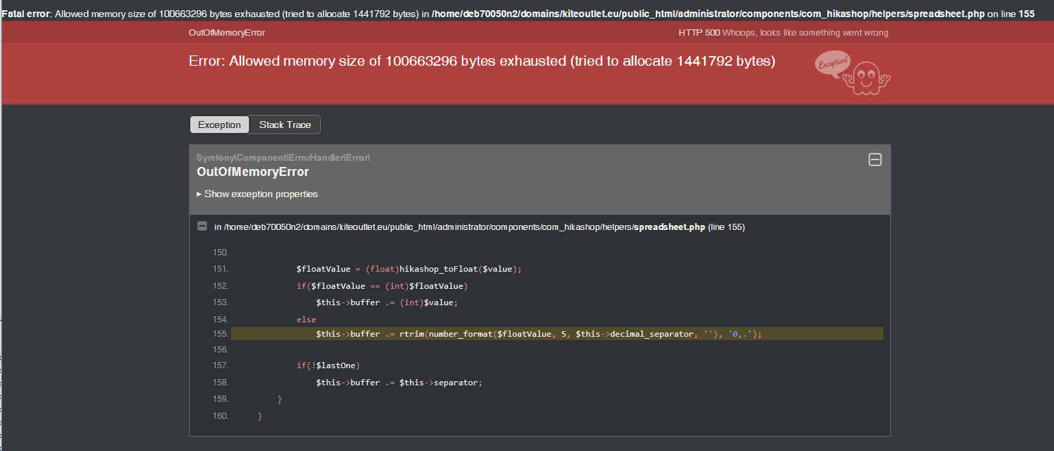

However, I am still running into an error when I try to export my products from Hikashop. I thought this was connected with the database size issue, but since the error still persists, I think it may have another cause.
When I try to export a CSV file of all my current products (Hikashop -> Products -> Export), I get a 500 server error. (See attached image.) The most recent export of my products is a few months old and I could run the export without issues then. Do you have any insight in what could be causing this issue?

I would recommend increasing the memory_limit of your php.ini to 256MB
